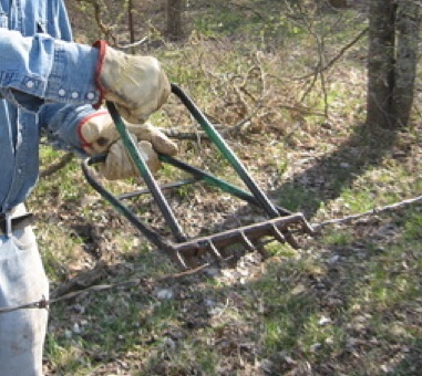

We had a 8-12 inch wide fence tightner on the farm. The tool would open up to fit over the fence and would crimp the wire which did a good job of tightening the wire. It might take a few crimps to get the tension back but it was fast and easy to do.

That is the type tool I mentioned. I haven't been able to find one.

I think I saw an ad for the one pictured in Farm Show decades ago. I didn't think it would be very effective because when I used to crimp slack wire with a claw hammer, the crimps mostly straightened back out. Your enthusiasm for the crimper makes me think I might have been mistaken. I attempted to contact the lady who writes the blog and ask her where her husband got his. If I find out,, I'll pipe up.
