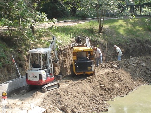

Yesterday started off with me wanting to drill the piers where the wall's continuing along the bank.
There was a problem.
The tailings or dirt scraped down for the wall wasn't packed.
Evidently Iris (skid steer so dear) ticked the tailings off and they refused to support her in our endeavor.
Visions of being upside down in a pond in a skid steer made me a lot more cautious than normal.
I went in immediately with the mini hoe to have a discussion with the misbehaving tailings.

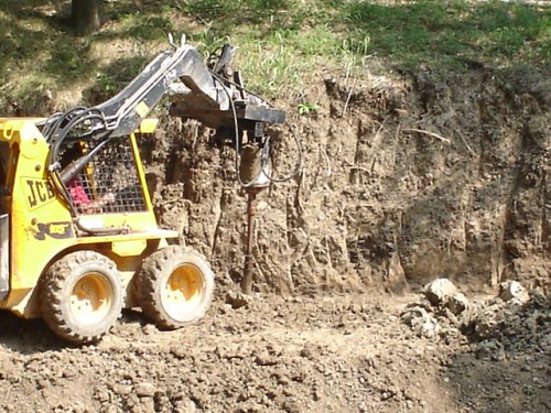

It just shows to go that a little discussion works, even on dirt.
We're using a sixteen inch auger and going down eight to ten feet. (The variance comes from angle of attack. Straight on I can go down ten. At some angles we'll only get eight.)
Notice where the right rear wheel of Iris is sitting. She does like to live dangerously, bad girl.

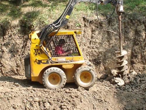

We went fishing for a hole and came up with dirt. Go figure.

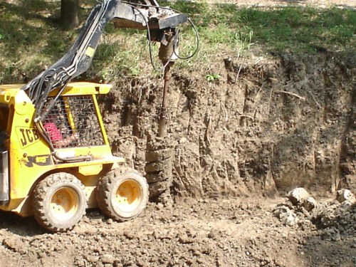

We shook it off so we could try again. We're optomists.
