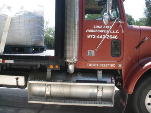

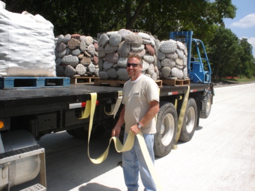

He brought us four baskets, about twenty five hundred pounds a basket.
They were all prettier than the next.
I know, some don't think rocks are pretty. But they're the ones that need Levitra while all we need is la see tra. /forums/images/graemlins/blush.gif
Tom is the one along with his wife Michelle and son TJ that supplied all the rocks for the memory stones. They did it at no cost to us.
So here's a shameless plug.
Just for them.

Here's Tom ducking from internet exposure.
If we were closer to the lake I'd call him a dam ham. /forums/images/graemlins/grin.gif

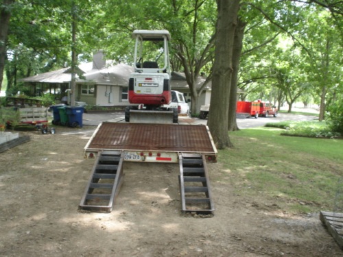

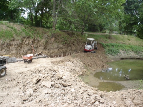

I went down to Nation's Rent and picked up this little baby after lunch. Check out the width of it's tracks fully expanded and the pattern of my ramps as close as they can get.
Yup, we call loading and unloading that baby pucker string exercising one oh one. /forums/images/graemlins/grin.gif

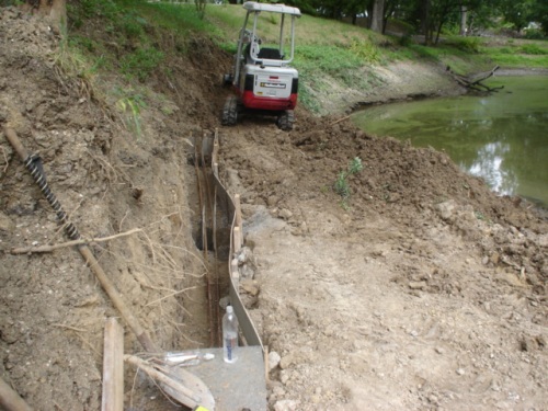

This is a shot of the footing and two of our piers we're putting in every ten feet of beam.

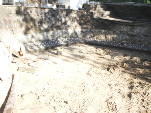

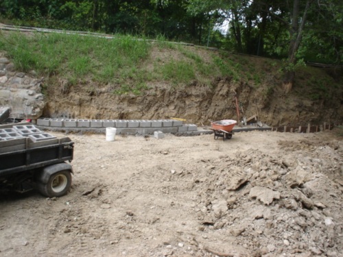

We're laying a base course of twelve inch Halite (cinder) blocks on the beam. Above that we'll go with eight inchers so we have a four inch ledge to place our stone facia.

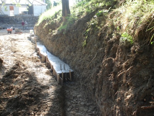

This is what yesterday's work looked like in the light of day and without it's forms.
