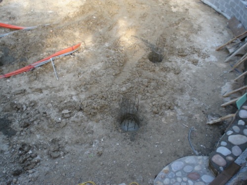

We formed up the pathway that's going to run along the south end of the existing wall. If you click on the link I replied to you will see the area as we left it Monday.
This is what it looked like tonight when we left it.

Those are four of the five piers that will be holding the floating boulders.
Sixteen inch hole nine feet deep with half of a yard of concrete to get it to the level where we can route the tubing and conduit for boulder enhancing one oh one.

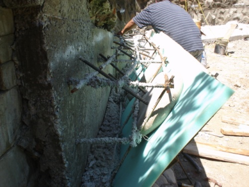

I'm not sure how this picture will download. I hope it's clear enough for those interested to see how we're installing the flat boulders into the concrete.
First we drill the boulder and epoxy in a piece of rebar. Then we tie the rebar to the rebar grid that reinforces the concrete.
Next we lay dense foam against the boulder and then put a masonite fibreboard to act as the form for the concrete.
We follow that with stuff like little rocks and sand to further form the foam around the rock. This saves us time and effort cleaning up when we remove the forms and it means less detail work with the mortar work afterwards too.
I know. Pros would do it different.

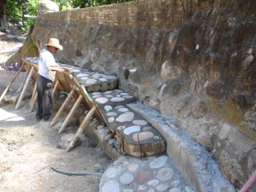

Probably one of the most rewarding things about this kind of work is watching one of my ideas become the property of someone who takes it further and better than I ever could.
This is a classic example of what I'm talking about.
Vicente is a day laborer, forty nine years old. He started with us on this job as just a day laborer. It turns out he's done a lot of concrete and masonary work in his life.
It's the nature of these kinds of workplace for expertise to be downplayed in these situations. But I think a little of my enthusiasm and the challenge of the job got him down where it feels good. He's having more fun than a pup with two tails on a sunny day taking my concepts and turning them into works of art.
I'm having as much fun watching him have fun as I am seeing things happen the way I think they could most likely.
I showed him once basically what I wanted. Then I got out of his way.
Sharing the fun is all about sharing fun.
