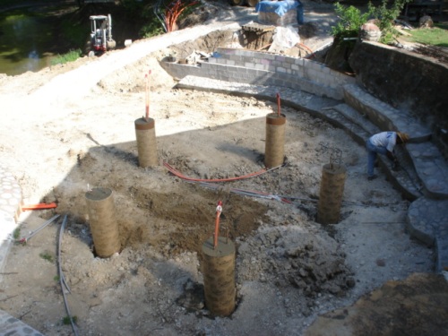

Yesterday we found out our boulders that were supposed to have arrived a week and a half ago won't actually get here until Wednesday.
I wanted to see the boulders before I poured the columns. Second choice was going to another stone yard and checking theirs out. That's what I did. After seeing and touching twelve to fifteen hundred pound boulders I knew what I wanted for column height.
Yesterday we got the columns poured.

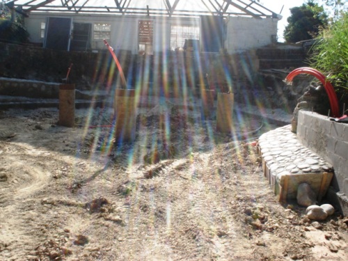

We also got the last section of the transition poured.
It was a good day. We mixed and poured a little over three yards. A lot of work for old men. /forums/images/graemlins/grin.gif

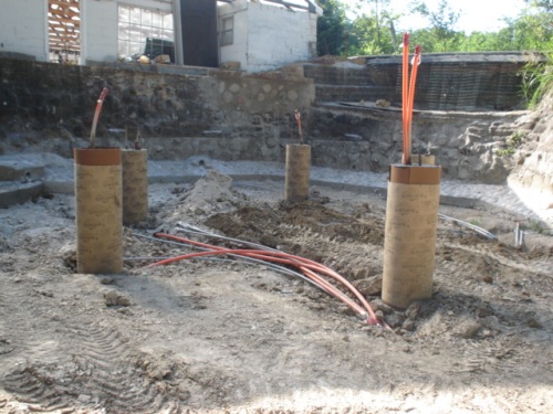

We've had a lot of good luck this job.
If it continues today we'll pour the lights for the columns and their stones and do final grade. And hopefully we'll get all the iron tied in.
I've been soliciting help amongst some younger guys I know who need some extra money and claim to want to do a day's work for a day's pay. I've told them we'll need some help mixing and pouring fifty mixer loads to do the floor tomorrow.
I didn't want to scare them off. I figure it'll take somwhere between sixty and seventy. /forums/images/graemlins/crazy.gif

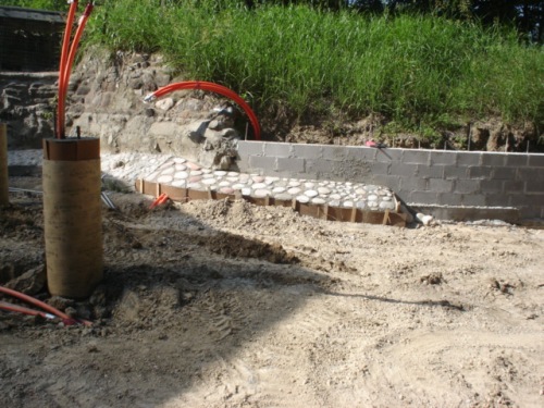

It is coming together.
