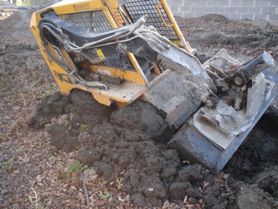

And yes, I've probably been stuck more often than anyone else on TBN. /forums/images/graemlins/blush.gif

</font><font color="blue" class="small">( And yes, I've probably been stuck more often than anyone else on TBN. /forums/images/graemlins/blush.gif )</font>
Harvey, lately I've been trying to dig out some of the silt in one of my ponds and I've been stuck more times than I care to admit. My definition of "stuck" is when the front wheels drop down in soft mud and I have to dump my FEL and use it to get unstuck. I haven't had to give away any pictures of dead presidents, but the pictures of Iris wallowing in the mud look awfully familiar. It just goes with the territory. The only way to prevent it is to leave the tractor in the barn. /forums/images/graemlins/smirk.gif

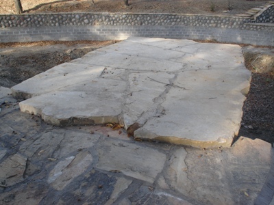

I guess I'd better update everything.
We're done on the pond for now. We'll continue where we've left off next spring.
We sent the guys home each with a DVD with about thirty two hundred pictures between mine and the client's.
Here's some a picture of the finished rock deck.

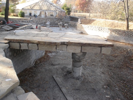

Of course we didn't want the beams to show so our deck got herself a skirt.
   / Keeping character, or restoring a pond
#517

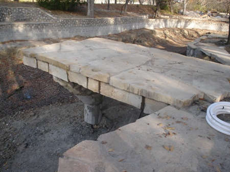

Here's another shot of the rock deck with her skirt in place.
The way we did it was we drilled through the skirt stones and then up through the deck. The holes were countersunk and we used all thread. After we grouted in the holes it's hard to figure out what we did.
I like that hard to figure part best I believe.

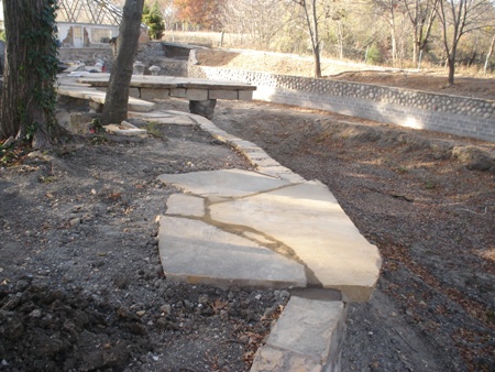

#518
It's as solid as the slab to walk out on. And the look while not a finished one, fits the rest of the construction I believe.
Hanging those puppies was interesting, not fun, not easy, but interesting.

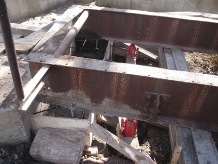

We needed to raise the forty foot bridge one foot.
It was only eighteen inch I beam so it wasn't a big thing, but still a thing.
The first thing was to jack it up.

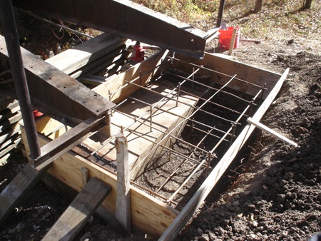

#520
At the other end we decided to add some concrete, just cause, you know cause, cause we could and we felt we should.
