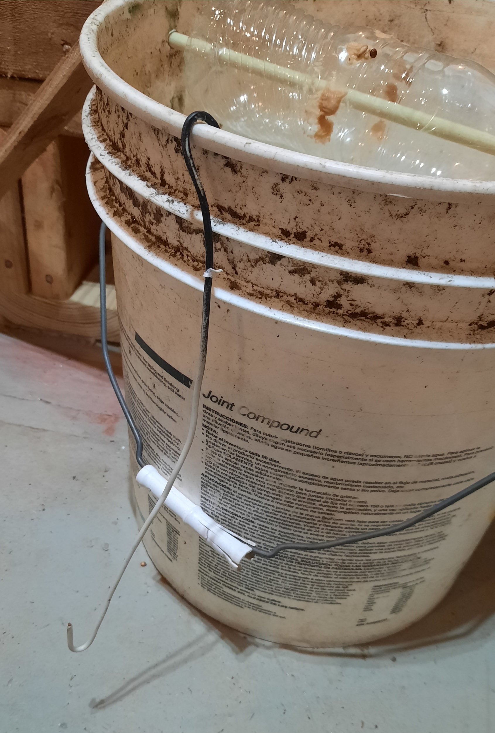

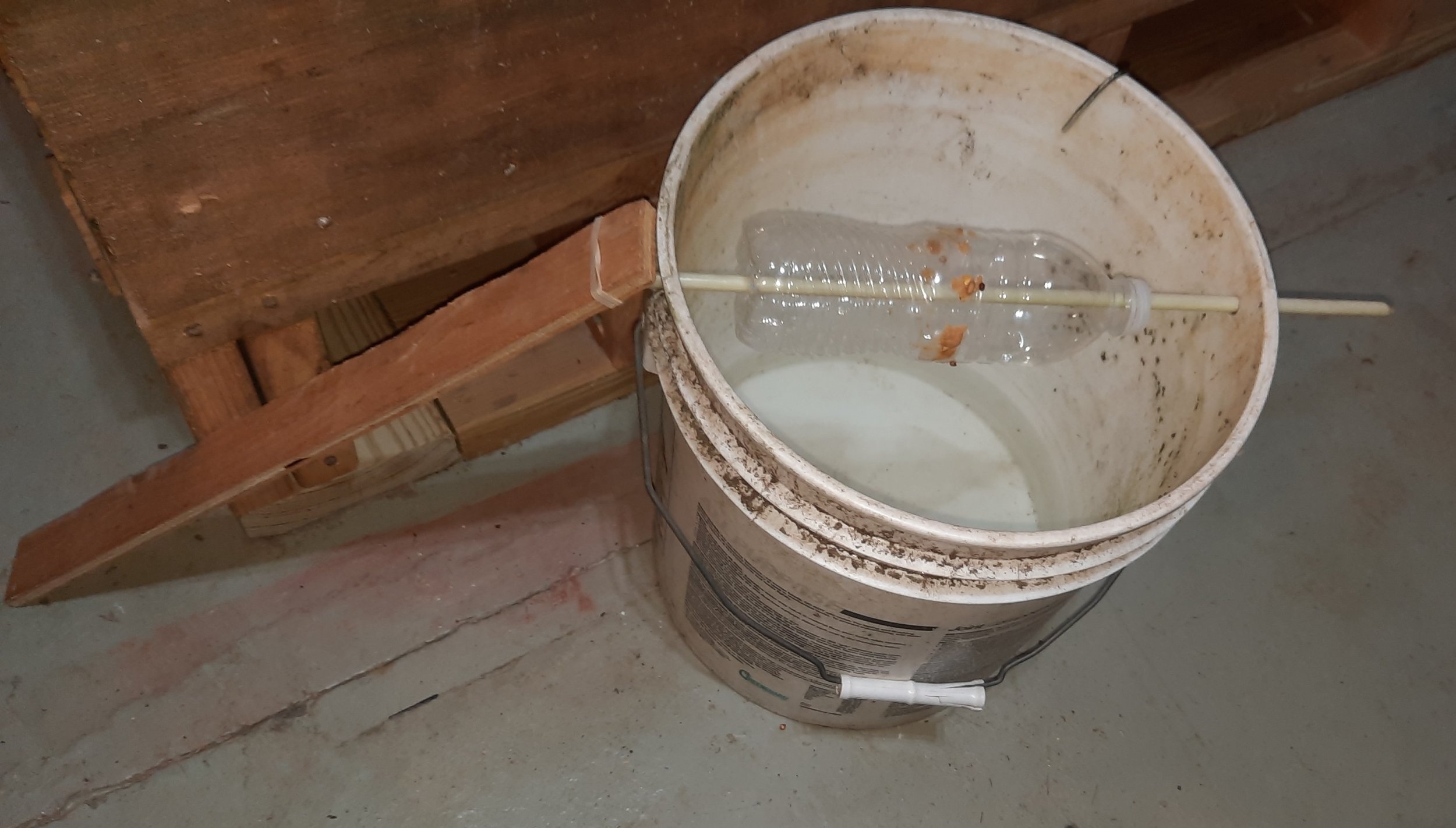

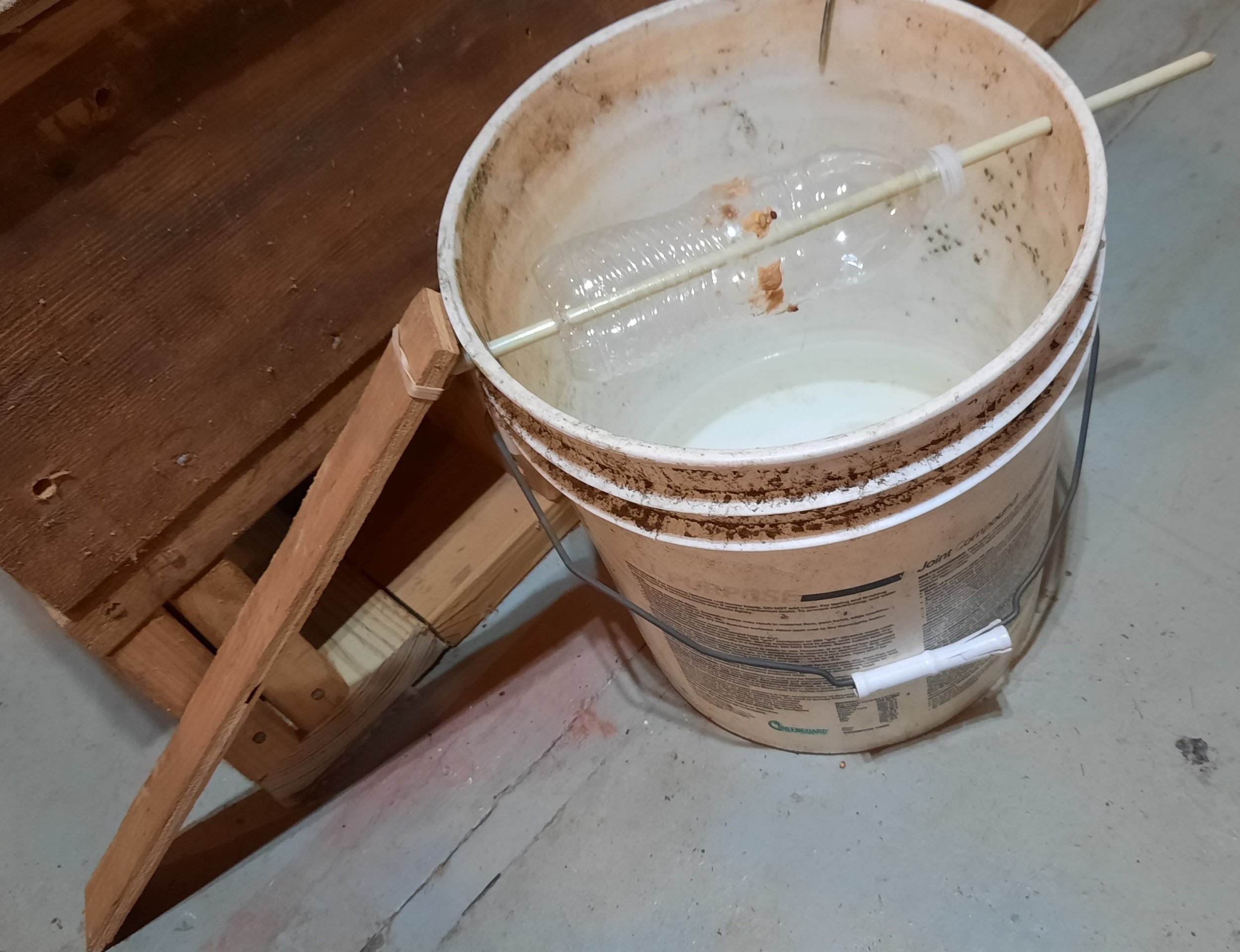

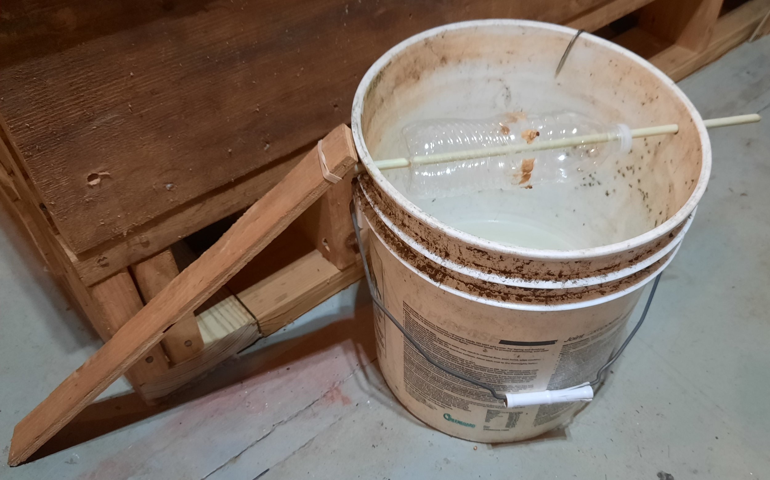

Been using bucket traps for years, but stopped floating birdseed a long time ago. The seed doesn't float for long & the bucket get nasty after a few catches... (bird seed gets expensive) & I find it is not needed.
Been making these for years & they work great: (& cost me basically nothing)
(1) 4.5 - 5 gal bucket, I usually get them from a construction site for free. Two small holes drilled at the top across from each other big enough for the dowel listed below
(1) small wooden dowel; I've actually been using fiberglass driveway markers I get for free from a plowing / landscaping company when they have damaged ones. Just cut it long enough to be 2 -3" wider than the bucket you using.
(1) Plastic Water Bottle with cap - drill holes in the bottom & the cap just slightly larger than the dowel above.
(1) Scrap piece of wood for the ramp (usually a piece of scrap plywood)
(1) Rubber Band - to hold the ramp, so they don't knock it off
View attachment 848783 View attachment 848784 View attachment 848785
Basically after it is assembled I add very small amounts (dabs) of peanut butter to the center of the bottle & stick a few bird seeds to the peanut butter... (sometimes I will put a small smear of peanut butter on the inside of the bucket opposite ramp).
Add the water (I will use the RV non-toxic antifreeze in cold months) to the bucket & it done. They never get the peanut butter or the seed before dropping in.
The only thing to make sure during assembly is the water bottle spin super freely....
Oh & I hang a piece of scrap wire on the side of the bucket to pull the mice out of the bucket... save me from always dumping the bucket.
Thanks for the pictures, love the idea of the dowel and not using much seed. The hanger is a game changer! ☮️✌🏻
