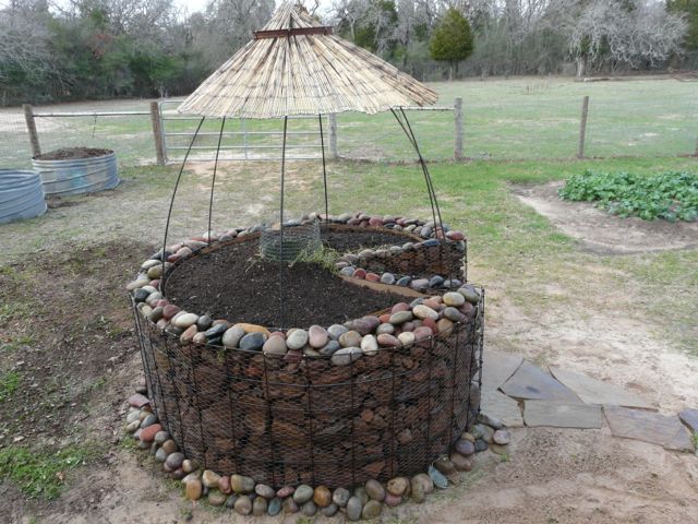

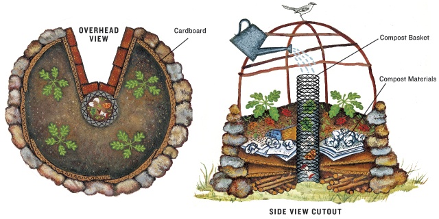

I'm going to build a keyhole garden. It is basically a (6') round (3') raised bed garden with access to the middle (shaped like a keyhole) where compost is deposited which feeds the plants as it decomposes. Does anyone have one and if so how is it working out?

So what do you do when the center basket fills up? Is this something you dig out each year and start over?
/ Keyhole Garden
Good Question. Since you water from the center, I would think as the center decomposes it turns to soil and runs out. But at some time I also think it will fill up. I'll find out. I'll make the center basket wide enough to get a shovel in it.

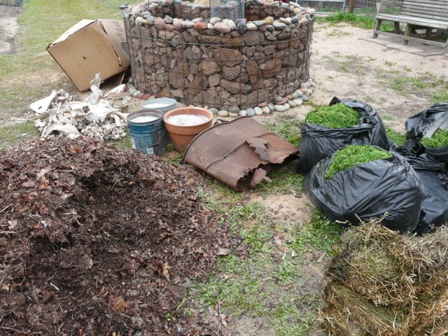

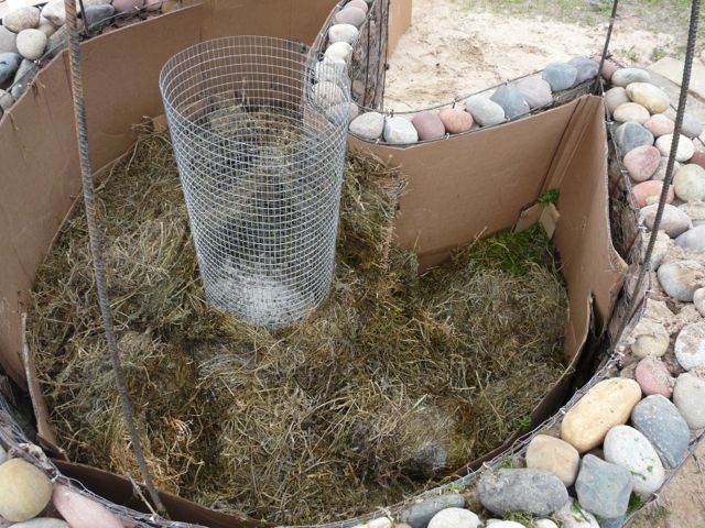

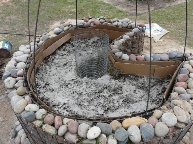

I finally gathered all the ingredients for the Keyhole Garden: bones of two cows, ash from one brush pile, aged dried poop from a dozen cows, five bags of clover, a pile of forest floor mulch, cardboard, rusty items, and 15 buckets of two year old compost. I layer them according to directions and it is ready to add seeds/plants in a about a month.

Dragging out and old thread; how'd this work out for you Don?
It worked good - except
I should have put mortar in-between the rocks.
Sooooo
I took the entire keyhole garden apart, poured a circular slab and re-set each rock in mortar. It retains moister better and the soil does not leak out in-between the rocks. We have been putting veggie scraps in the center for two years and still have a foot to go before it is full. It just keeps on composting away….
