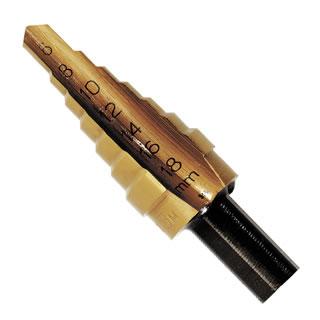

If the hole diameter is greater than the material thickness,,, simply use a step drill bit,,,
This drill never has a problem with thin materials,, either type chuck will be successful.
The best part is that after the hole is drilled, simply run the drill in from the opposite side,,, the hole will be deburred!! :thumbsup:
