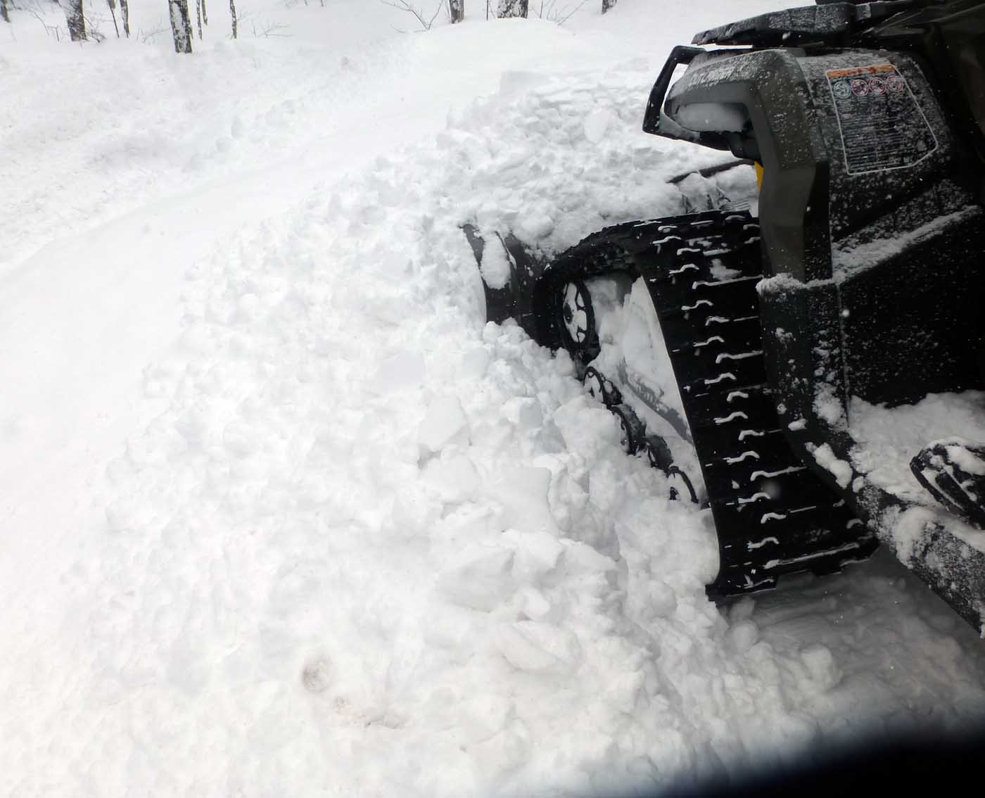

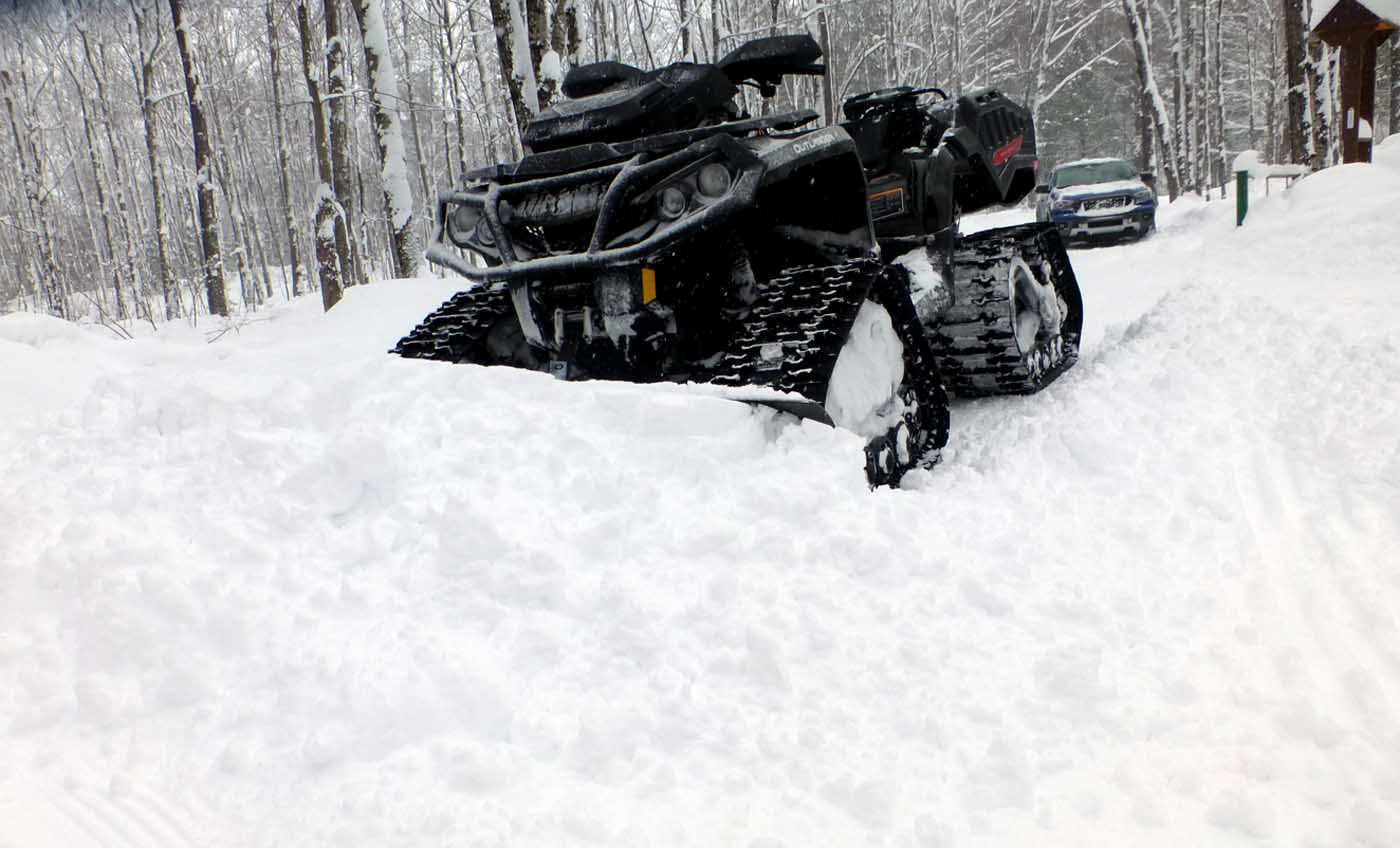

I just got back from plowing a foot of snow off our ski trails parking lot. That 5/8 gravity pin is a keeper! And I tried to pay attention to the HP or throttle I was using to push the snow off. I barly was above the RPM to engage the clutch. Pushing snow just doesn't take much.
Self engineered repairs that actually work no matter how butchered they look are gratifying for me anyway.

I hope you're not tripping it by pushing into a pile of snow.
   / KFI plow updates #57
How often was the blade tripped today?
You usually plow with blade angled or straight? For me anyway it's 95+% the time plowing it's angled.

Ok I'm fortunate I have long straight runs, I do feel having it angled is easier on plow and the machine pushing it. Glad to hear it's working for you.

Almost everything here is on a hill sides and snow does like to go that anyways :) .... From today. I might update my pin a bit but I am finnaly happy with this plow setup. (y)
