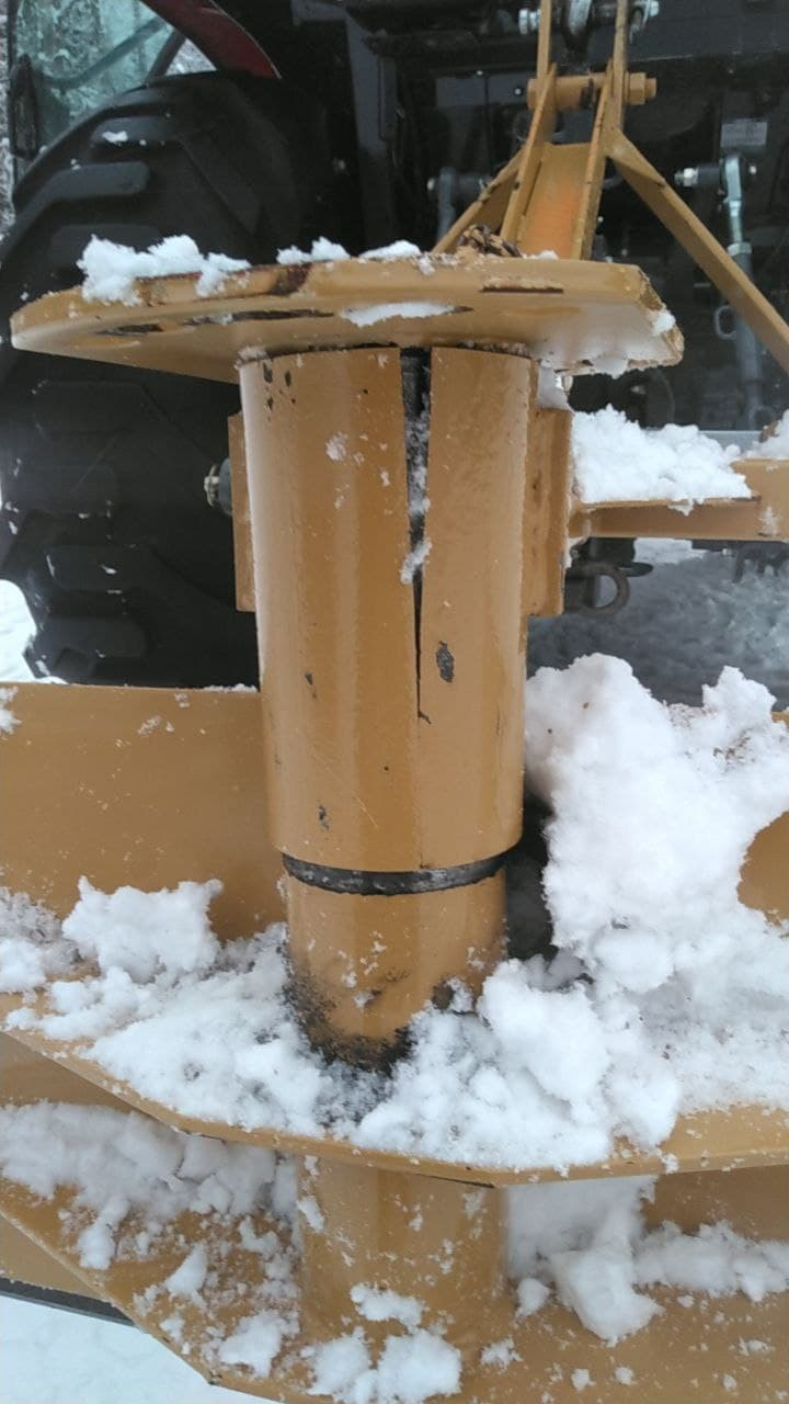

Split right on the seam of the pipe. I would have thought this seam would have been facing 180 degrees from where they installed it. Weakest part of the pipe in the highest stress area of the mount. No warranty of course. Going to take it to a local welding shop and have them re-enforce it a bit.

That is surprising. And what an inconvenient time for it to happen.
That looks *a lot* like the mount and pivot on my KK landscape rake. You'd think they'd beef up the same mount to put on a blade. You'd exert much more force on that mount with your blade than I would with my rake.

Looks like it should be reasonably easy to fix and reinforce, maybe add a grease fitting

You would think the bottom would of broke out instead of the top if you were pulling the blade. When I first looked at it, it reminded me of a freeze break...if water was in it and it froze.
   / King Kutter 72" Rear Blade broken. :-( #7
I'd fix that defect myself and add a grease fitting too. King Cutter implements aren't what I consider heavy duty in the first place and their welding certainly is sub standard. Their welds look similar to welds on Recreational Vehicles. RV welders are mostly Fast Food restaurant transplants.
Actually, the greatest stress is at the top of the post, not at the bottom. Whatever force is applied at the bottom has the advantage of 18-inch or so lever arm when it tries to break the top.

You more than likely broke it with the moldboard reversed and pushing backwards.

Also it doesn't seem that the damage was allowed by any defective welding on the part of King Kutter. The split tube was more than likely seam welded at the tubing mill. It's possible that it is (was) DOM tubing that would not have a seam but unlikely because DOM (Drawn Over Mandrel) tubing is very expensive compared to welded seam tubing.
You can see the seam in his pic. It split the seam.
