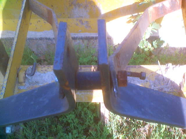

and
   / KingKutter BoxBlade, Never Again... #22
And here you can see the 1/2" bars are bent from using it as a ram I might straighten them before I use it again

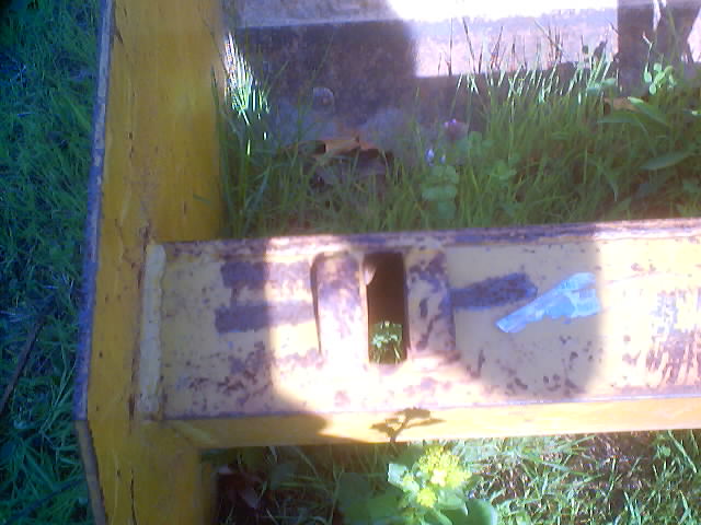

#23
The box section has rectangular holes on the top and bottom for each tine, however, the wall thickness on the box section is only 1/4". It will be 7/16" when I get done with it. The box itself is about 3" tall and 4" wide.

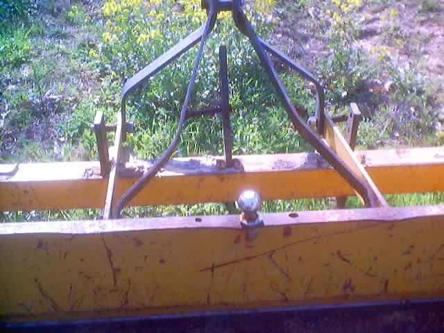

   / KingKutter BoxBlade, Never Again... #24
and the ball mount I use to move my trailers with
#25
Your box looks to be made of welded plate. Mine is a rolled/seemed tube.

Lazy
Looking at your pictures it looks like the steel used for the box is much thinner than 1/2". Isn't it the same thinkness as the metal that is bent out to hold the tine retaining pins? Or is more metal welded onin the inside that is not visible. Your box is built the same way my Landpride is and the point that eventually goes is the unreinforced part of the box where the tine touches on the upper side.
Andy
   / KingKutter BoxBlade, Never Again... #30
Hi I will measure it tomorrow, but I have abused it more time than I can count and I don't see any wear to speak of in that area.
Charlie
