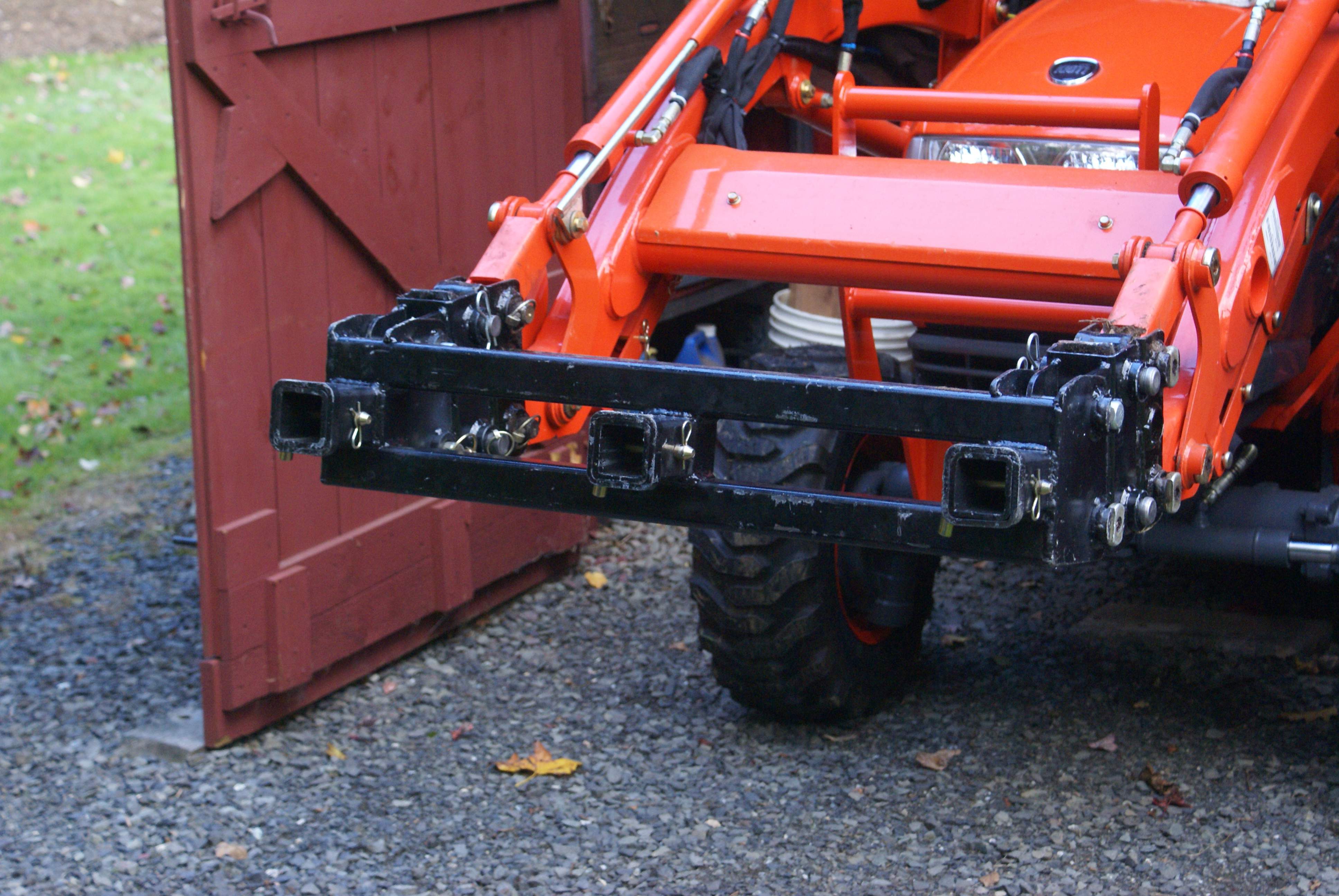

Found a picture of receiver bar. It has a lot of pins because it was modified to fit my Pin on QA
   / Kioti Bucket Reinforcement #12
Gil Case, setup looks pretty solid, why 3 receivers?
   / Kioti Bucket Reinforcement #13
Well, three receivers seemed logical, one on each side and one in the middle. However I had a wild idea about using a 3pt hitch implement in the front of the tractor (set out several feet) to drag some weeds out of a pond. Someone fortunately talked me out of it----so far. However, the receiver hitch set up does allow me to use various inserts, D-Ring, ball, chain hook etc.
