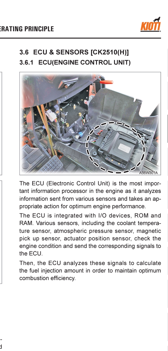

#12
Model is CK2510H
Image shows you the control unit minted on this model. I have the workshop manual. So far I inspected from the startup key to relay (blue box) and all is fine.

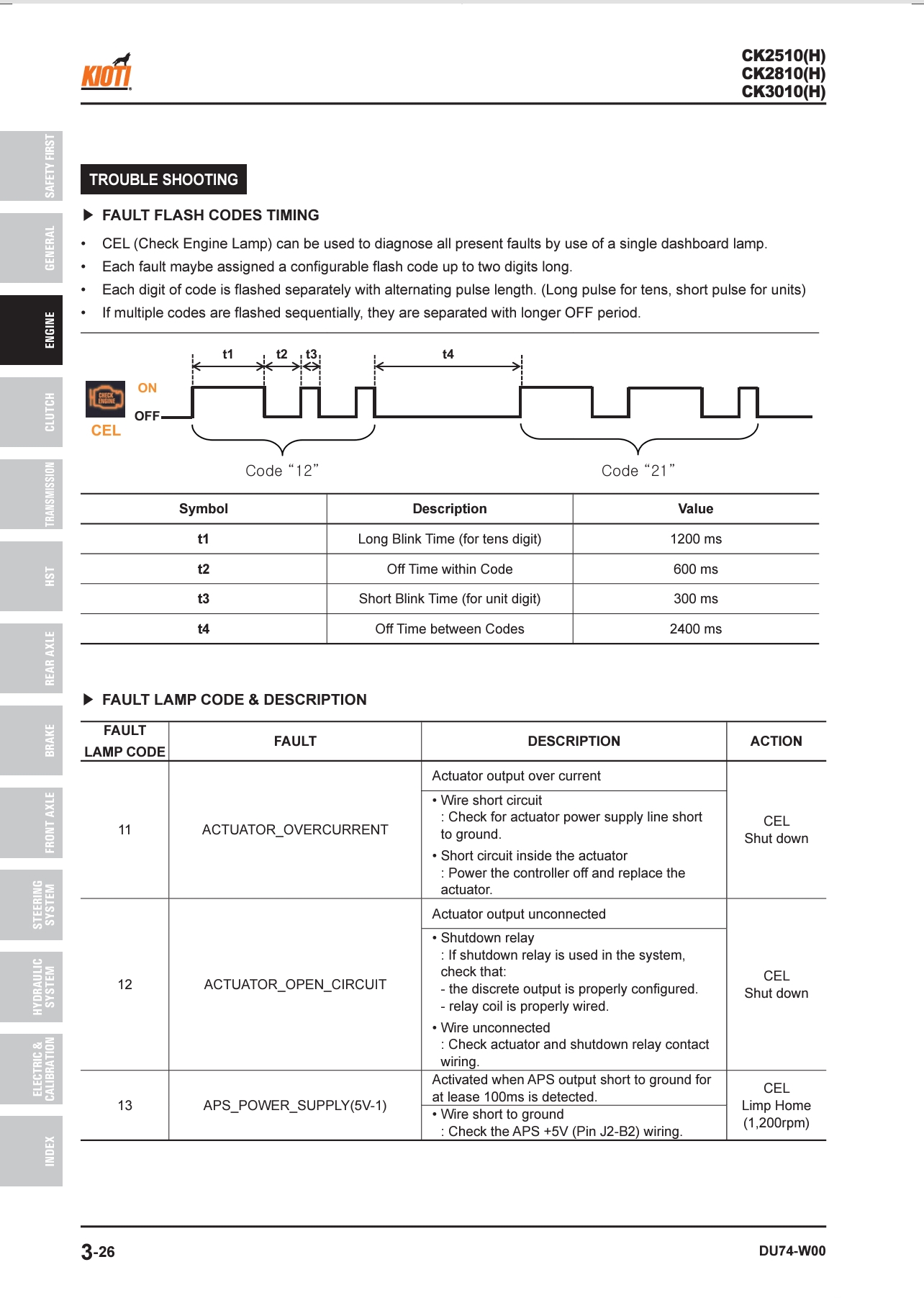

all alarms I guess are managed by the ECU unit , error 22 (see image ).
I actually submitted time ago the issue to all dealers here in Quebec City; they said they would have checked but no feedback. What’s new. So I wrote to Kioti to raise the concern of the customer service and the code 22.

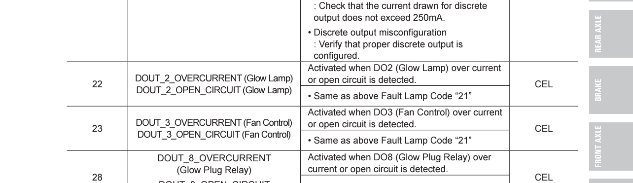

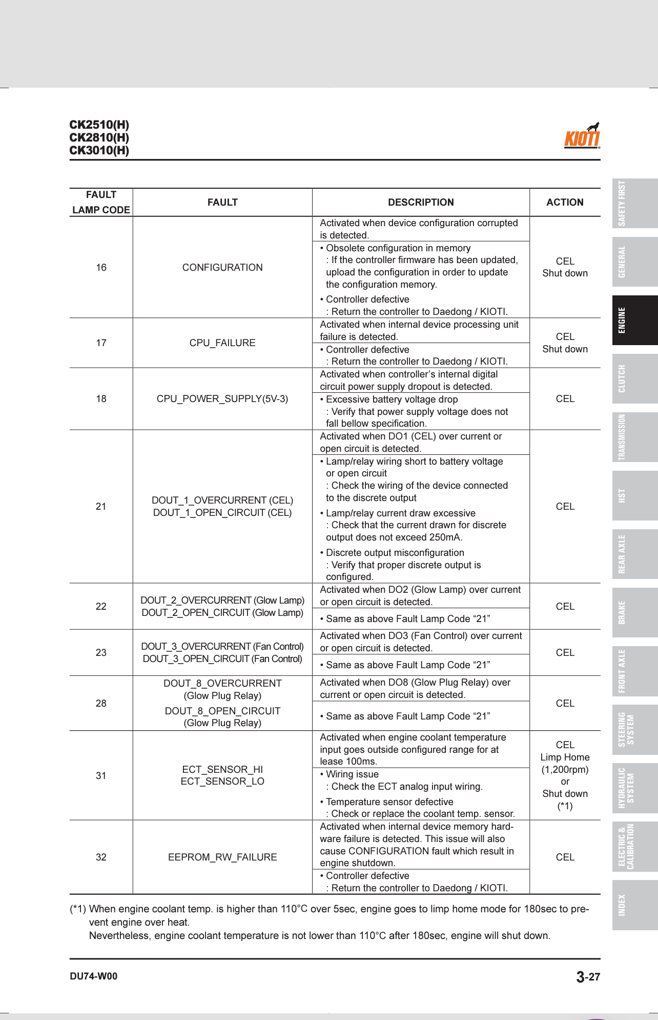

Thank you for confirming you have an ECM and posting the code description.
22 - "Activated when DO2 (Glow Lamp) over current or open circuit is detected"
That description really does makes it seem like the lamp itself is the problem, as I joked earlier. Does your Glow Lamp turn on for a few seconds after turning the key to 'On/Run' like normal?
*Same as above Fault Lamp Code '21'
What does 'Code 21' say?

Model is CK2510H
Oh that makes sense. Thanks for the info.

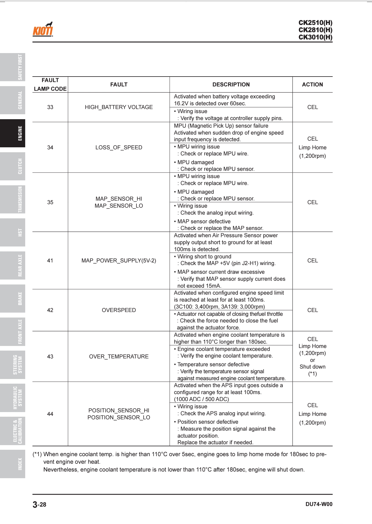

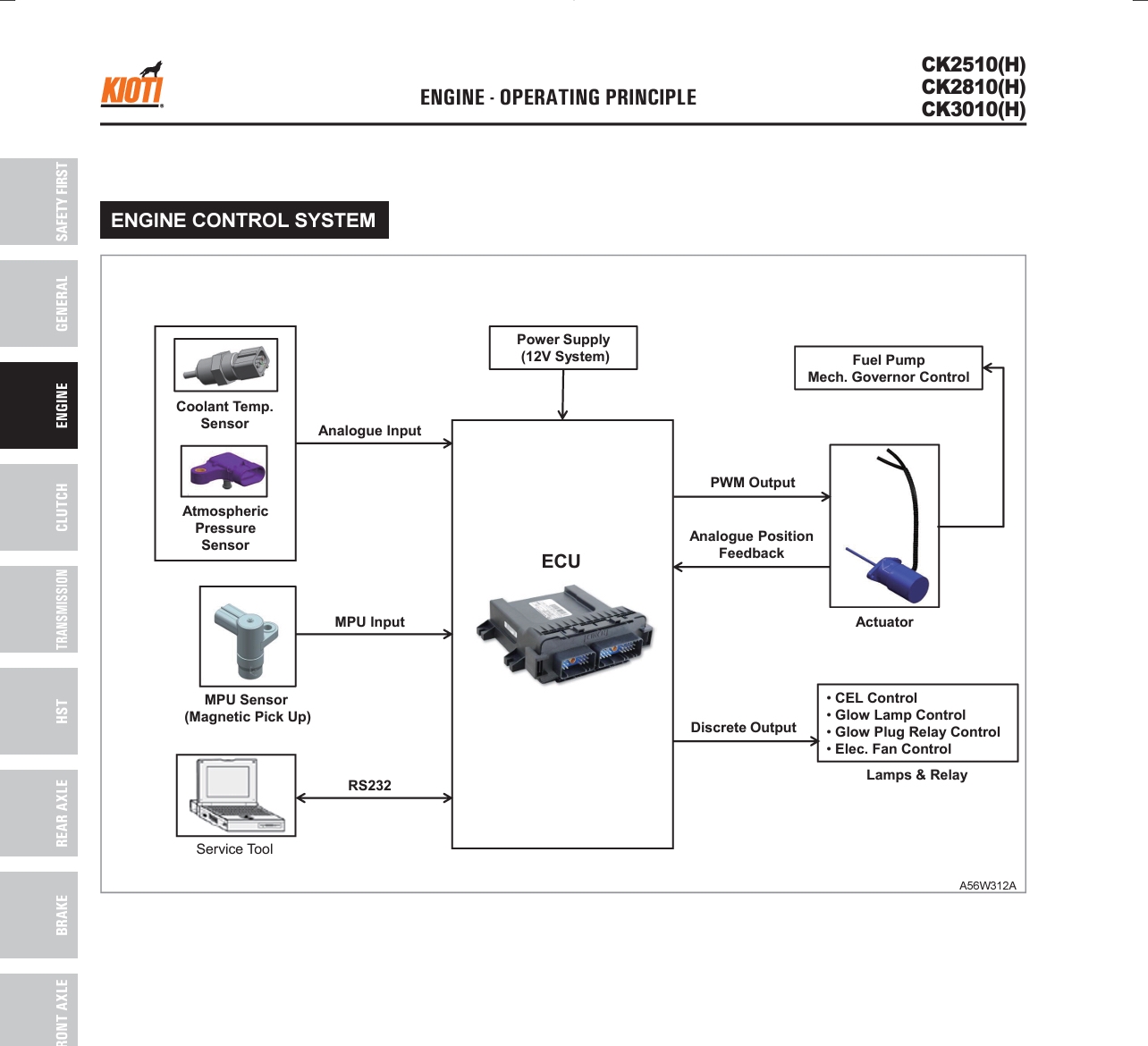

#18
Here the pages with the different codes and how to access the ECU, you may need it.
