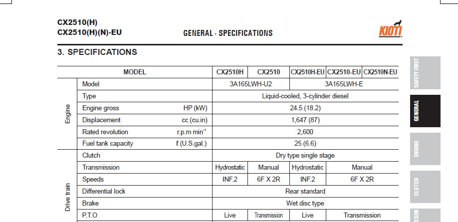

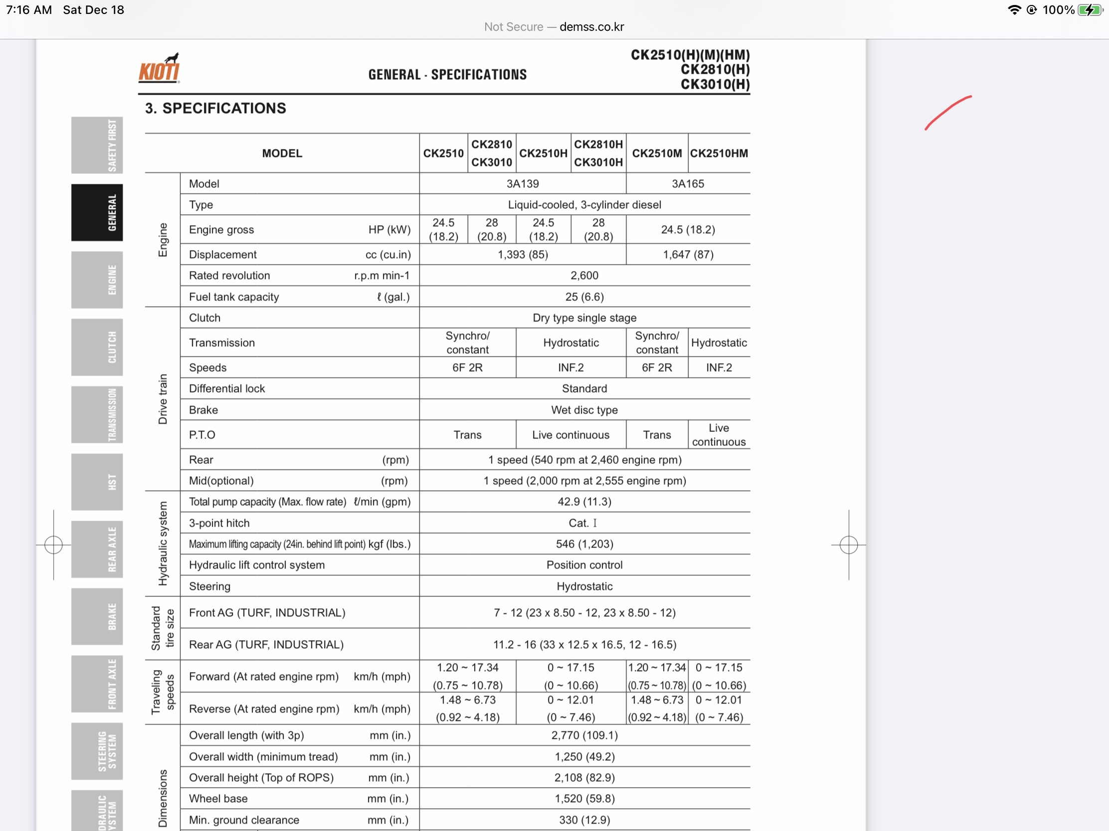

Love your videos Tim. Best tractor channel on YouTube IMO. If you were closer, I would buy you one of those cheeseburgers you talk about. haha. Which tractor did you test with the same drivetrain as the CK2610? I wasn't aware of the same drivetrain being offered in another tractor. Very similar ones for sure...but exactly the same?
The CK2610 has 100 CI displacement, but the CX2510 is only 87 CI

Can you share which model you tested? Hoping the CX2510. I'm caught between that and the 2032/38r and would love to see a loader test on the CX2510 like you did on the 220R MSL recently. These tractors are surprisingly similar in features, size and weight but it's hard to know, really, what the loader will lift unless you're able to do tests like you've done recently. Thanks for those, BTW. Still kind of wish the 1025r's 120R MSL had as much relative increase in capacity as the 220R MSL has versus the NSL.
Yes, CX2510. Operated one day at NC State University.
Did not get to test loader lift capacity.
We did notice that, like other 25hp larger frame machines, it is sort of underpowered.
I liked the machine.
