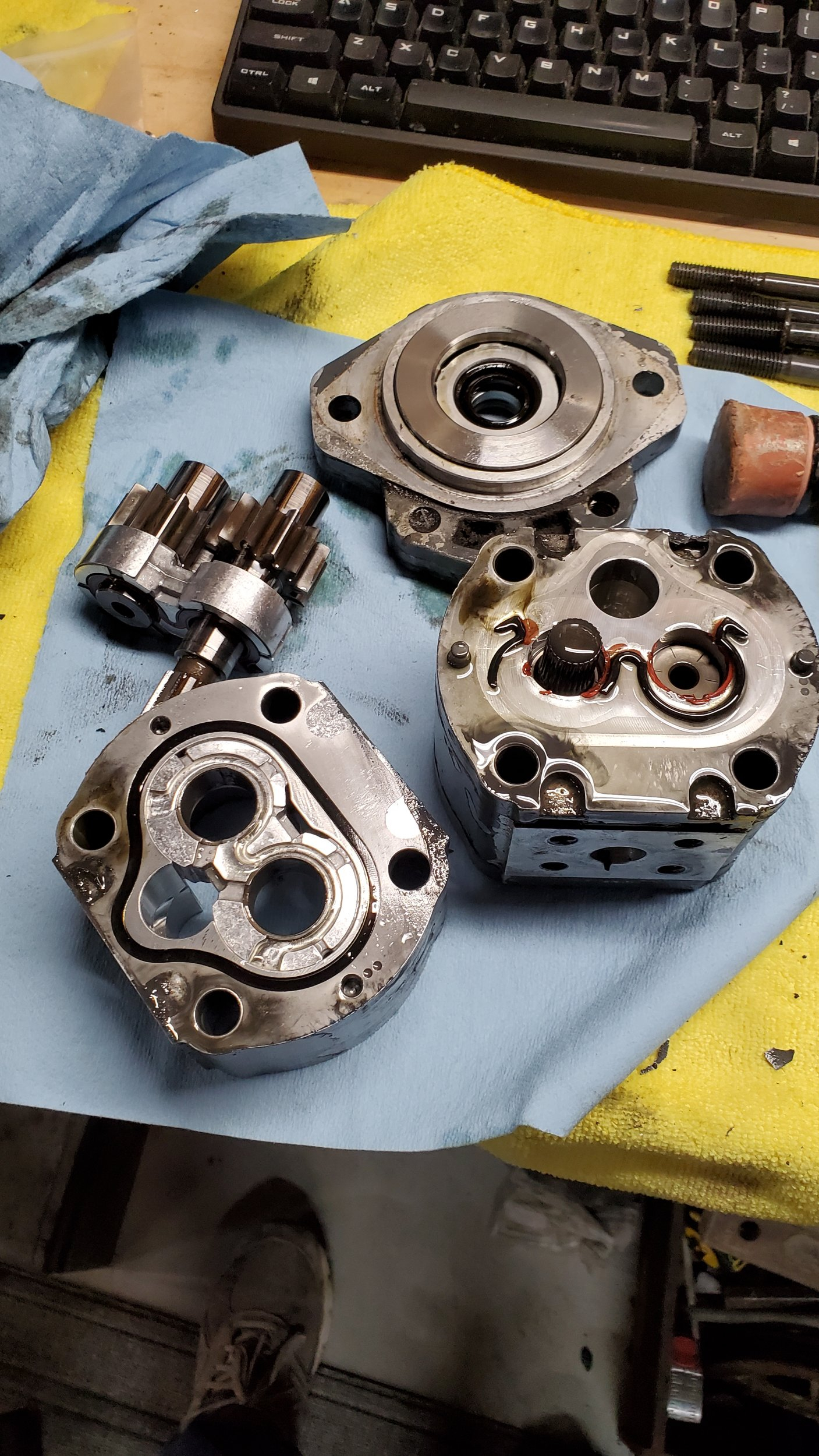

Thanks everyone for the help. I talked to Robertson equipment and the mechanic said he thought the pump was bad also. I removed the pump and disassembled it. First the long bolts that hold the sections together two were not tight (they loosened with finger pressure around the head of the ratchet. Second the seal to the engine was leaking to the point where my engine oil is above the full line. Last the seal between the low and high flow sections was missing about a half inch section of the black rubber and most of the red rubber was gone. It does not look like any signifigant wear to the metal parts. I havnt put the new pump on yet. I am worried about where the rubber has gone. how should i go about flushing the system?

Should be screens on the suction side (in the sump) that are removable and cleanable.

We wish you good luck with all your efforts for sure. I’m surprised that you were able to get a pump so quickly. Maybe after you have it all back together you could show us what bolts to check that you stated were finger loose.

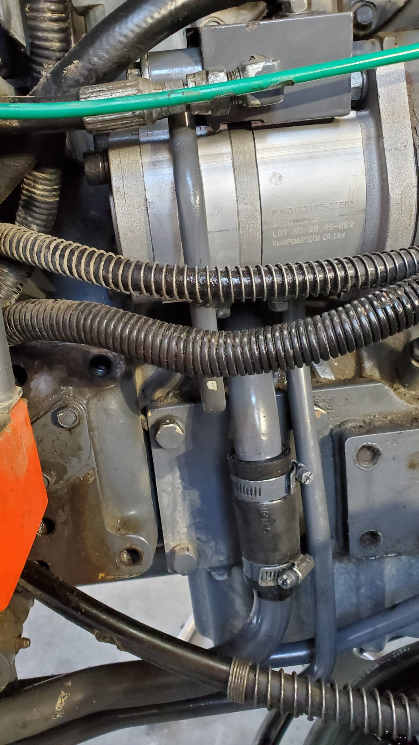

The new pump is installed. It works great. With the tractor hot (or cold) it will raise the front end off the ground and roll the bucket down lifting the tractor at idle. It will lift my 72 inch grader box to full height with the three point hitch at idle. Engine oil and filter changed. I reset the relief valve to 2600 psi. I will change the tractor fluid and filters after an hour or so.
Kioti had the pump at my door in two days from the time I placed the order. Best service I ever got from them.
Robin asked where the bolts I found finger tight are located. I believe the new pump is a Joy Yang pump. The Failed pump was a Casappa. In the photo below on the left end of the joyang pump is a black socket head cap screw. there are four of them on the the old and new pump equally space on the back plate. The only difference in the fasteners between the pump brands is the Casappa uses bolts instead of socket head cap screws.
There is a thread on here about these screws being loose because the threads pull out of the aluminum pump parts so be careful tightening them on an old pump.
If anyone has to do this job the only pointers are. You have to disconnect all the pipes (suction and pressure) to remove the pump. You cant assemble lines to the pump prior to installation. The large diameter suction pipe does have to be placed behind the pump against the engine before you put the pump in place. The pump to engine bolts have to be installed prior to installing the suction and feed lines. Dont ask how I found this out.
