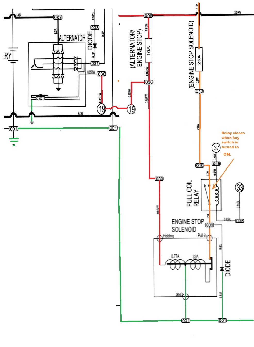

Which fuse is this? Were is it located? I have had to troubleshoot a couple blow fuse issues since getting my tractor. Each time it been some type of circuit short issue. I have a service manual now so I can take a look at the circuit diagram.
Thanks so much kattywumpus
I too have a Service Manual but I am really inexperienced in tracking down electrical stuff. I may be able to follow it if you can lead me.
Last night, when the fuse snapped, I first looked at the 10 amp Engine Stop fuse because that was the culprit last summer. It was blown and I replaced it a few times hoping I could just get the tractor started and out of the way of our cabin entrance. No luck.
After my friend towed me away form the cabin and was able to get me just inside the barn door, I tried one more time. This time I don't think I even hear the first loud click of the fuel solenoid so, I packed it in for the night.
This morning I spoke with the mechanic at my dealer's shop and, on his suggestion, I checked the 25 Amp Engine Stop Solenoid fuse - it had blown but the last 10 Amp Engine Stop fuse I put in last night appeared to be OK.
I replaced the 25 Amp fuse and tried to start the tractor but it was just too cold (you may have seen on another thread I am having trouble with my lower rad hose heater as well).
I did notice the loud click of of the solenoid when I turned the key to the glow plug position and, unlike last evening, I did not hear the snap of the 10 Amp fuse blowing - hopefully a good sign.
With some luck this may mean I could start the tractor (once the heat lamps do there jobs), remove the snowblower and be positioned for the dealer to winch it onto his trailer next week and take it to the shop.
Unfortunately, I understand the KIOTI warranty apparently only covers repairs etc once the tractor is at the dealer's door - no haulage fees are part of this. Not sure how the dealer will handle this as he is away this week and I have been talking with his mechanic.
I kinda feel between the proverbial rock and hard place because the tractor isn't much good if it doesn't run reliably. I am grateful I wasn't at the end of my laneway or partly on the road last night when the fuse blew.
The saga continues and any advise or suggestions are appreciated.

Thanks for waiting, I'm been very busy fixing other issues. Either meter should work. Keep in mind DC current and voltage are two different things. You want measure voltage with these meters you have. I do not think these meters can handle the current/AMPs the tractor electrical system can output. Also the service manual electrical section has a lot of good information on troubleshooting. I only looked at the circuit diagram before, I reviewed the section Sunday and was impressed by all good troubleshooting processes in the electrical section.
Lucky it appears the Engine Stop Solenoid circuit is not too complex. I create and attached simplified diagram. Please verify I have the correct fuses.
I think the first thing I would test the engine stop solenoid and then verify there is no shorts in the wiring between the solenoid and the fuses.
Page 11-63 show the check process for the Engine Stop solenoid. Pull the 10 and 25 amp fuse for this circuit. I would use a hairdryer or heatgun on low to warm up the plastic connector on the solenoid to avoid breaking the connector when you disconnect it. Look for water or ice when you disconnect it as this maybe the problem. Page 11-3 show were the solenoid is located.
Set you meter to OHM and the lowest setting. Plug the black test lead in the "COM" port on the meter and the red lead in the port for OHM. Each meter is different, but normal it's the "+" or voltage port. First check the meter with the test leads not touching each other, the meter should show the number "1" to the far left. This indicate infinite resistance or no current from the meter can flow between the test leads. Next connect or touch the test leads together you should get a reading of zero or very low number. If these test work the meter is ready to test the solenoid.
If I'm interpreting the check process correctly by touch the black test lead to a ground (the engine block or metal side of the solenoid) and the red test lead to pin 67 on the solenoid connector the meter should read 28 ohm. Keep on mind if when you connected both test leads together the meter if it displayed 2 ohm then correct resistance for pin 67 is 2+28=30 ohm. So add the test leads ohm value to solenoid ohm value documented in the manual to get the correct value the meter should display. If the meter shows the same ohms when the leads were connected together most likely the coil in the solenoid is shorted. The 68 pin resistance is a shorted circuit reading since the resistance is so low. So it's ohm reading should be near the reading you receive when connecting the two test leads together. I recommend drawing diagram of the connector and record on it the ohm reading between the pins and the ground. I would also take ohm reading between the pins and note reading on the diagram. This information might be helpful later.

Thank you so much for your detailed explanation. I do own you an apology however because yesterday, when I spoke with the dealer's mechanic, he insisted that they come and pick up my tractor, take it to their heated shop and fix this recurring electrical issue (which he has seen once before on a DK45), along with two or three other minor things that have been identified.
I was too busy yesterday afternoon and evening to post this update on here and now I see you have done a great deal of work on my behalf. Based on my perception of your level of mechanical expertise, I am not sure I would be able to return the favor but I would welcome the opportunity should it arise.
I have learned from your detailed and straightforward explanation of what to do and I will hopefully be better able to troubleshoot the next time. Hopefully you can take some satisfaction in knowing your efforts were not entirely wasted.
Once I get the details from the dealer's shop on what was done to "fix" this I will post them.
