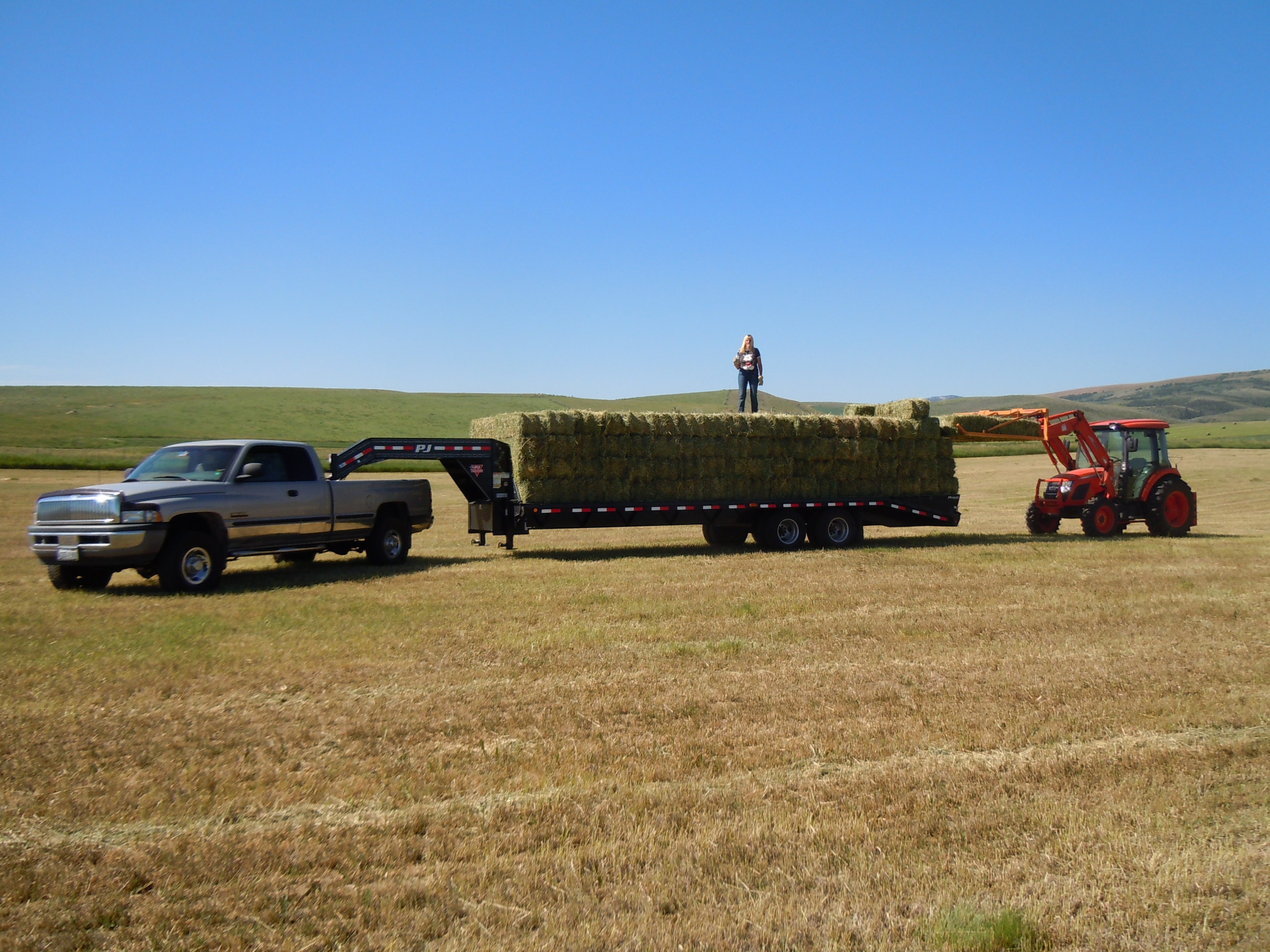

I have the RX7320, about 75 hours on it. I was out moving hay today and tried releasing the clutch when in high range, 1st gear. No shutter. RPMs were about 1600. Not cold here today ~40F but engine wasn't all the way up to operating temp when I did this. Hope this helps. I really like the power shuttle in this machine. There is a way to increase/decrease the rate at which it accelerates/decelerates when moving the shuttle lever from forward to reverse or reverse to forward. I've not really played with that. Seems fine where it is on mine. Perhaps the model you tested was set to be very aggressive?
My 2 complaints so far with this tractor are 1. cab noise and 2. no buddy seat. Neither of which can be dealt with via options, dealers, or aftermarket stuff as far as I know.
