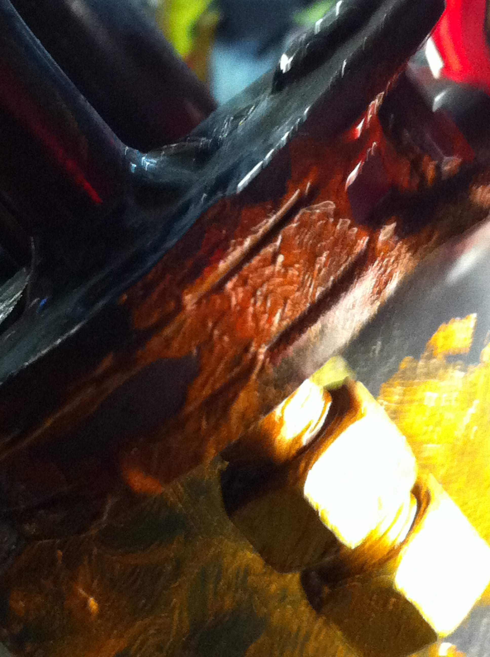

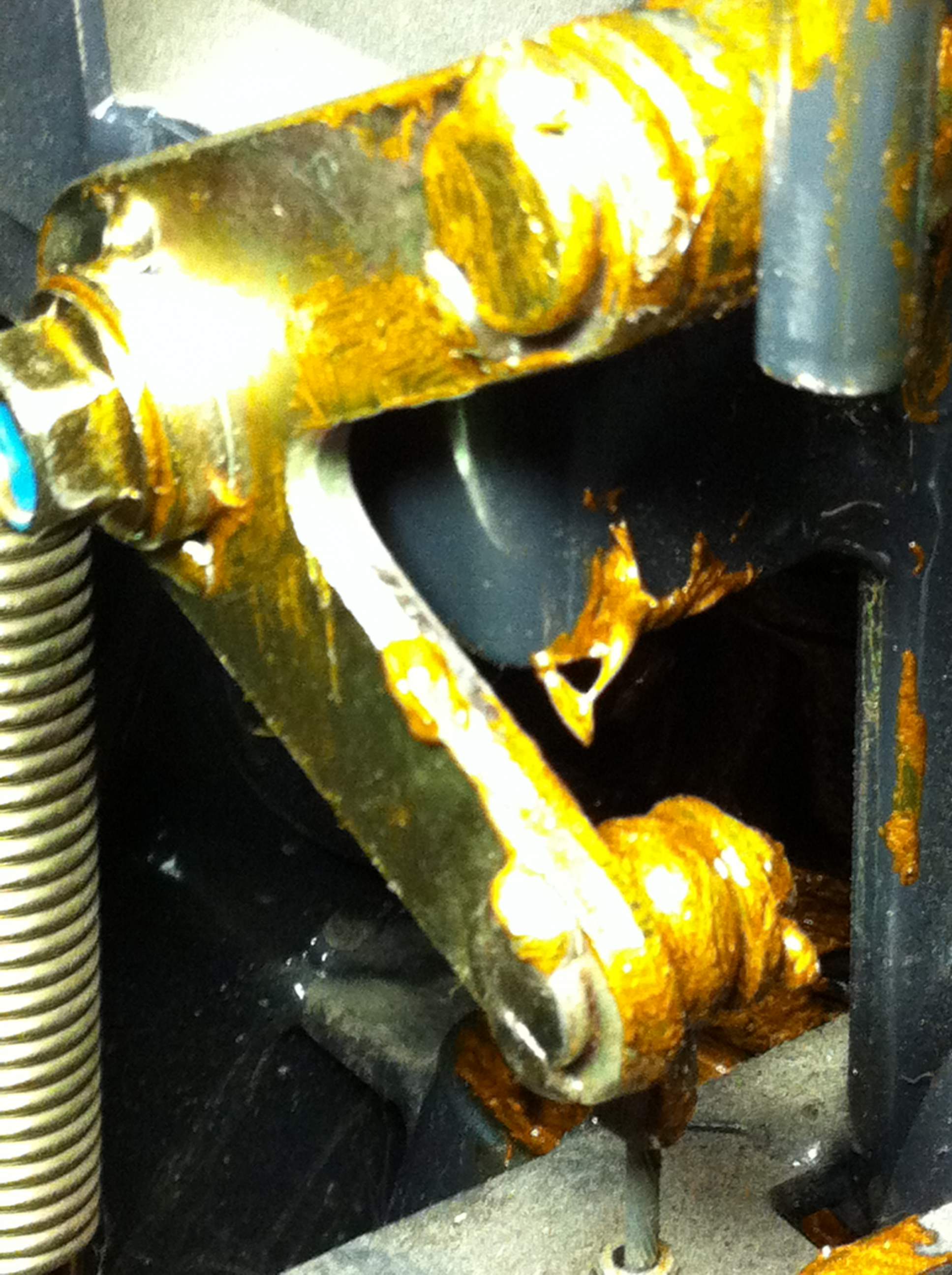

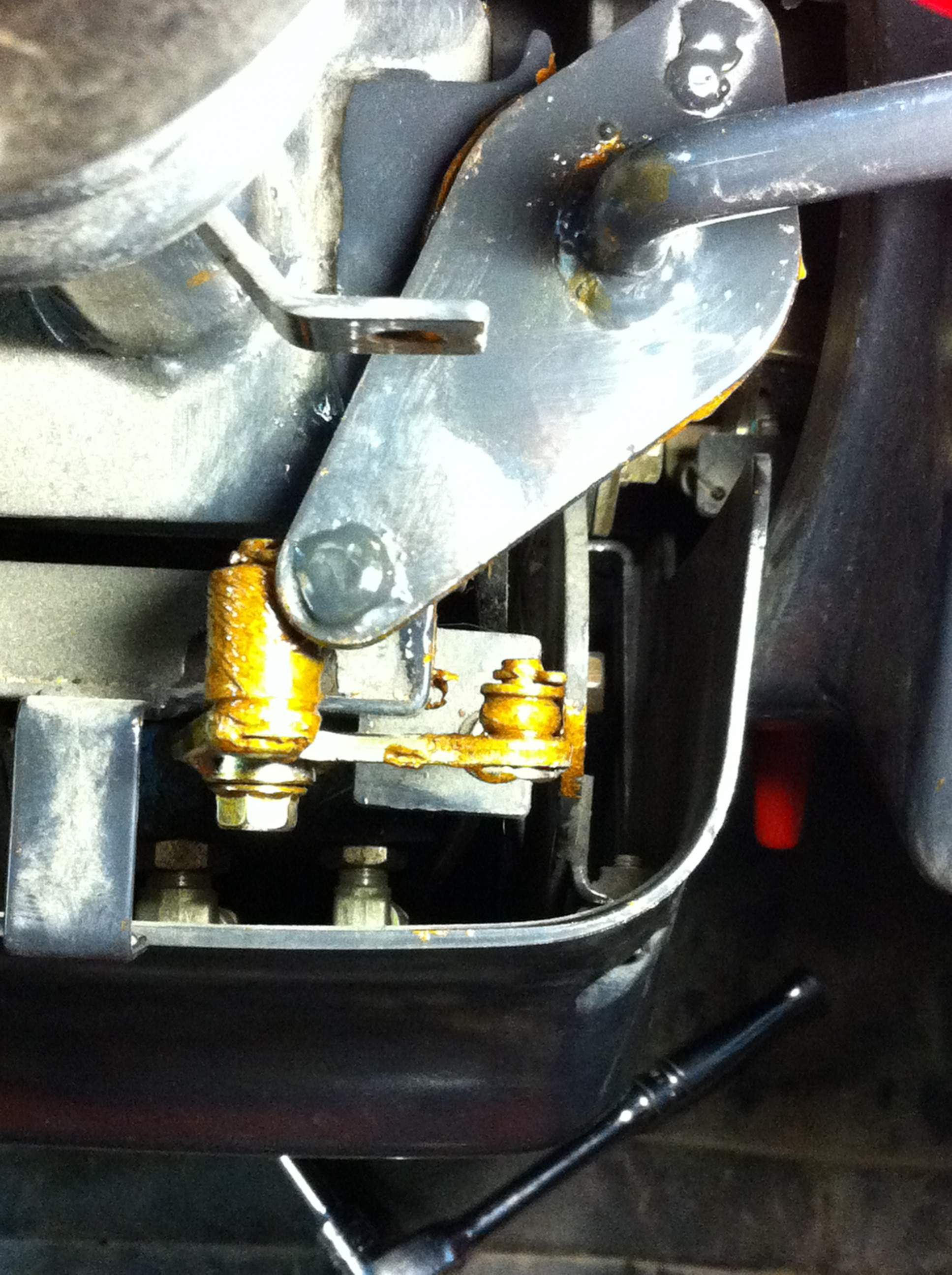

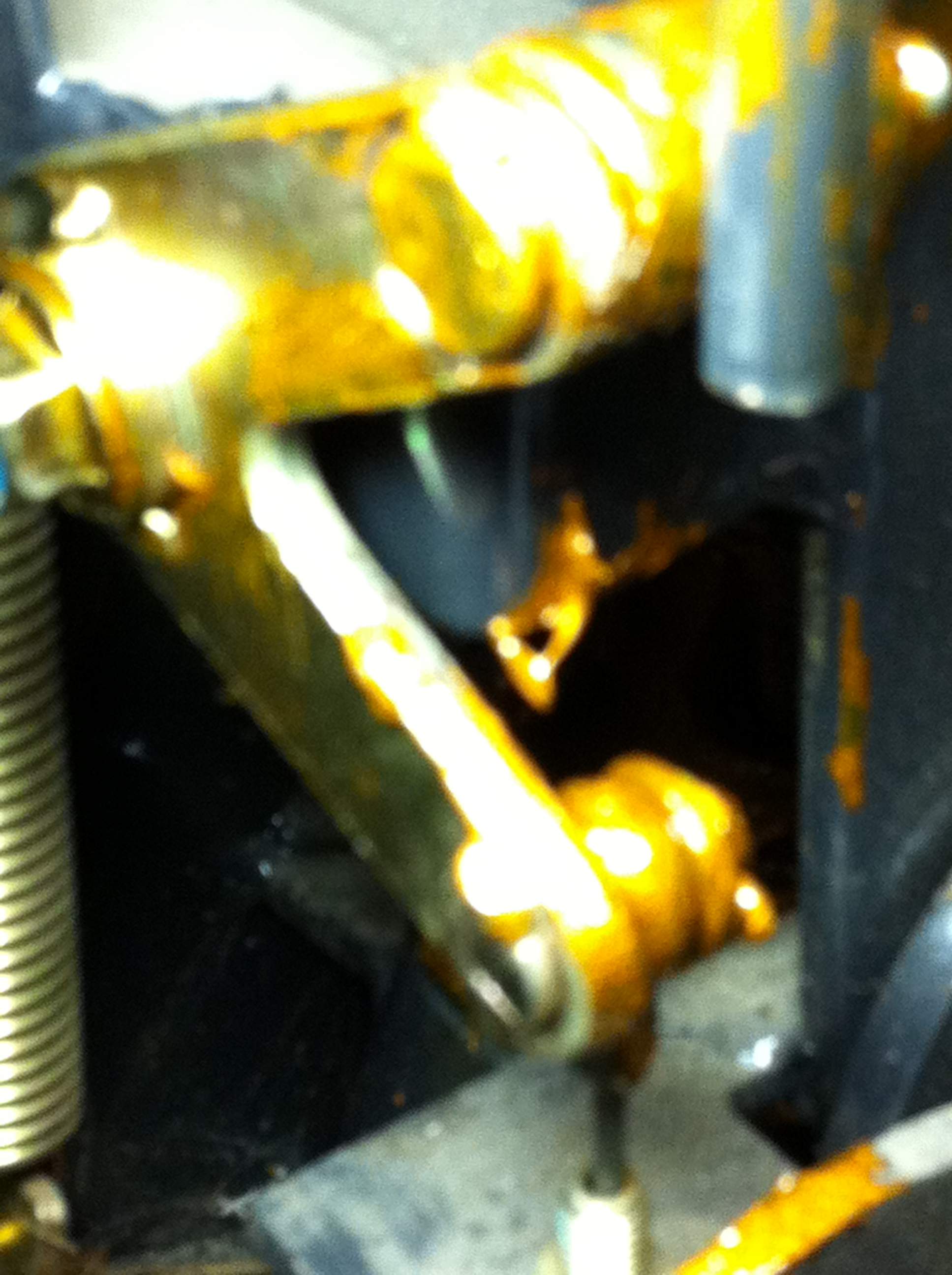

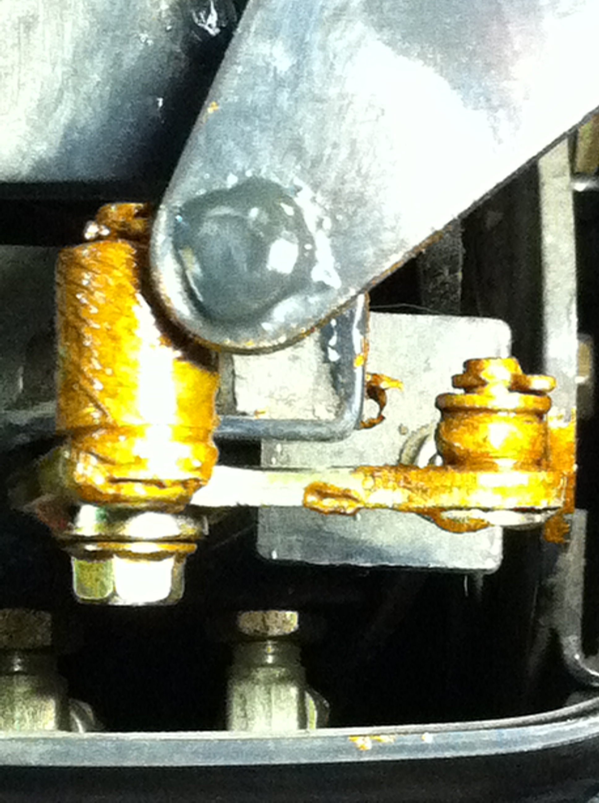

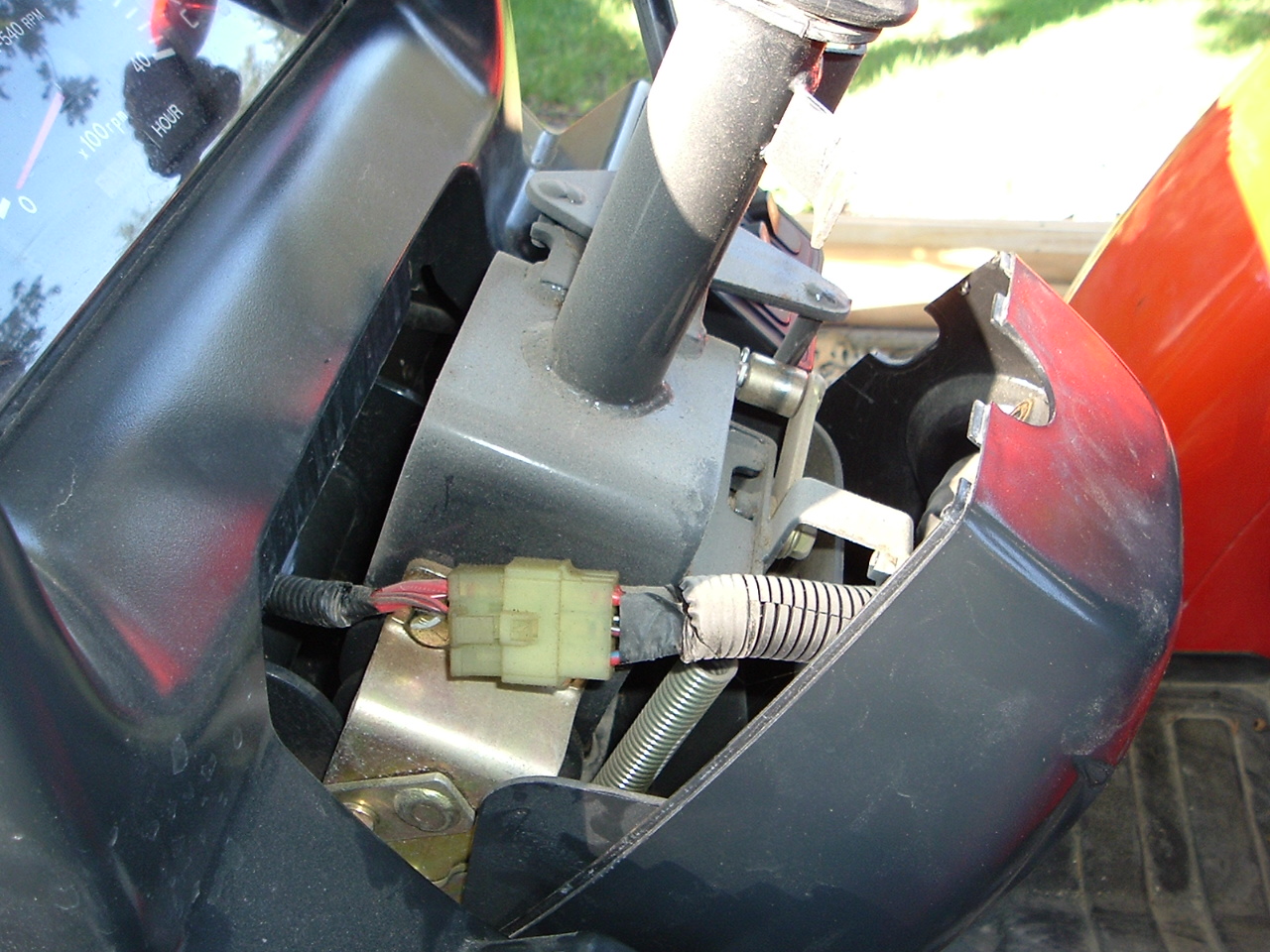

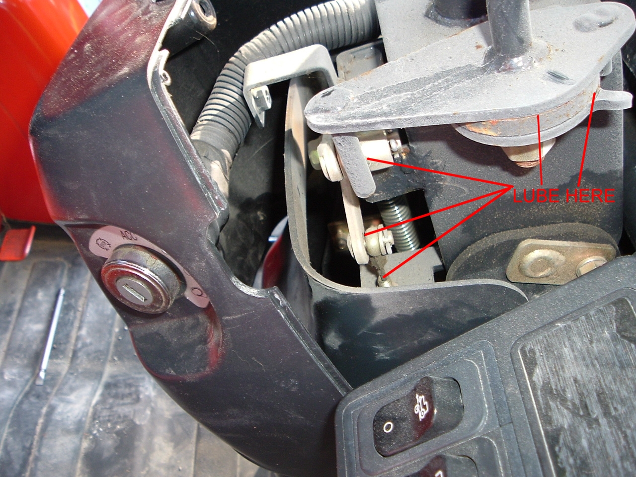

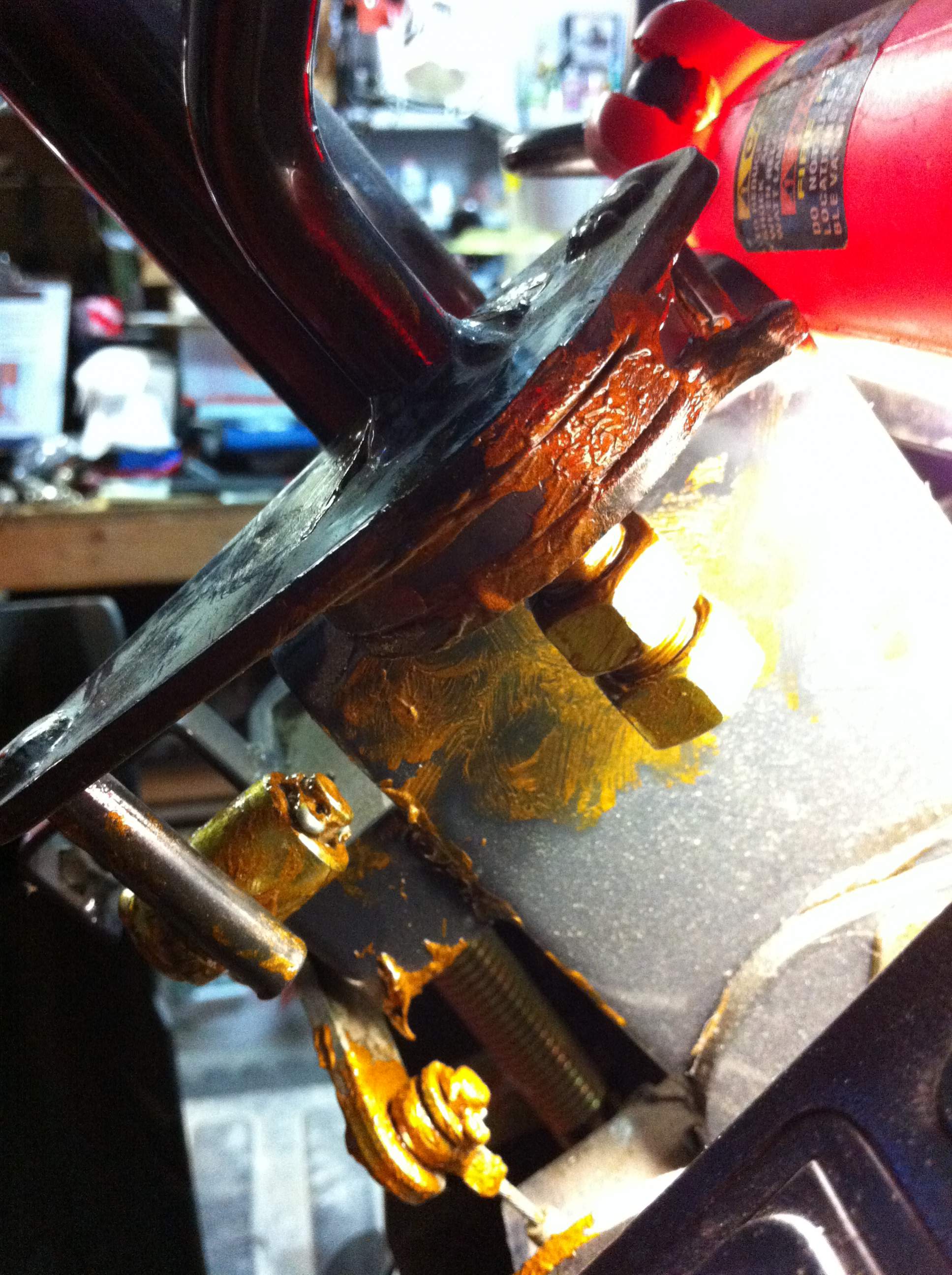

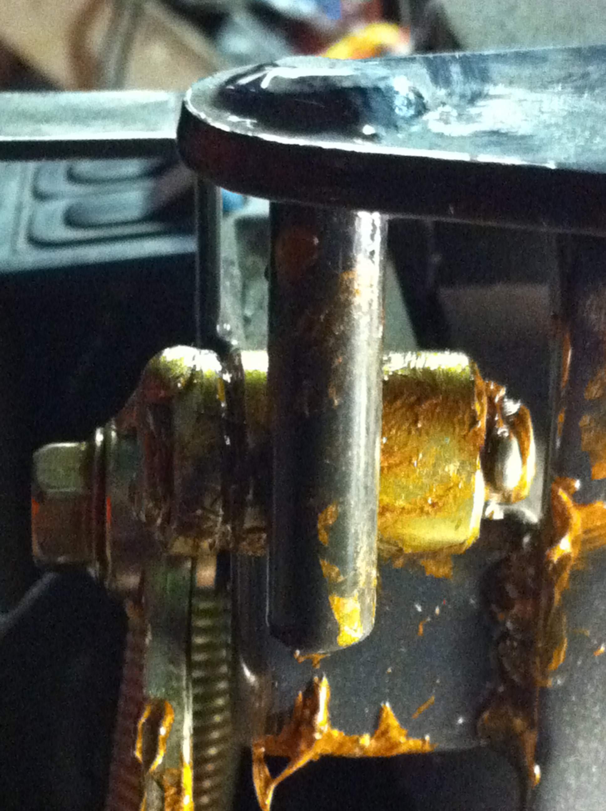

Today I decided to finally get around to lubing the very stiff hand throttle of my DK35se. It was always stiff and not getting any better with age. First challenge is to figure out how to remove the two "clam-shells" of the upper and lower cover around the steering column. The two holes at the top were a little bit of a mystery, as there did not seem to be a bolt or screw in the holes when probed with a screwdriver, all I got was dirt and rust. They seem to just be holes to allow water to get down into to rust the ends of the 10 Millimeter bolts that go in from the bottom. :)
They are part of the manufacturing process of the moulded in imbedded nuts I suppose. Any way you remove the 10 millimeter bolts with a small impact ( I used my Rockwell Thrill on impact mode). They have phillips head crosses in them too but you are not going to get these top two off with a screwdriver for sure as they will be rusted. Note I recommend dropping some lube down those holes at least once a year, I intend to, even though my tractor rarely sits in the ran any more.
After removing all of the bolts, you press in on the bottom on both sides of the top clam shell piece to release some small moulded in catches. You Then unfasten the Molex connector on the left side that contains all of the connections for the Key switch.. I lubed up all of the moving parts. but the main part that did the most good was to apply some Kroil to the top part of the friction washer underneath the piece of metal the throttle handle is welded to. This is put on very tightly with 17 MM nuts in a double nutted fashion and probably with an Impact.
After the Kroil loosened it up a bit, I followed that with some Fluid Film, which is my spray on lube of choice, as it penetrates as a liquid, but forms a grease after a few minutes.
Of course re-assemble (you will enjoy getting everything lined back up) and you are done. Now the throttle is many ft. lbs less torque to operate, but still has enough tension to not vibrate around. Of course this would also be the way you would replace the notorious key switch.. I had a few intermittent contacts at first with the key-s$
