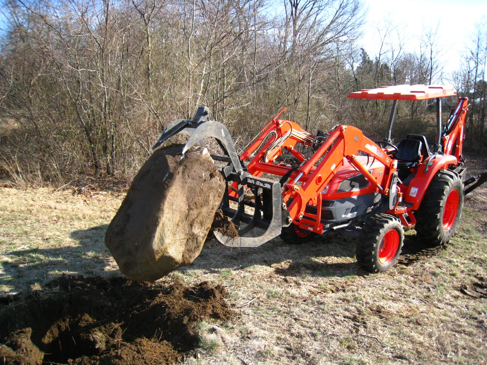

Kioti does have pretty full specs on their loaders. For example, I believe (from memory) that the CK35 can lift about 1100-1200lbs at the pivot points. The DK40 lifts a bit more than 2700lbs (which is why we all love it).
My grapple is a Millonzi Light Duty 48" which is supposed to weigh 280lbs per the now defunct manufacturer (They were doing well with many satisfied grapple customers but the owner died four or five years ago). I have beaten the crap out of it first with the CK20 (nary a scratch to the grapple) and with my DK40 (managed to bend the tips of the upper tines when I ripped the boulder below out of the ground, boulder weighed over a ton and was clamped just on the tip of the grapple as I did not know it was a big boulder (iceberg phenomenon)). Only repairs in eight years of land clearing have been to heat and straighten the tips of the upper tines and then reinforcing those tips with gussets. In retrospect the upper tines were really not sufficiently supported at the tips as there was no gusset for the last six inches or so. I pulled the upper arm off the grapple, threw it in my car trunk and had a welding shop do the repair and strengthening for $50. Not bad considering all the abuse I have heaped on that grapple.
I would not hesitate for one minute to use a EA Wicked 50 on the CK35 or L3800. Frankly, it would do fine with a DK40 too but the manufacturer is just rating the grapple conservatively for business reasons.
The key point with grapple use is to never do anything that TWISTS the grapple. Always lift or push with the load as centered as possible. If you do that the grapple is WAY stronger than any CUT FEL.
