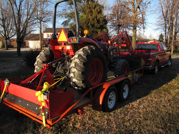

I had mine maxed out. My dealer and I found that by rolling the bucket to full dump and resting that on the front rail of the trailer it balanced out the best. We cinched the bucket to the trailer rail along with all the other tie downs. It did a 70 mile trip this way, was unloaded then loaded back up and taken to my property another 120 miles.

The trailer may have two 3500 lb axles = 7000 GVWR. As someone mentioned the trailer may weigh in the 1800 lbs range leaving 5200 for a max payload available on the trailers axle/tires.
I had the same issue with my FT60 (50 hp Farmtrac) with filled 14.9-28 R-1s/fel and a 6' Rhino mower on a old 7k trailer with two 3500 lb axles with D tires at 2540 lbs and one axle braking. The trailer had a added 5" wrap around front frame but was still overloaded as the tractor/fel/mower weighs in the 7000 lb range.
Sold the little 7k trailer and bought a 10k trailer with two 5200 lb axles and 16" E tires. Scaled weight with the tractor/fel/mower with the new trailer is 9600 lbs on the axles and about 950-1050 on the truck. Much safer. Those much bigger brakes on the 5.2k axles stop the load with ease.

While it may be good to position the tractor to get as much weight as can safely be put on the hitch, it is even more important to balance the weight equally on the 2 axles. When you are running close to the tire/axle limits or slightly over, then you want each tire and axle to be carrying the same share of the load, so that one is not more overloaded than another. If you start pushing a lot of weight forward you may end up with more on the front axle than the rear depending on the type of suspension and other factors. You don't want to end up with 60/40 or even 55/45. Right now it seems like you might be having more weight on the rear axle since you say the rear tires were more "dented" with the load on. If you back on it may go the other way. You can only do so much because you're constrained by the geometry of the trailer and the suspension setup. Better to have the overload balanced equal between the 2 axles than worry about the tongue weight, unless of course the tongue is so light it might cause unstable towing. Is the trailer hitched level?
Maybe you can load the bucket in the truck bed; take it off and lift it in with some nylon straps before you load the tractor.

I can back the tractor on the trailer to put more load on the truck.
With the FEL removed I will have a much easier time coming closer to centering the load.

Is there a place with a truck scale nearby? At some places if you don't need a weigh slip you can just drive over the scales for no charge. Just stop and get a weight as each axle gets on the scale, the differences between the weights is the weight on each axle. That'll give you a good idea how far over the tire, axle, spring, and brake ratings you might be. Even if they charge it should be under $10.

Your tractor with loader and fluids is just south of 6,000 lbs and the trailer is 1,800 lbs min. I think the tires are telling you something. :eek:

When he loads the tractor he'll if it's over weight for the axles if, he looks at the springs. They will be flattened out and the center pivot will be up against the trailer frame. That's how I knew I was over my axle weight.. I then weighted the trailer 2800#. I up graded the axles

I looked at your picture again: http://www.tractorbynet.com/forums/...your-towing-rigs-trailers-20140121_123456.jpg
It's pretty obvious that (1) the weight is way too much on the rear and (2) the trailer is not close to being level. Try backing it on, that should help a lot, or at least try resting the bucket on the A-frame.
The way it is in the picture the whole tractor is sitting just about directly over the tandems and the loaded rear tires are almost back to the dove tail with hardly any weight on the front of the trailer.
