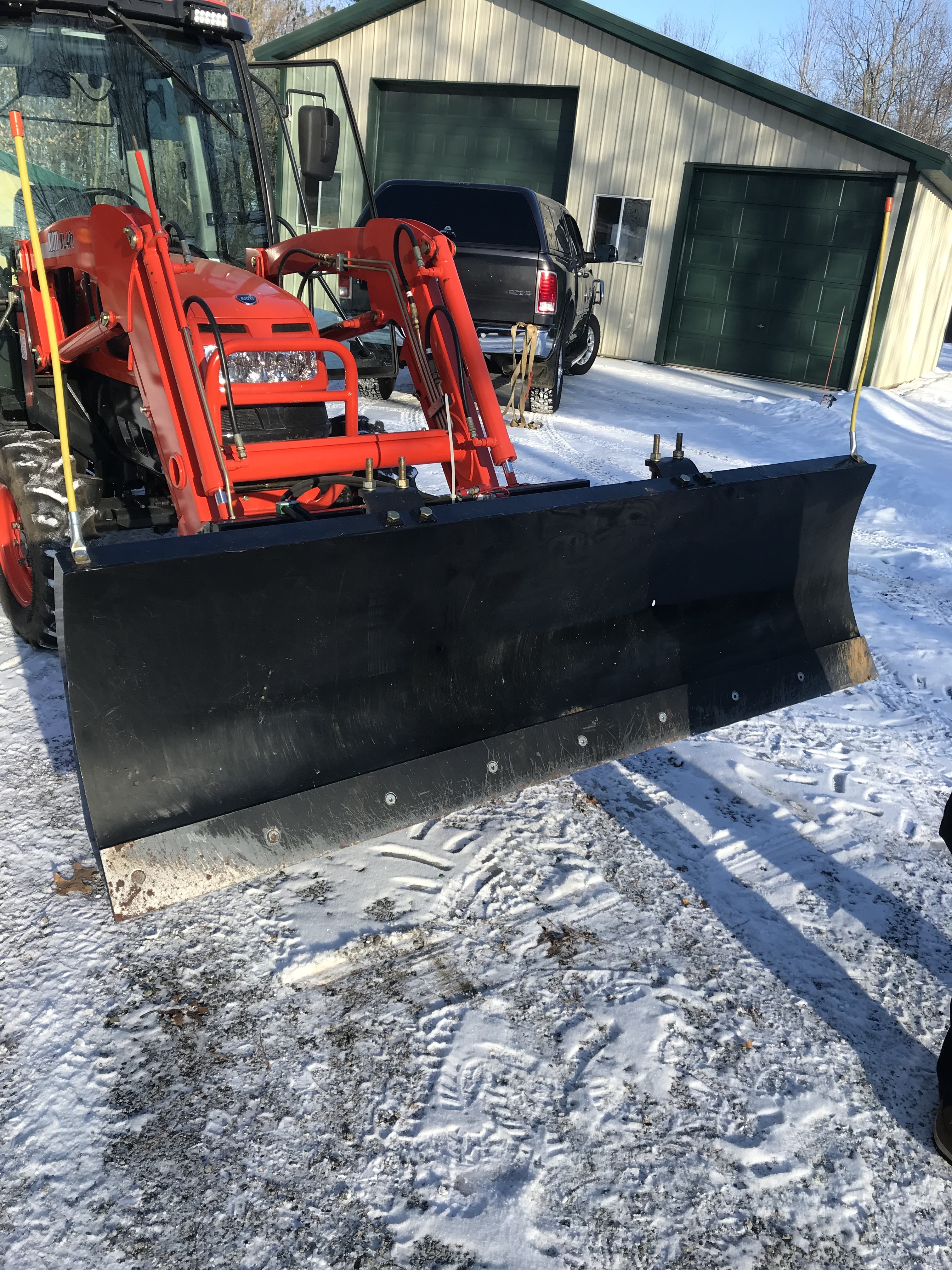

yes on the Kioti and purchase one of these.
What specific blade is that?

What specific blade is that?(( It was made/installed by my Local Kioti dealer Michigan Iron and equipment has hydraulic lift and angle.))
