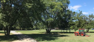

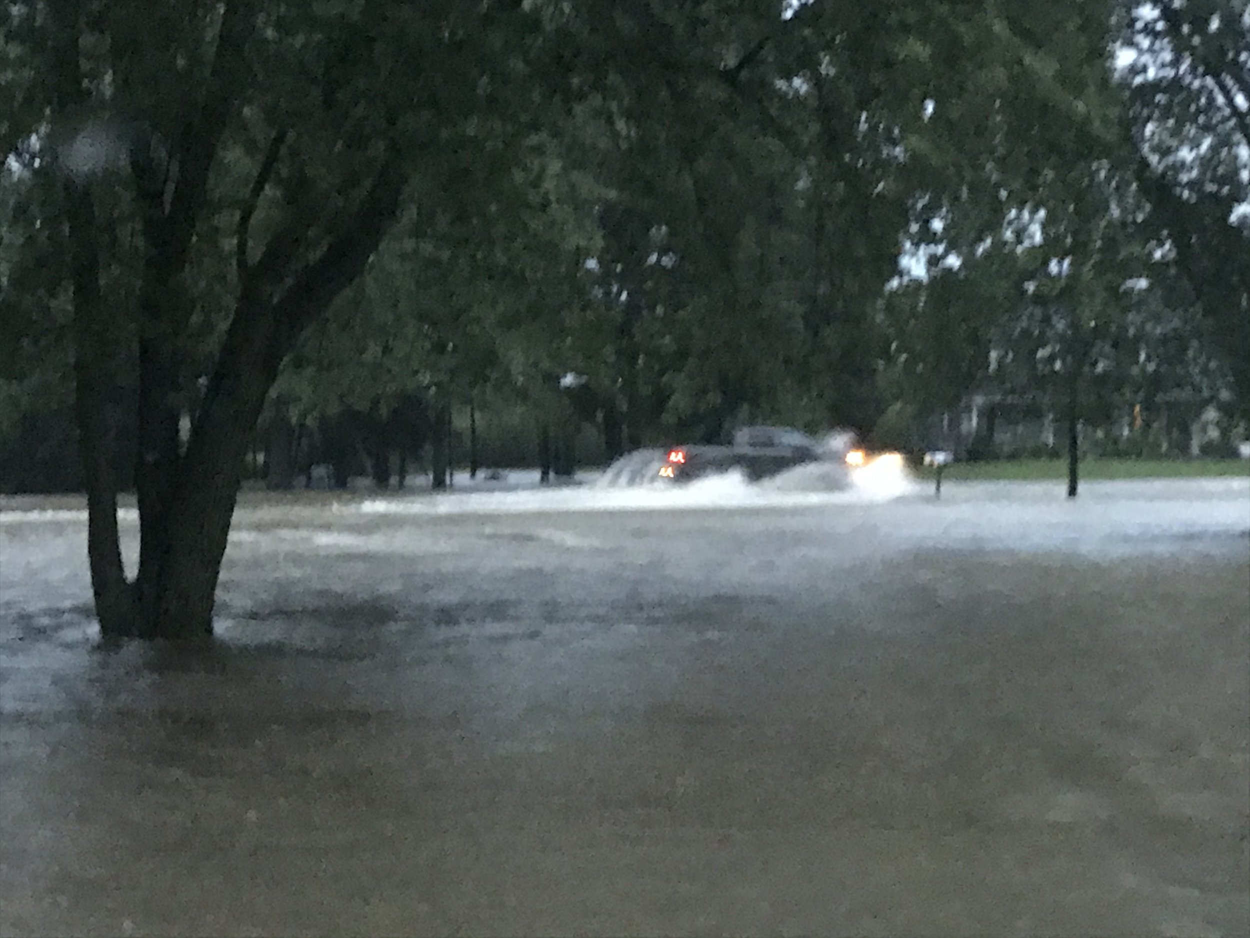

Here are a couple recent pics. Flood on Wednesday and mowing on Saturday. Can't convince me the L4240, 90" RFM with filled R4's is too big or heavy :)
