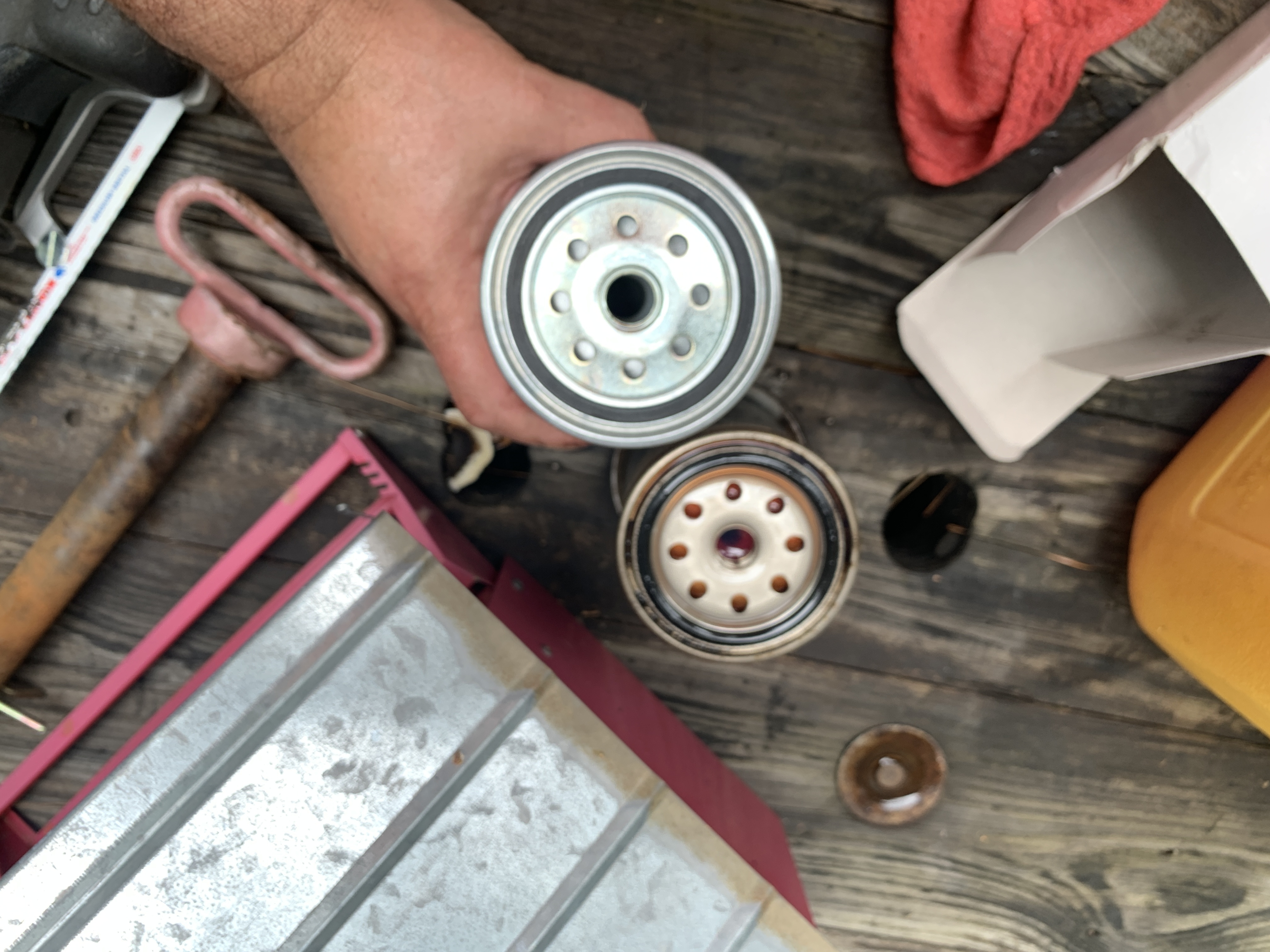

I'm looking at the 400hr maintenance for my 2019 NX5010 HST and found a filter kit on Amazon: KIOTI Tractor Parts NX Series HST Maintenance Service Filters. They use the Donaldson HST filter (P573481) instead of the Yellow T4125-38021 FILTER, HST HYDRAULIC and the Donaldson P822768 air filter instead of the Donaldson P827653. Has anyone used these swaps?
   / Kioti filter cross reference number list (all models) #133
TN8Man, I made a comparison write up of this filter a few years back, here is the link Kioti HST filter vs Donaldson HST filter, Opened both.

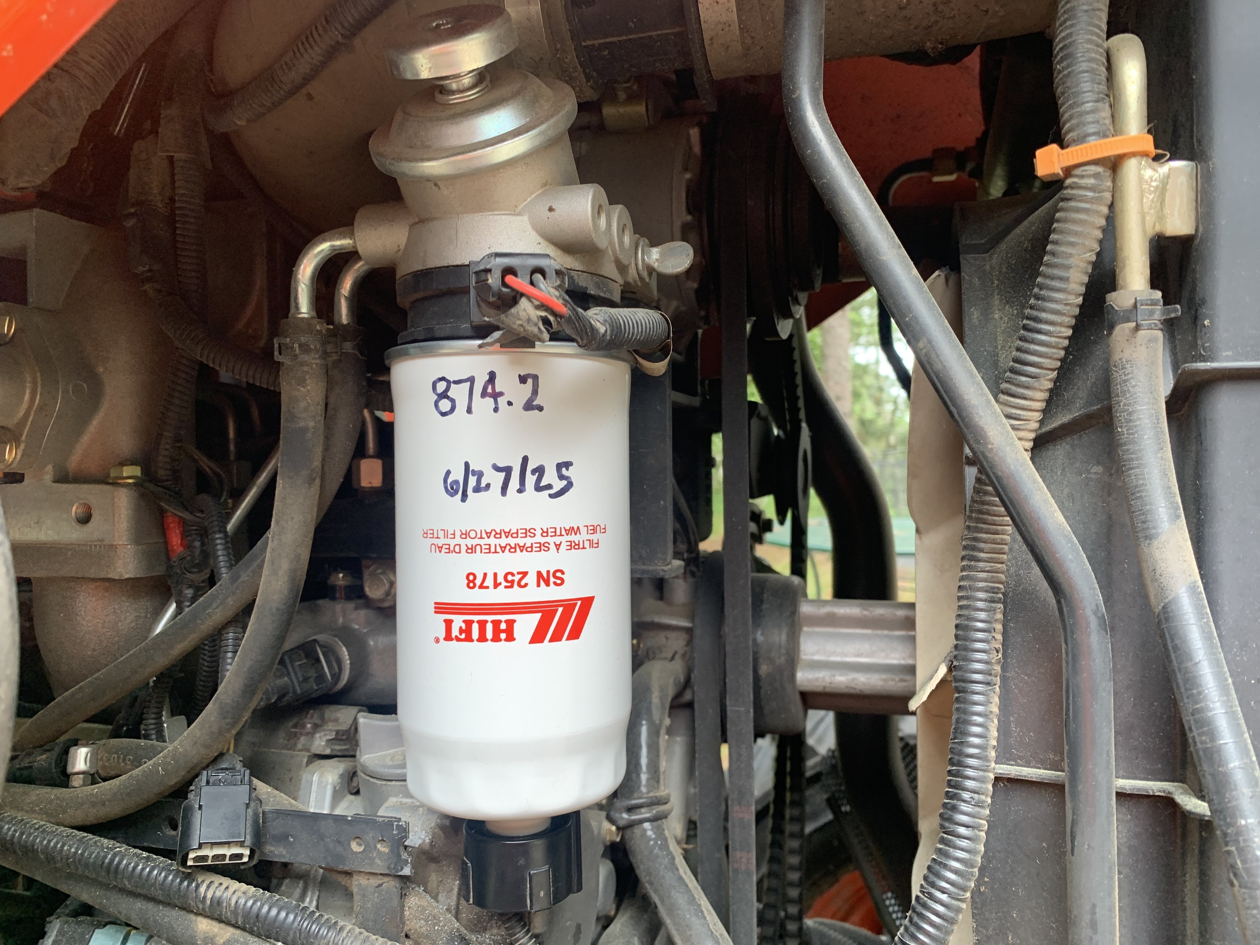

This thread is a gift that keeps giving. I just ordered a couple of the Hi-Fi fuel filters since they are less money than the Donaldson filters (and since my sister no longer works at Donaldson as an Engineer, heh).
Also, FWIW, it looks like Donaldson's P502142 is a good number for fuel filters with the screw-in water sensor on the bottom.
   / Kioti filter cross reference number list (all models) #136
Confirmation of worky, worky.

Be interesting to eventually cut open both filters and compare them.
