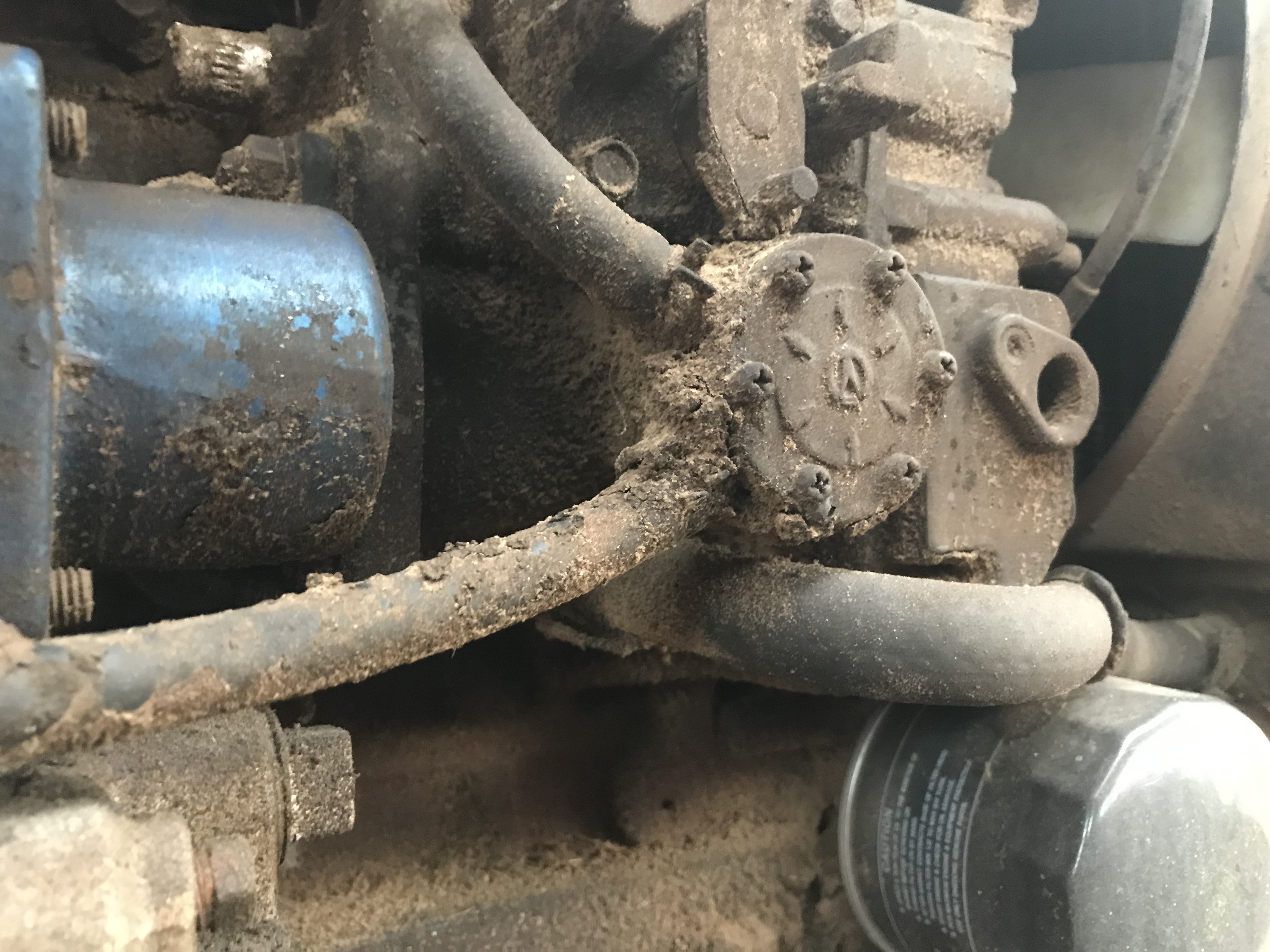

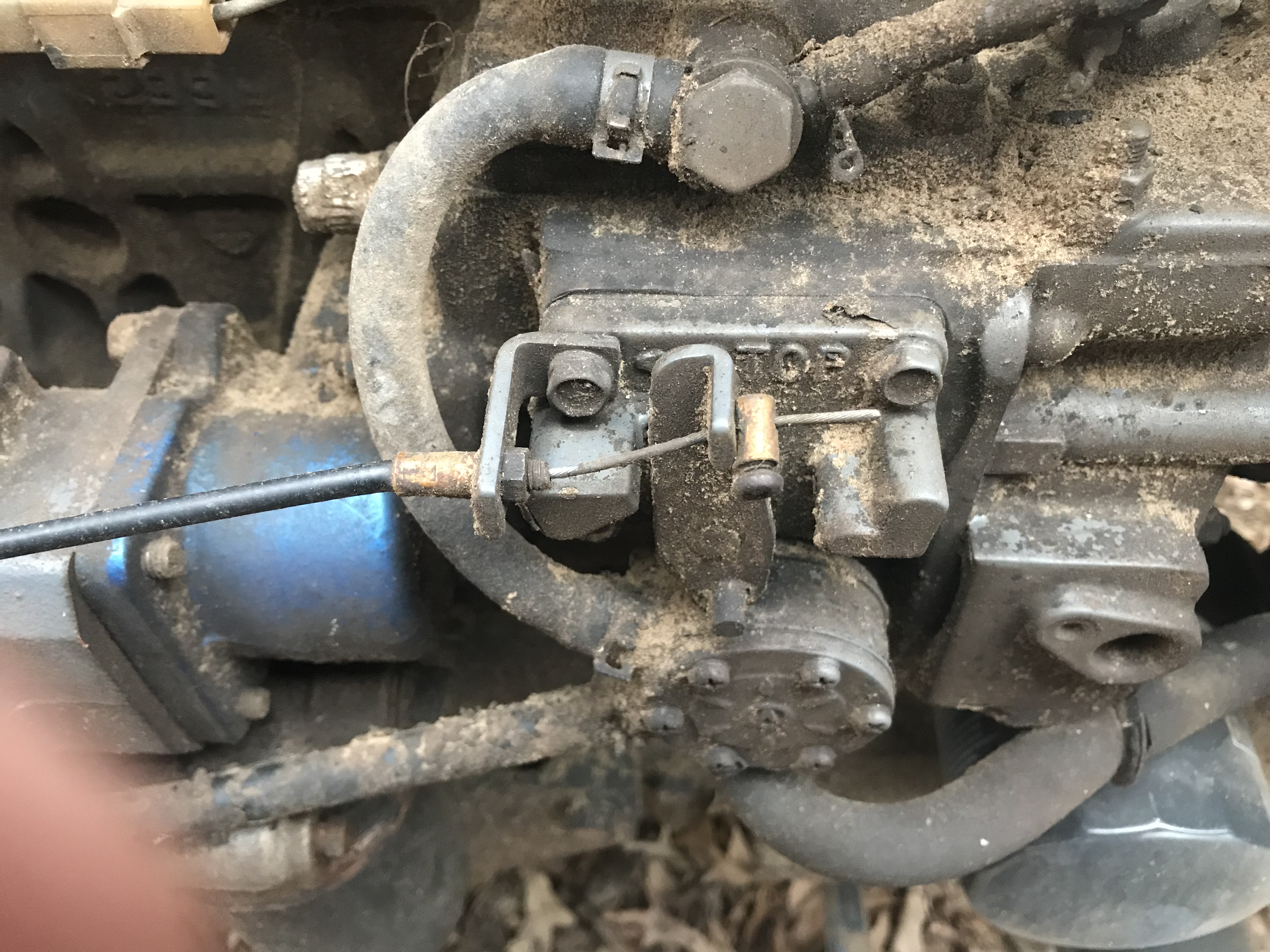

The lift pump bolts to the side of the injector pump. Here is a picture of it on my LK2554.

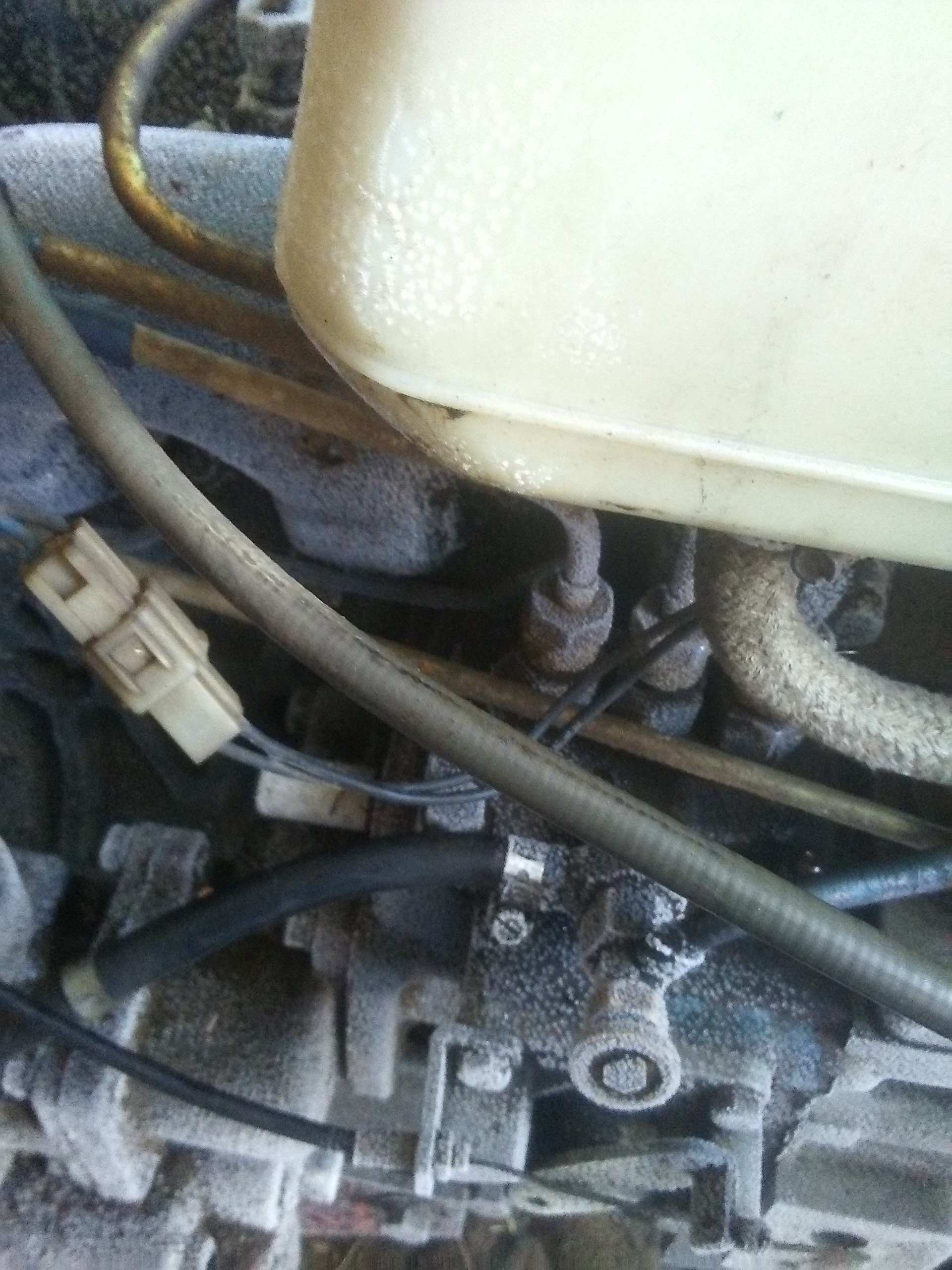

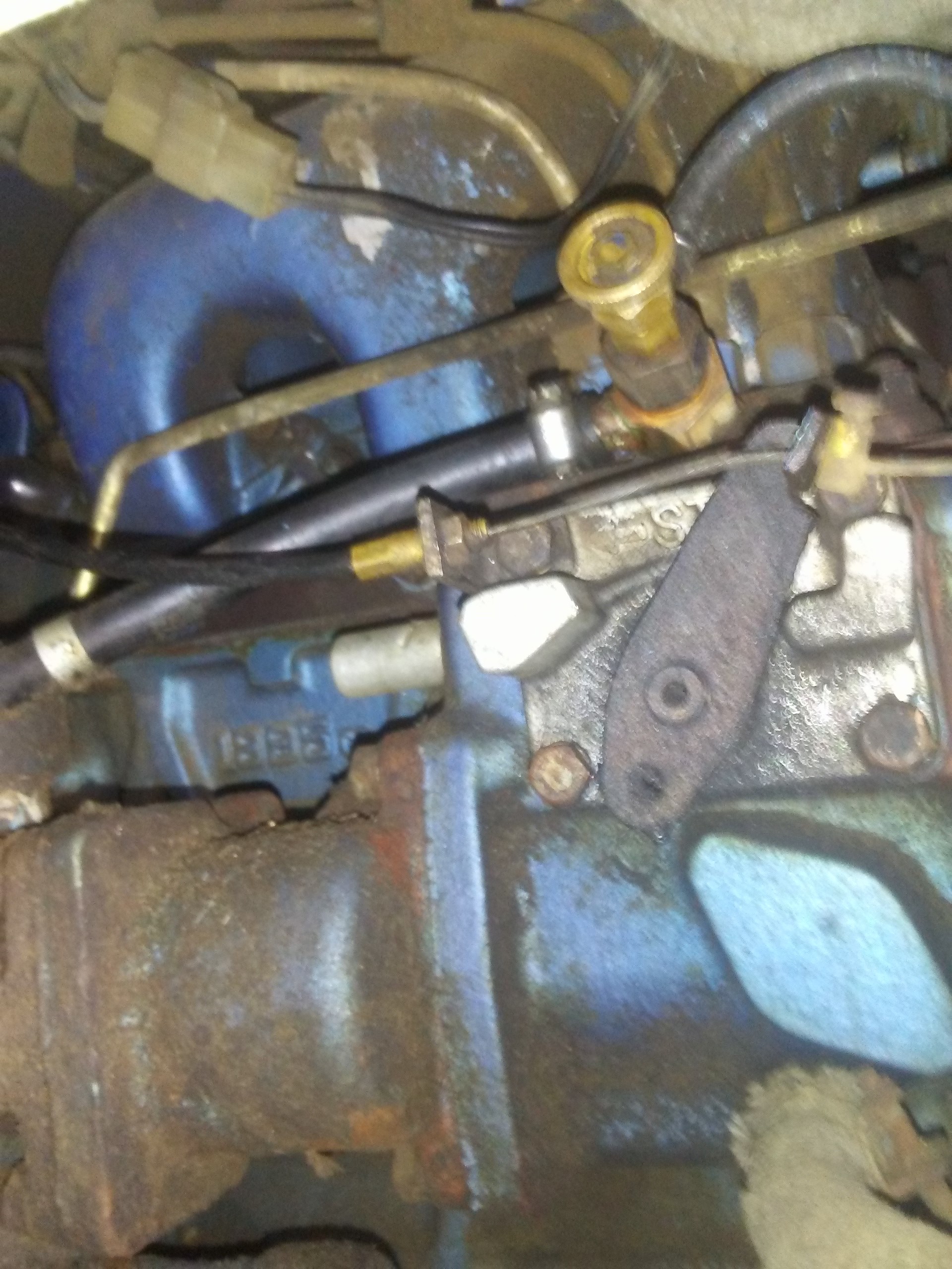

there is no lift pump. The tank is set high and fuel line comes out bottom of tank then into fuel filter and straight to into injection pump. I don't even see where one would bolt on, and it always ran fine before, and nobody has worked on it other than me and that was seals in front axle. i'll try to include a pic.

That is strange. The parts breakdown for both LK3054 and LK3054XS show the same fuel pump as mine. Our tanks should be in the same place at same height.
I think someone has removed it. It should mount below your cable. Here is a picture from a view similar to your picture.

I will take a pic a little lower to match yours. My fuel tank is just in front of instrument panel with filler neck right on top between instrument panel and raiseable hood. I will take a pic of that also. My tractor is a lot older than yours, so maybe it the year it was built. maybe I can pull a date off the id tag.
