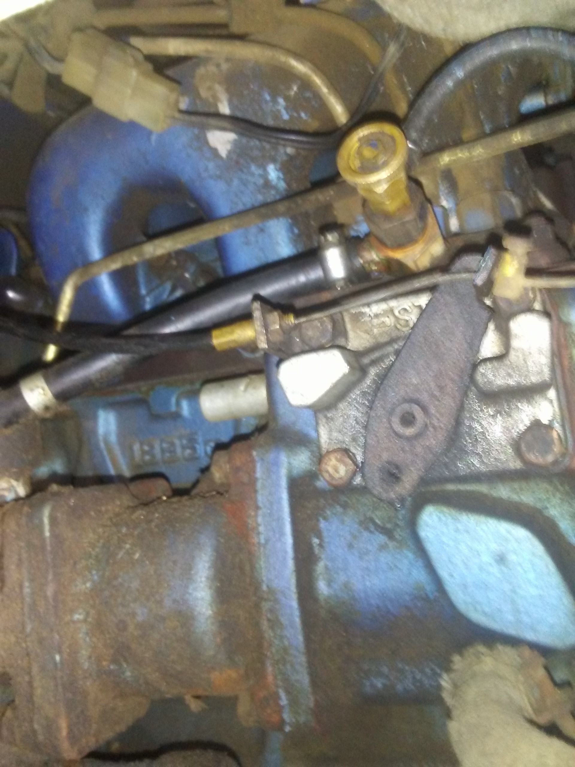

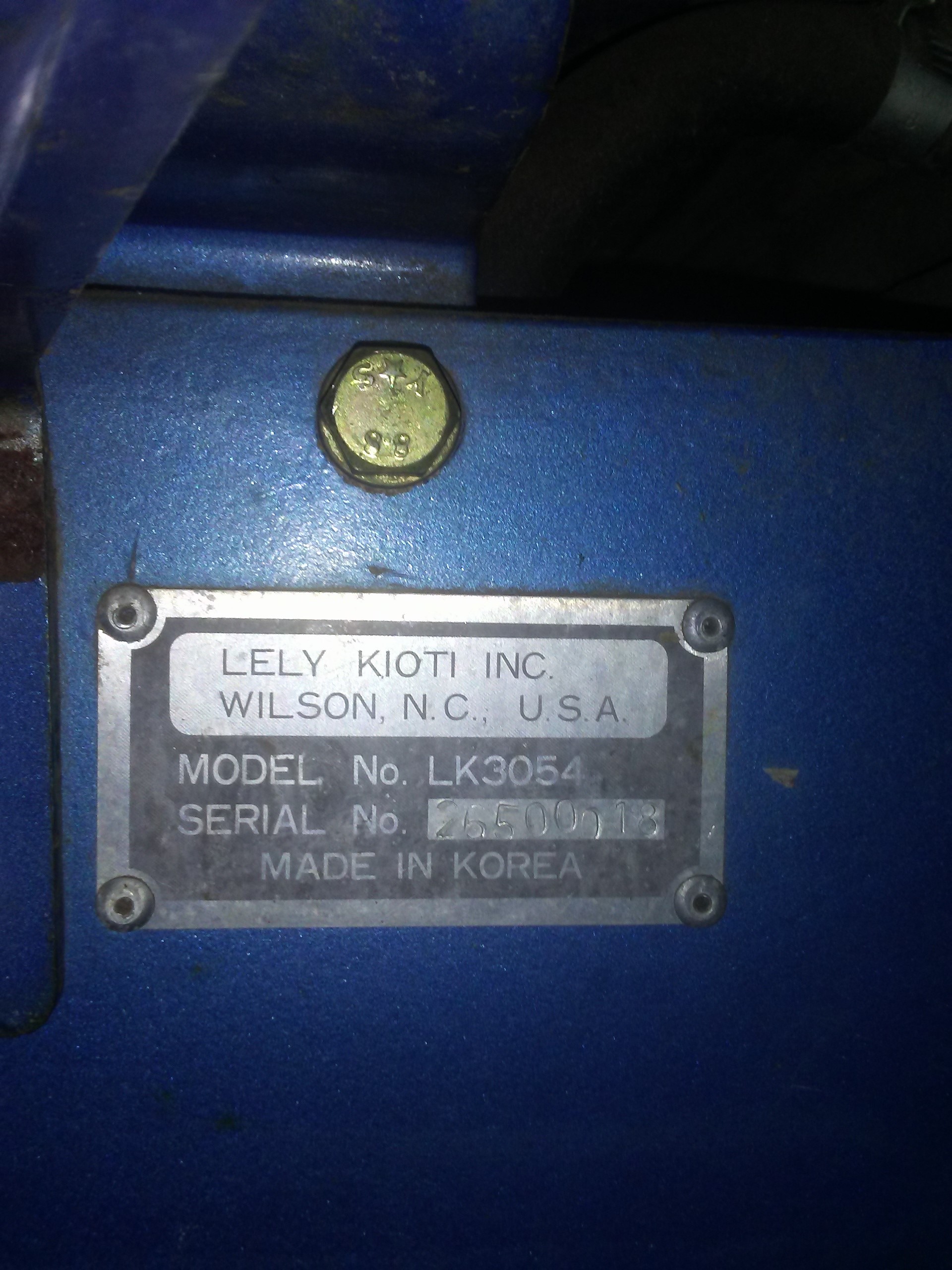

pic of where I think yours bolts on.View attachment 640878
That is where it goes for sure. Looks like it was never installed. Here is a bad picture behind the pump that shows how the pump is mounted to the hump in your picture.
Sorry for all the dirt and bad picture but it is dark so hard to see.
   / kioti lk3054 starves for fuel when it warms up. #26
I marked your picture to show where it goes. I forget that I replaced my engine and it is a later model than the tractor. I still have the old one with the original pump. I will look tomorrow afternoon and see if the lift pump is there.
