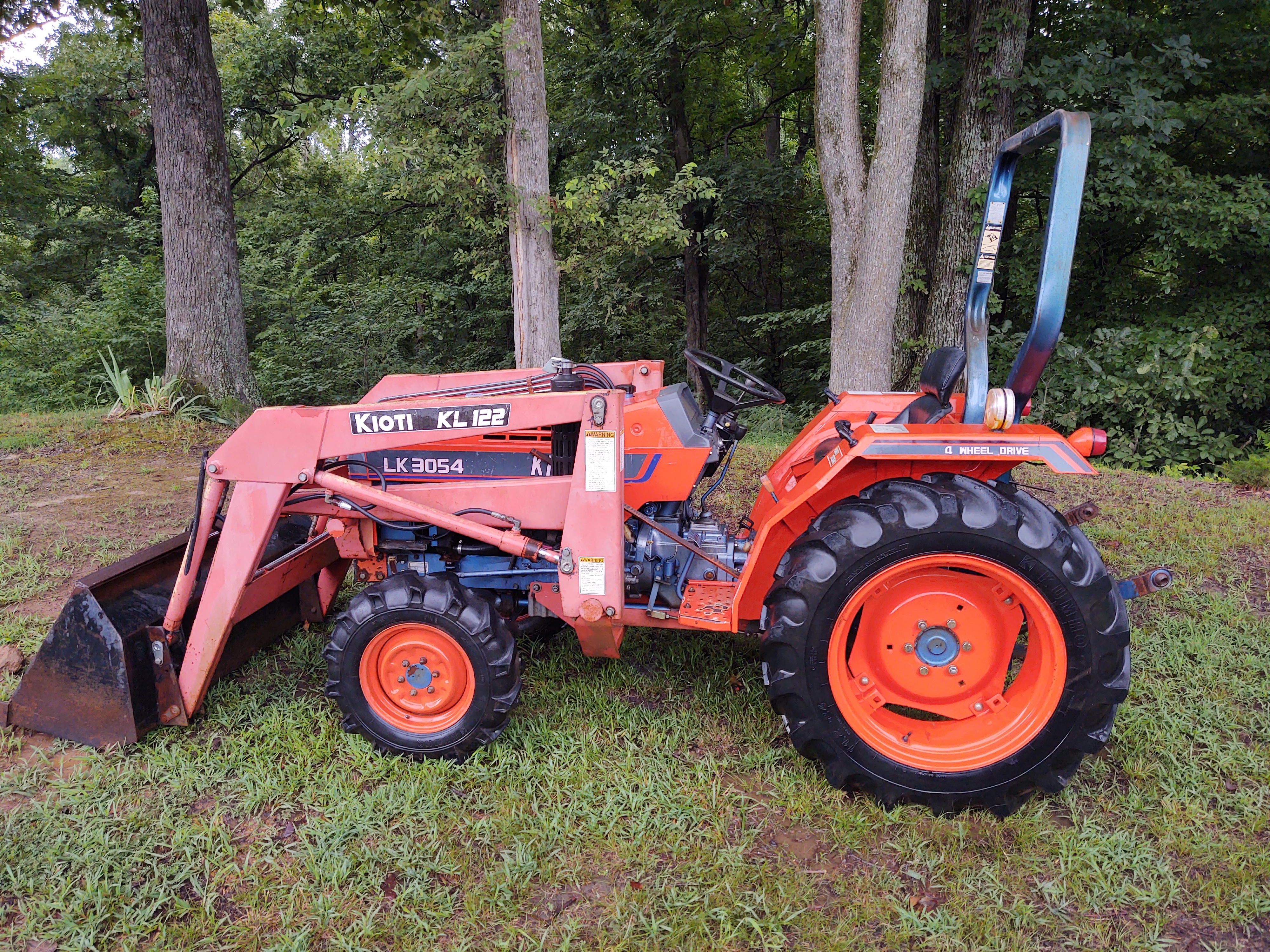

I measured the clutch free play incorrectly from the step to the bottom of the clutch pedal (½ inch). Today, I found in the manual the correct way. It was a little over an inch. Now it's about 1.2 with the end of the rod about ⅛ inch inside the yoke.
When I drive the tractor and increase the rpm's, it does not go any faster, the engine just revs up.
I did grease all the fittings on the tractor and the FEL liberally. I sprayed all the various cable linkages.
I will change the coolant today. I cannot change any of the other fluids because I do not have any filters.
I was hoping that the free play adjustment would take care of the clutch slipping problem.
But I knew going in that the clutch probably need would need replaced and had that figured in the budget.
Again, thanks to all for your advice and help!!
Photo of tractor:
/ Kioti LK3054 #20
Thanks for the update. Yours looks a lot better than mine. Clean tractor. Congratulations on a great deal, you should have no trouble at all getting you money back if you ever decide to sell it.
