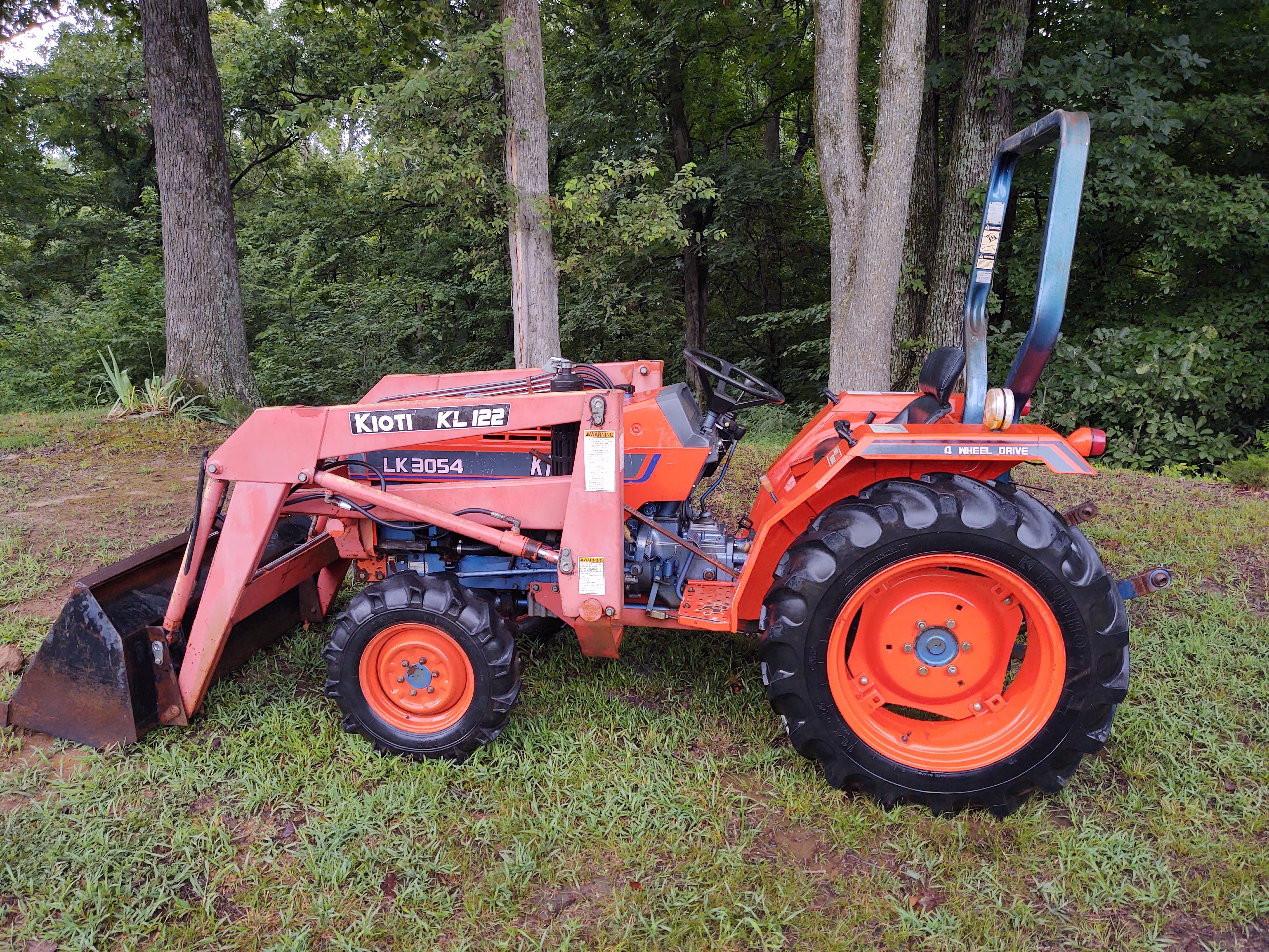

Got the Kioti LK3054 home tonight and measured the clutch travel (free play), it was ½ inch. It was getting late when I checked it. Will adjust it tomorrow and see if there is any improvement in the slipping.
Thanks to all that offered suggestions. In this tractor business "I have not seen the football since the kickoff". I know nothing!!
   / Kioti LK3054 #17
To little free travel means the pressure plate does not fully release (poor contact between the clutch and flywheel—aka clutch slippage). Too much free travel means the clutch does not disengage—grinding gears.
   / Kioti LK3054 #18
I had special clutch material put on mind at 750 hour mark the clutch gave out linings burned up due to oil leaking from poor sealed plug from factory. Tractor was 1995 model clutch lasted until 1999. Fort Wayne clutch put on better material - after that all was well until I sold it at 1986 hours in 2019. Still running great with new owner no issues whatsoever. I also had to modify loader harness it was a KL122 it must have been the lightest gage material ended up adding support gussets to handle the loader it self. No complaints again it was robust tractor overall. Gladly own another if right deal came along.
   / Kioti LK3054
#19
I measured the clutch free play incorrectly from the step to the bottom of the clutch pedal (½ inch). Today, I found in the manual the correct way. It was a little over an inch. Now it's about 1.2 with the end of the rod about ⅛ inch inside the yoke.
When I drive the tractor and increase the rpm's, it does not go any faster, the engine just revs up.
I did grease all the fittings on the tractor and the FEL liberally. I sprayed all the various cable linkages.
I will change the coolant today. I cannot change any of the other fluids because I do not have any filters.
I was hoping that the free play adjustment would take care of the clutch slipping problem.
But I knew going in that the clutch probably need would need replaced and had that figured in the budget.
Again, thanks to all for your advice and help!!
