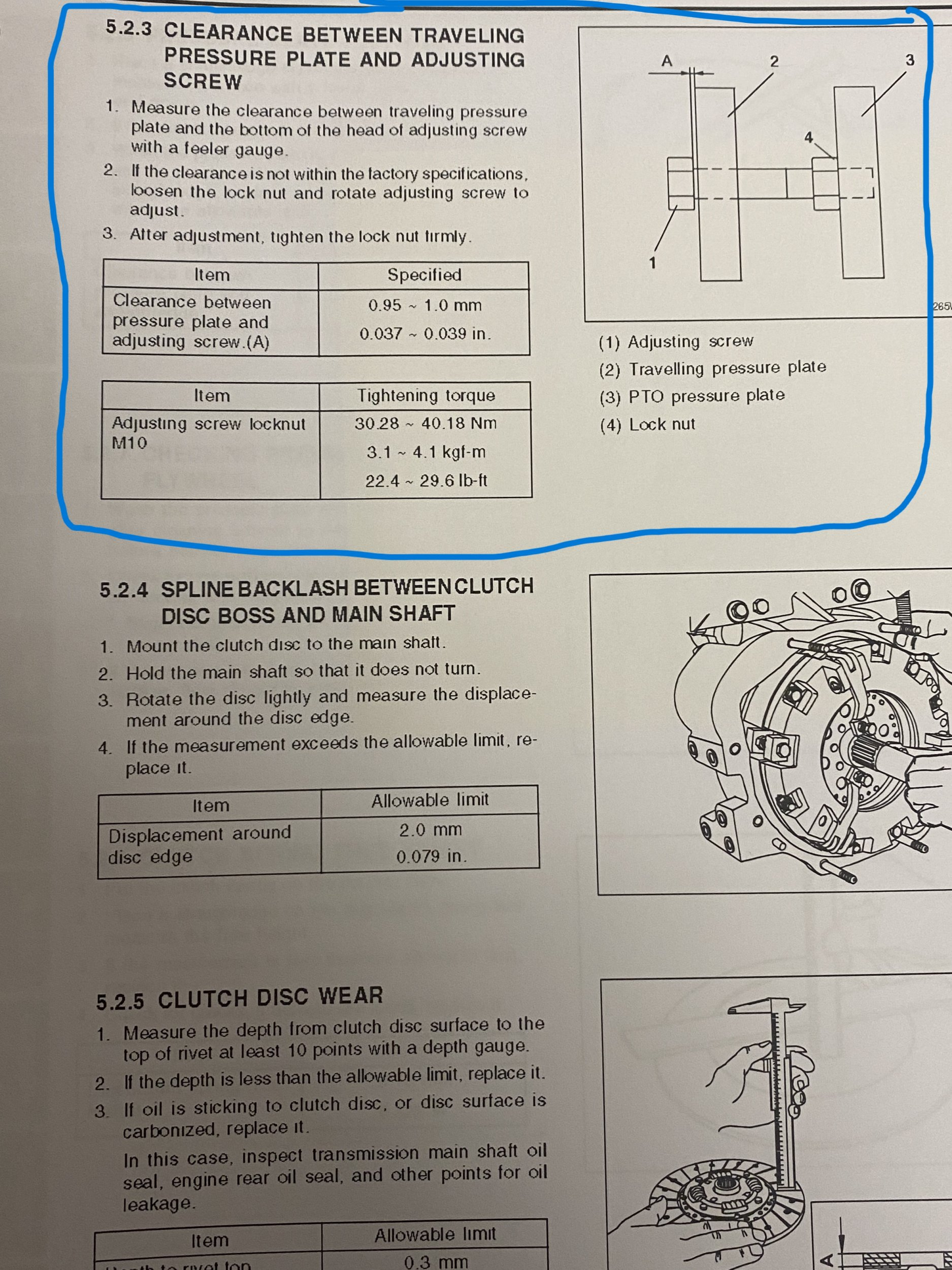

Thanks Rodney!! Looking for some instructions on how to adjust that clutch. The manual is kinda informative, but i removed the two inspection plates down my right foot and could only see the top or bolt head of the adjusting screw and it is WAY out of adjustment. Looked like a 1/8 or .25"gap and should be no more than .039. The instructions mention the need to loosen the lock nut on the adjusting screw, but there is no way to reach it. I could not find any videos of my LK3054 to review.

Thanks Patches. If I understand this correctly, I'm not trying to adjust the fingers. I'm trying to adjust the clearance between the travelling pressure plate and the adjusting screws. The gap they call for is 0.039" at the most. The gap i saw last night was .25. My problem is i believe i can see the head of the adjusting screw through the inspection plate i removed. But there is no way to reach the lock nut. IMG_3002.JPG

Those adjusting bolts you refer to are threaded through the pressure plate "fingers". You can see the fingers with the adjusting bolts in the graphic just below the one you've outlined. These bolts adjust the clearance between the throwout bearing and the release fingers of the pressure plate
   / Kioti LK3054 #40
I had a 92 3054, and if I recall, the adjustment through the inspection plate was only for the PTO clutch. It's a dual clutch system. Partial movement disengages the PTO and full movement disengages transmission and drive gear. There was no 'external access' to the traveling clutch adjustment. My PTO would not disengage, and the adjustment bolts were impossible to get to through that access plate. Your year may be different. I rarely used the PTO, so I would just take it out of gear when I wanted to stop augering.
