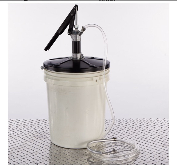

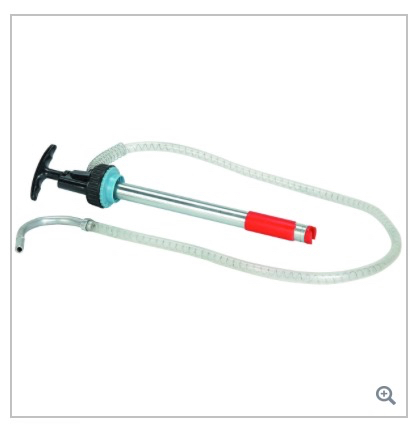

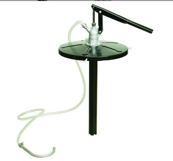

Here are a couple of pumps for five gallon buckets that I use, both gear lube and hydraulic fluids. 5 Gallon Oil Pump

Thanks countrybumpkin! I'm going to hit up HF tomorrow to see if they have the pump. If I remember correctly, last time I used one of those red pumps and it was a mess! Still wish I could find it.. I've got to much junk around these days with the kids and what not... I've kids toys stacked up and I can't get to anything to even look.

I used a HF pail pump like shown in post 42. I recommend you have a couple small hose clamps on hand for the clear hose. That hose will leak at both ends with stock clamps (just wire wrap) if you pump vigorously. It takes a lot of strokes but isn't hard and not messy if you re-clamp the hose ends.
