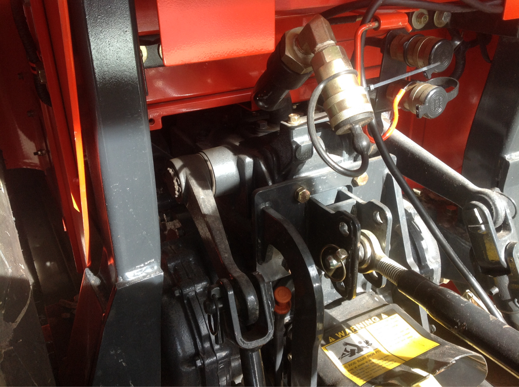

If your dealer installed the dump kit for the backhoe return,you can remove the QA connector along with the elbow and nipple and fill the hydro fluid from there.
It's a lot easier than pouring almost 8 gallons through the dip stick hole.
/ Kioti Maintenance
#34
Mine doesn't have that. There are four remotes on the back, the same ones you have on the right and then the same thing is on the left side.
/ Kioti Maintenance #35
Where does your backhoe return connect to the tractor? One of the remotes?
/ Kioti Maintenance #36
Some return at the remote and some return to the fill hole as seen in the photo of post #34.
/ Kioti Maintenance
#37
Mine returns at the remotes. I have four quick connect ports on the back, two on the right side and two on the left side. The left side has a valve control that has a detent that keeps it open for use. The right side has a valve that you would need to hold the lever or bungie cord it on. So I use the left side and just flip the lever and away I go.
