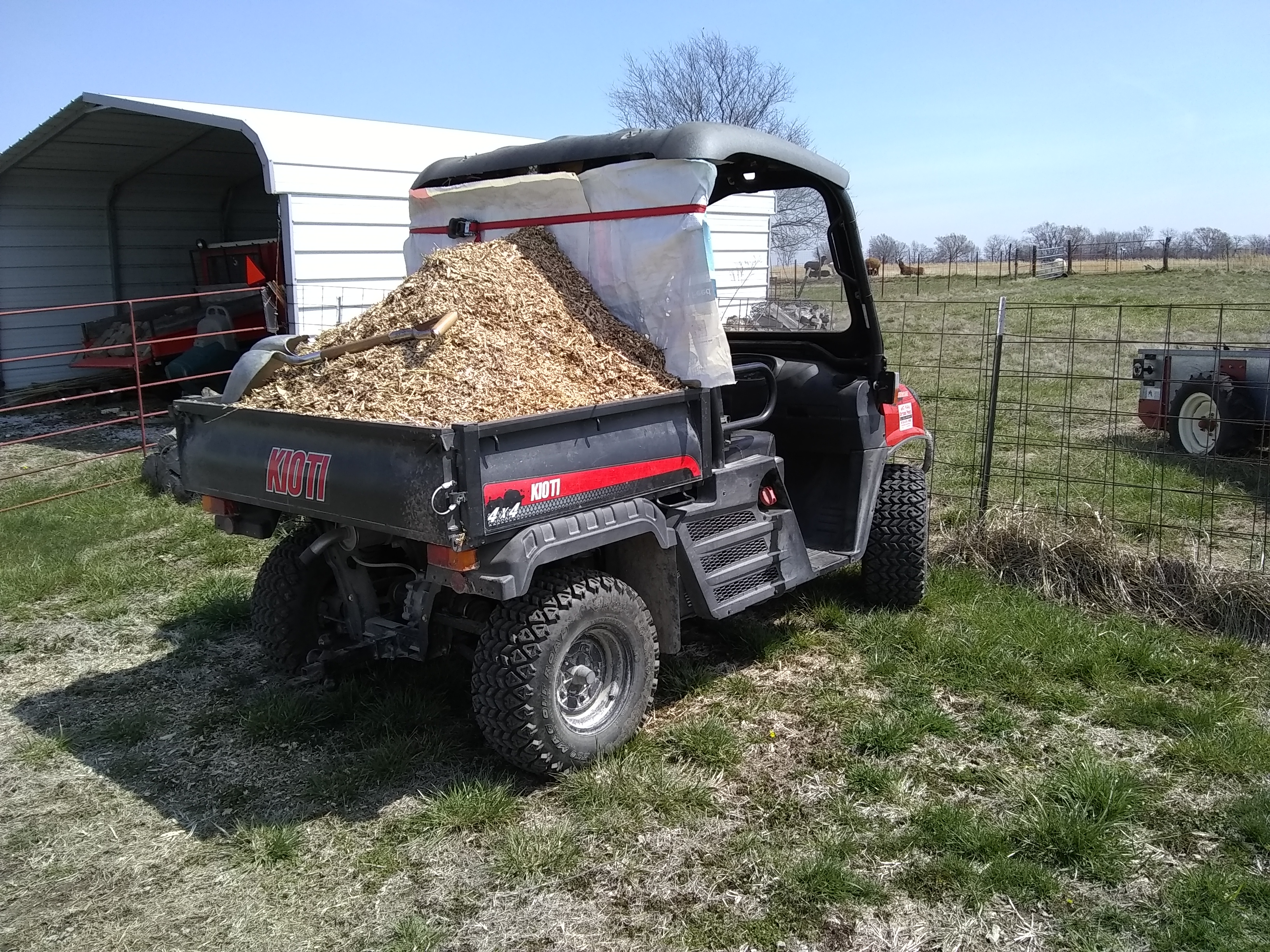

I wonder if the flywheel is to heavy, generally don't have a problem with getting started but diffidently not an inching clutch. 75 hours on mine and when cold it is toucher than I would like. If any one gets some information on adjust the clutch pass it on. Thanks IMG_20180410_121025122_BURST000_COVER_TOP.jpg.
