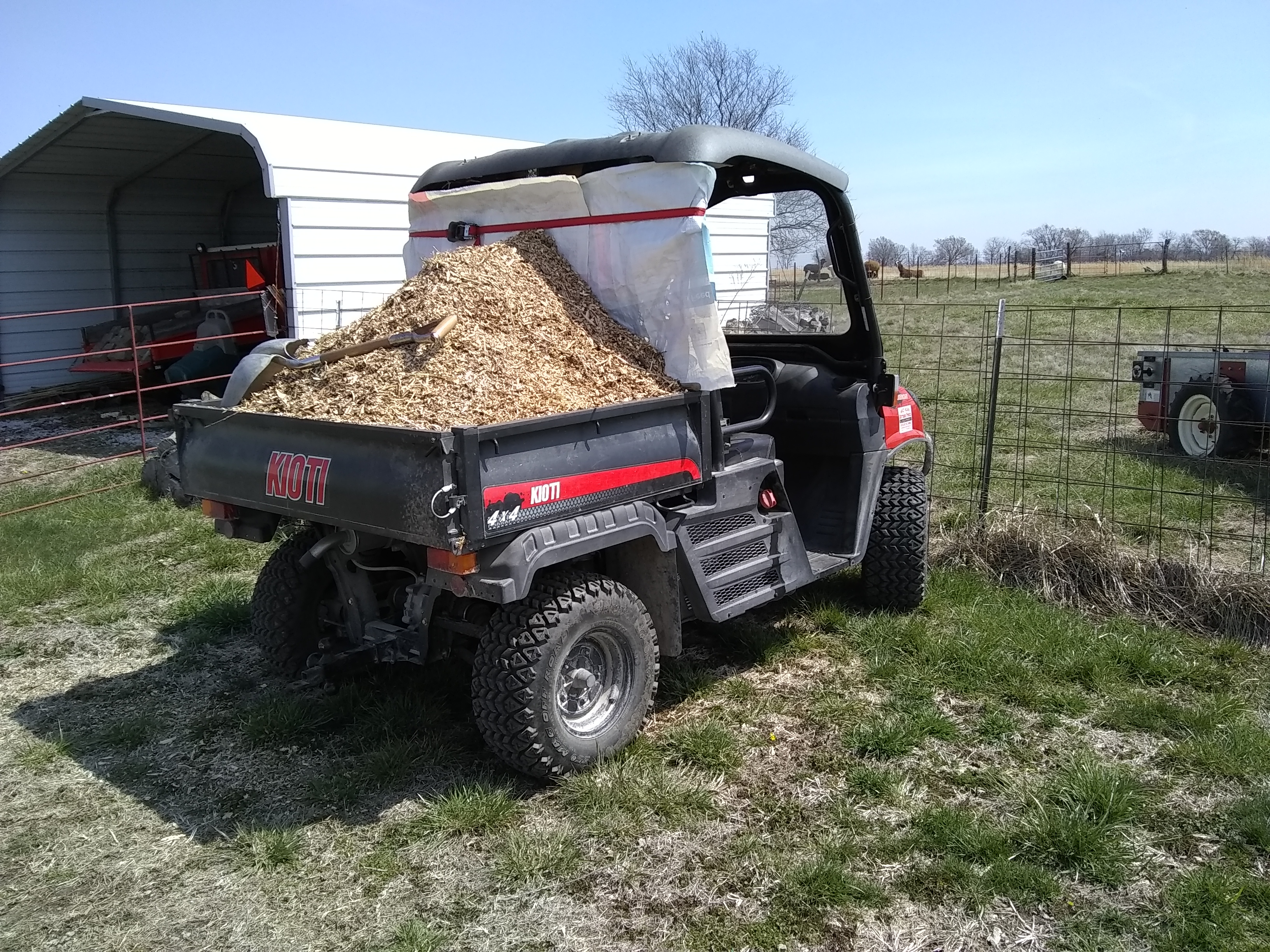

Easy way to up the capacity of the bed by adding a couple of feed sacks. Chips are from a woodmax 8h chipper. IMG_20180410_121025122_BURST001.jpg
