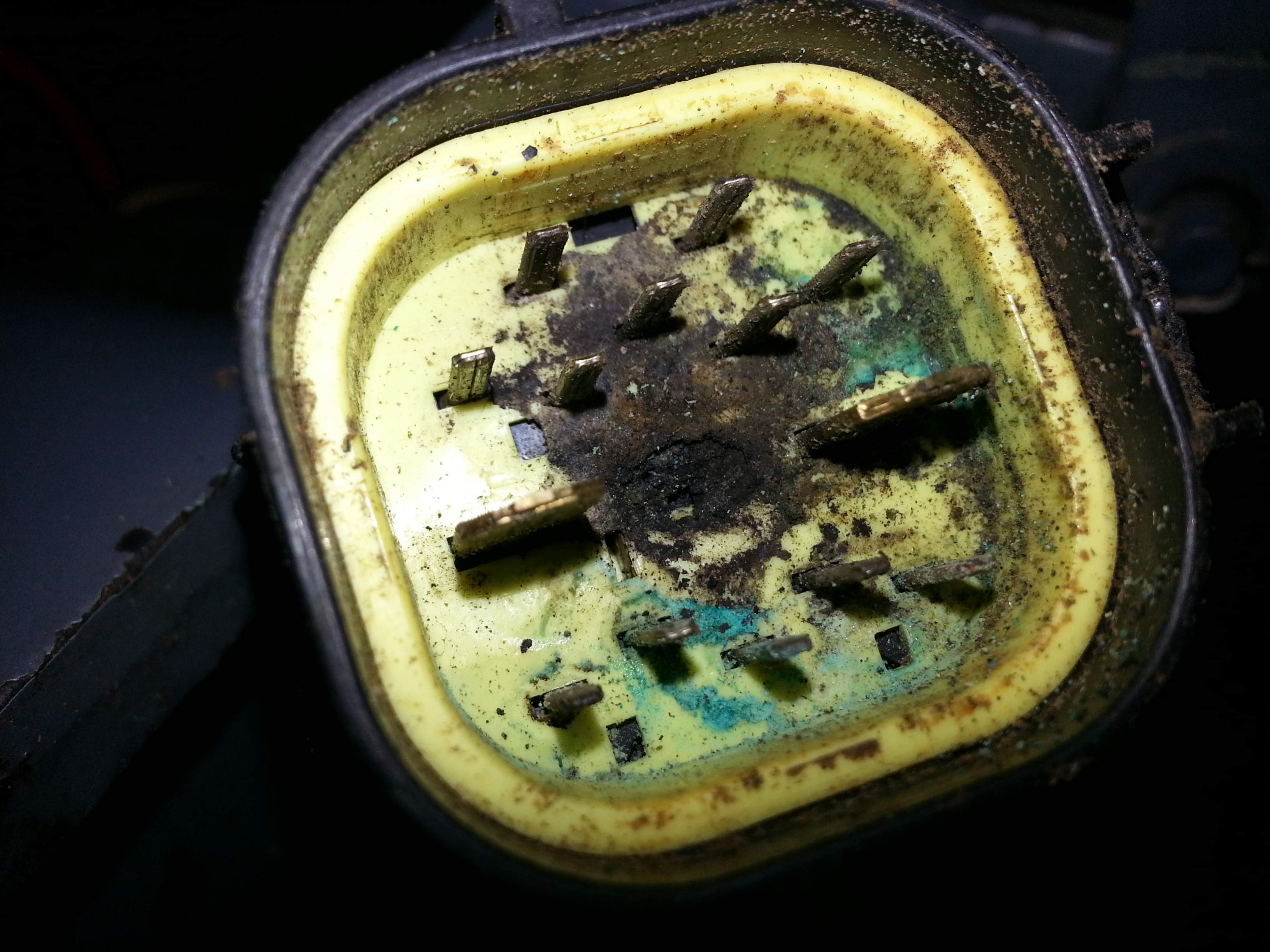

Couple of things: Glad to be of service. Your battery should not read over 12.xx volts with the engine off.
How do you think the connector(s) got the way they are? Immersion in water?
With battery disconnected I'd use a brass brush to get those male prongs as clean as possible and see what you can do with the female socket connector with electric contact cleaner.
Post back pics of clean connector before re-installing it so we can see it.

Water emersion is most likely from the farm....I think my meter is broke because it read 15.75 on my truck battery....I will do the cleaning in the next week as time permits....

Ok...Today I cleaned the contacts and put some dielectric grease on and put them together. Still no luck....So I started from the top and re-checked everything again. Low and behold the 60A fuse was blown (i know I said 30A before, but I didn't have me glasses on). So I replaced it and poof...It works....When I look at the old fuse i couldn't tell that it was blown because there was no indicators like black or discoloring????

It looked like you had some arcing in that one connector That is likely what blew the 60 amp fuse the first and second time. When you cleaned it up, and replaced the fuse the second time... your good to go. Hopefully all of the corrosion and arcing is behind you, and you will stay fixed.. if not..go back to the connector, and decide what to do from there.

Back to the drawing board. I started to use the Kioti and in about 5 minutes blew the fuse. Pullin my hair out?
/ Kioti No start #32
This really sounds like a short circuit somewhere, perhaps a chafed wire, Fuses tend to blow fast, unlike circuit breakers that require high current over a period of time. I would (first buy a bunch of fuses) use the schematic to identify any unnecessary circuits that can be disconnected by unplugging connectors and pulling fuses, In this case the only "necessary" circuits are what you need to start the tractor (starter and glow). Once you pull the plug on all the unnecessary stuff (lights, radio, etc.) use the tractor and see if the fuse blows. If it does the problem is in those few remaining circuits and you've narrowed it down. If it's OK running just the starter and the glow system add the disconnected circuits back ONE AT A TIME until you find the offending circuit. When you isolate the problem to one or two circuits examine the associated wires carefully until you find the cause.

Seems you have a dead short in the starting circuit for some reason. You're going to need a few more 60A fuses to get this under control- don't give up, we'll help you get it.
I suggest you start back at square one and go over everything again. I suspect you may not have effected a clean connection at the connectors under the floor board, so check for any arcing or bent pins, etc.
Just took a look at the male end connector you shot a pic of. I am thinking maybe a pic of the female end would be useful for diagnostic purposes. I suspect you may end up having to replace both connectors to solve a part if not all of your blown fuse issue(s).

For purposes of eliminating certain simple locations of possible mouse/rodent caused shorts, remove the fuse block and check the back of the block and it's wires for any visible damage. Tug on each wire from the block's back and verify each wire is intact upstream of the panel. Do same to ignition switch backside.
Report back results with pic of female underfloor connector.

Ok I'll check the connection again...Can someone post a "perfect" male connection. I'd like to see the difference. Specifically, is there a prong in the dead center.

Can you determine that by looking at the female end?
