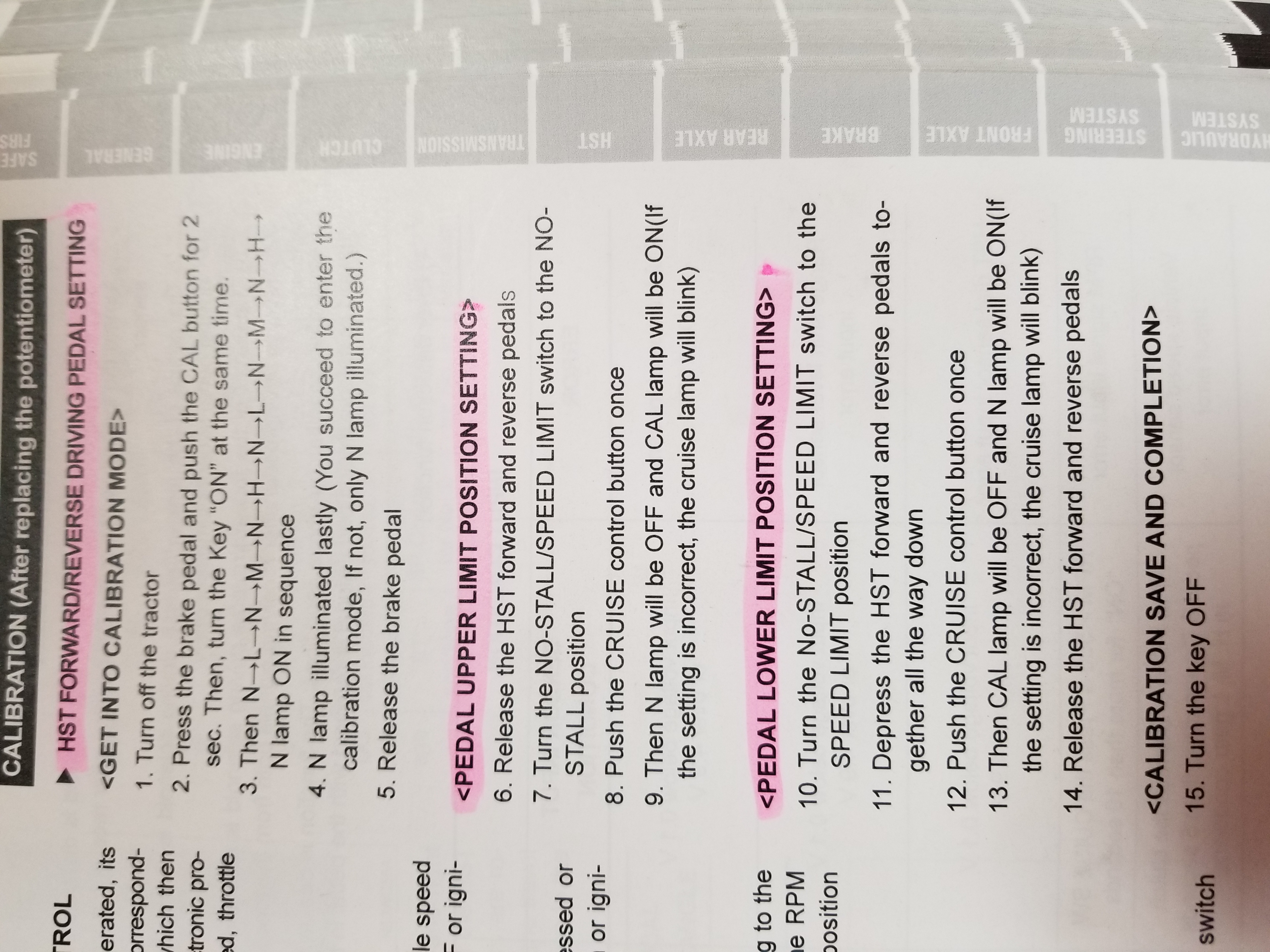

Service Rep. came to my house, and simply re-calibrated the computer. It took him about 5 minutes. This is done with the tractor turned off. Through a series of special sequence of buttons and levers, IE (depress brake pedal, push the CAL button, Key On, then Neutral, to Low to Neutral to Medium, to Neutral to High) Etc.... Finally Key Off, to save. Unit is now AWESOME!
Good to go! May want to keep the calibration procedure handy in case it happens again.
Here you go.
