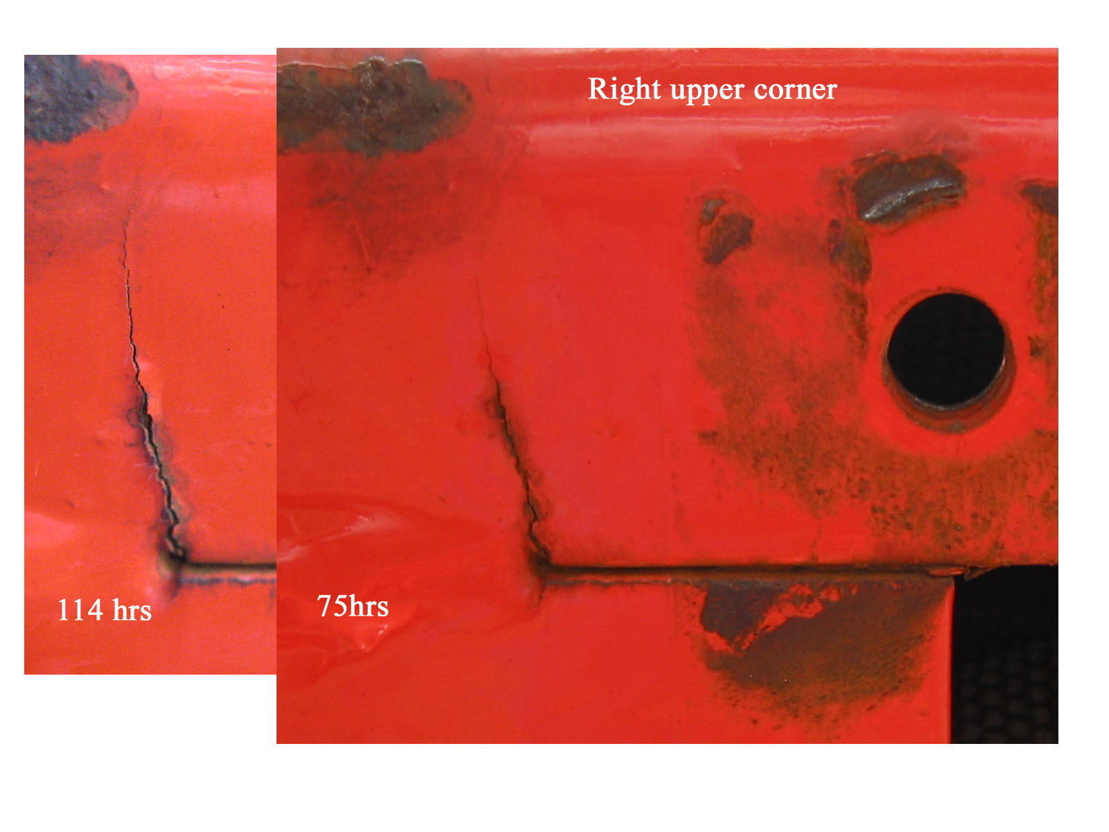

Well, to get back on topic here. I just pulled the inspection plate off my KL120 loader again. First time I checked was at 75 hrs (June) and there were cracks in all four corners. Since then I have put on about 40hours with a good amount of FEL work. My FEL work since 75hrs has been exclusively grapple use and I have used it agressively but have not abused the FEL. Mostly lifting brush but also digging out roots, knocking over small trees (3" or less usually) and sometimes digging out bigger half rotted stumps. The FEL continues to function normally.
At 114 hours, the cracks in all four corners have all extended, most by about half an inch since 75hrs. I will post other photos but so far I've just made one composite with same scale 75hr photo and 114hr photo juxtaposed. I'm not sure what the conventional way of referring to the different corners is so I've made up my own convention: I label them from the drivers perspective with FEL raised so inspection plate is at eye level: right upper means that when you in front of the FEL looking at the opening it is the left side upper corner. The photo is of the rt upper (drivers perspective)( EDIT: ignore the photo filename which is backwards). You can see markings on each photo that show the scale is pretty close. Note the hairline crack has extended upwards on the 114 hr photo.
I assume at some point these cracks will extend far enough that there will be more rapid progression leading eventually to failure. I don't know enough about FELs to anticipate just how or when it will fail. Kioti has indicated it is OK to continue to use the cracked FELs but I am a bit concerned that the repair will be more difficult and perhaps less satisfactory if the cracking continues. I also wonder about the safety issue with the possibility of a sudden failure. Not such a big deal I suppose if it fails while lifting something but if it occurs while traveling with a load and the failure causes a load shift it could potentially tip the tractor over. I always wear a seat belt but it still seems like a safety risk.
I may sound like a broken record with my constant harping about Kioti's lack of communication and more than 3 month delay in providing any news on the repair program but I think this new extended cracking data deserves some response. Some have mentioned that Kioti monitors TBN but I'm not so sure. Perhaps one of our TBN savvy Kioti dealers could go through back channels to get the company to let us know what is happening with the promised repair program.

That is less progression than I would have thought, given the use you've described. I know, not being a Kioti owner (and one with this issue) but, with the faith in the companies word (that this WILL be addressed) that the dealers here have expressed, I don't think I'd be concerned. I'd follow up with my dealer occasionally but, that's about it. It appears most owners are getting good use out of their tractors in the meantime. I realize not every Kioti owner may have as good a dealer as those that contribute here but, they (the dealer/ TBN contributers) have stated emphatically that it'll be taken care of, I'd take them at their word and go about tractoring.
