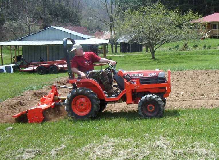

I have the exact Kioti tiller you are looking at. It is a quality Italian made tiller that has outstanding quality and finish. I run it behind my Kubota B1700 Hydro. The combination of the tiller and a hydro tractor just makes a tough job effortless.
The only thing negative that I have encountered, is the fact that it will not till deeper than 6" or so due to the skid placement. Check the maximum tilling depth to see if you can live with this.
Still beats trying to wrestle with my old Troybilt though!
Attached is a picture of the spring garden plot after one pass with the Kioti tiller and the Kubota in action.
Thanks
Bill
