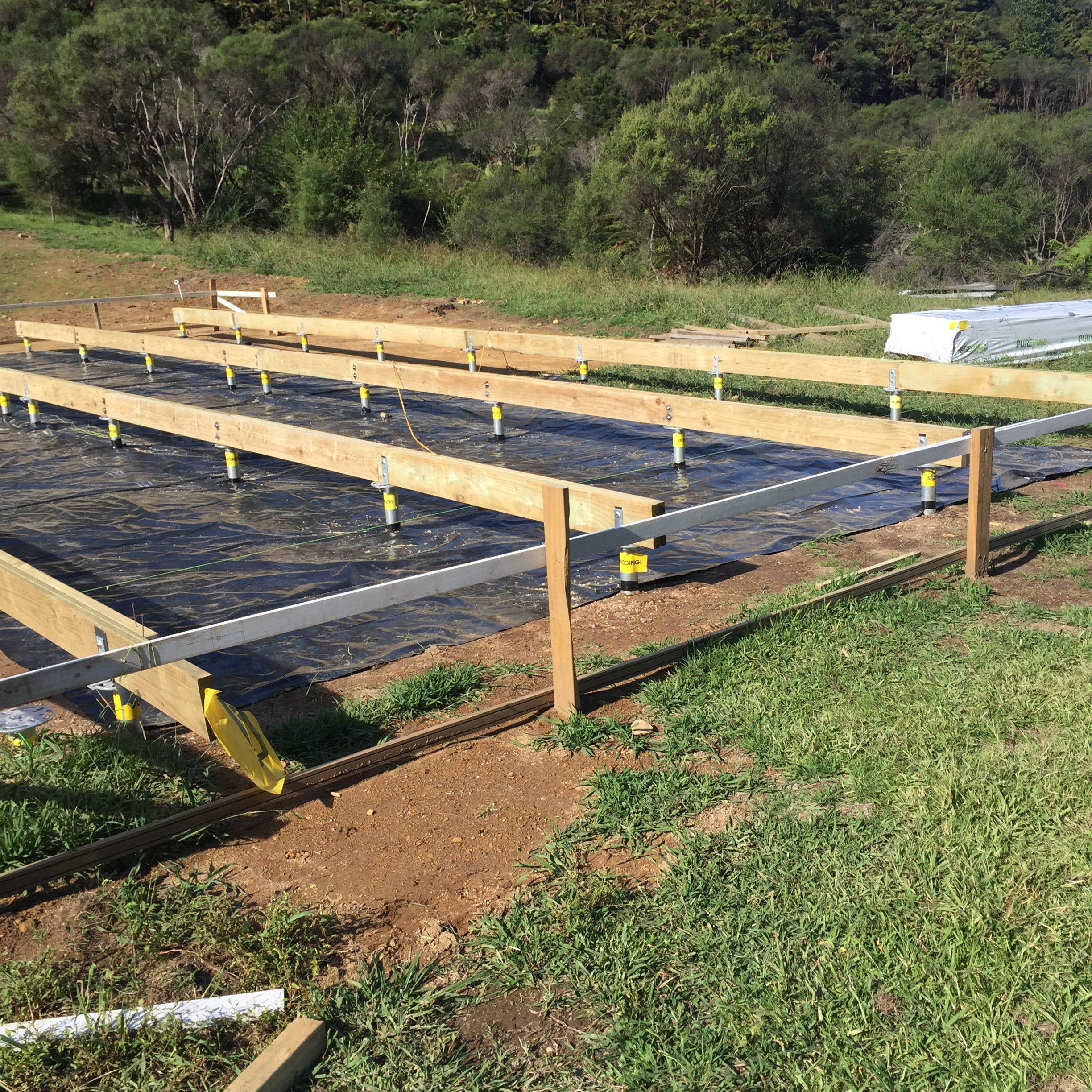

Got all the bearers cut and bolted down today the building code here is ridiculous in my opinion a lot has changed since I last built 15 years ago

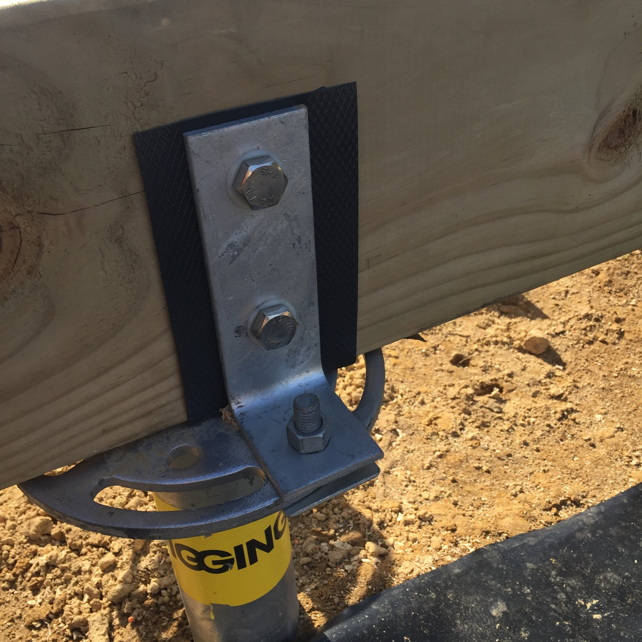

on this job all the connections between Galv brackets and treated timber need a
layer of plastic DPC between them I have to use stainless steel bolts but any connection between stainless and Galv needs a nylon washer between the stainless bolts must have nickel based anti seize do the same rules apply over in the states?

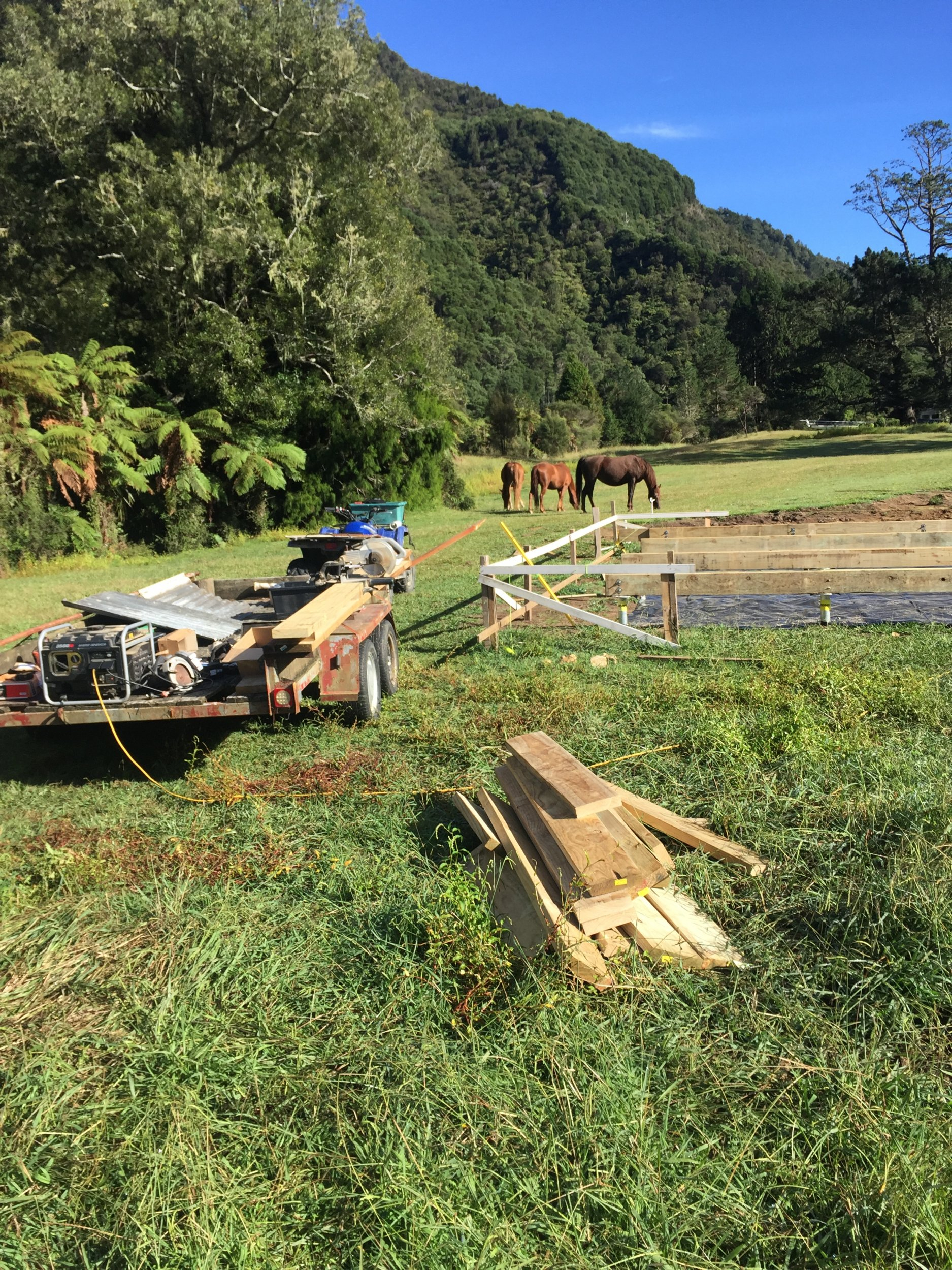

Ive set up an old trailer to carry tools and added a bench for my drop saw on the edge of it so all the tools the generator drop saw are all on it at the end of the day I just hook up the quad bike and park the whole lot in my shed half a kilometre away
   / Kiwi building a Scandinavian house #24
Very impressive, but it also looks, very expensive. I can't comment on all of the materials used to meet Code since I've never seen anything like this before. Where I live in East Texas, there isn't any Code outside of city limits, and inside city limits, it's different for every city.

@timbatrader That's both code and good building practice hereabouts. When they switched what went into the treatment chemicals that go into pressure treated wood, it triggered a big change in what an allowable fastener was. Use a regular fastener and it will be gone in a year or two if the wood gets wet/damp. I will say that for folks homebrewing their construction, many of them aren't aware of the changes until their construction starts coming apart.
So, yes, necessary, and worth doing whether it is "code" or not.
Gorgeous photos, and I like the moving work platform that doesn't require a full breakdown at the end of the day.(y)(y)

Here the fasteners need to be "hot dip" galvanized. There are other approved coatings but I'm only aware of this on screws, both timber and regular construction screws.
It does seem that your codes are extreme particularly in your situation where no additional direct water should ever see those bolted connections. That is where the bulk of "normal" treated lumber is used here, such as an attached deck or exterior staircase and I think that's the corrosion concern where constant rainwater may keep it wet for long periods.

ponytug that would make sense if I were using a copper azole or Alkaline copper quaternary type treatment but I am using good old CCA copper chrome arsenate My guess they have written the code allowing for the more corrosive treatments on the basis most people can't tell the difference between CCA treatment and ACU or CuAz type treatments
CCA type treatment (still legal in New Zealand) might be bad for the environment and the workers at the treatment plant but it is not corrosive if dry and a much longer life in high hazard uses
