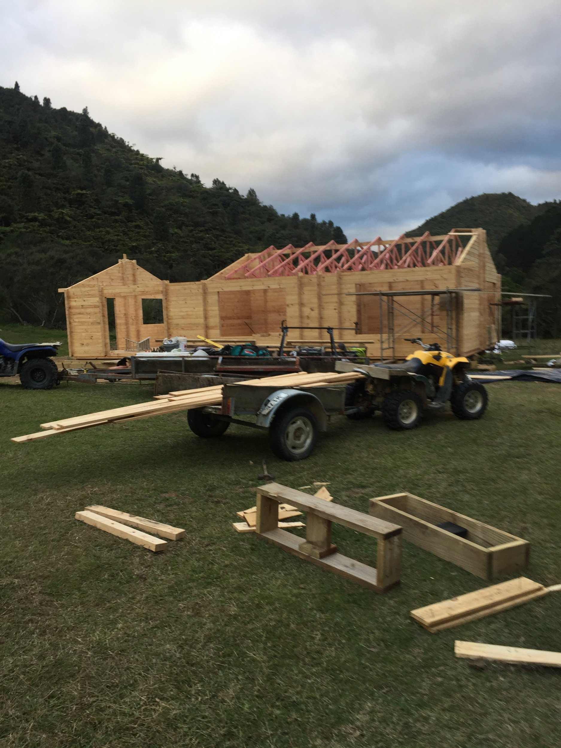

link to youtube video of where we are upto today roof beams for the lounge and truss's for the rest of the house arriving tomorrow not sure if we are going to be ready to put them straight on

We have had a lot of rain recently which is slowing thing down but we have the truss's up and the beams they were heavy things to get up without any lifting gear just three old men

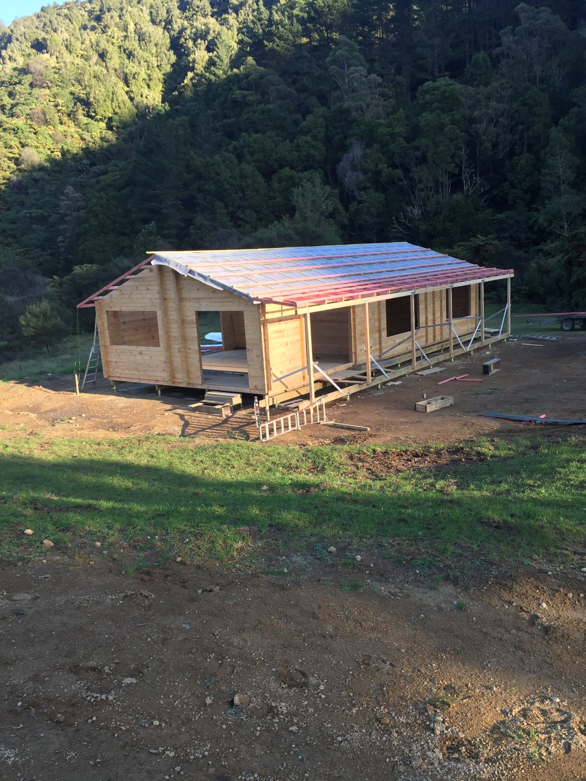

Been busy getting the roof ready this house has roof system new to me it has two layers of building membrane under a steel roof first layer is an expensive beatherable membrane directly on top of the rafters/roof truss's then a 20mm thick cavity batton then purlins conventional building membrane and the the steel

I think that what's called (here), a "cold roof". The thinking is that the air space separation reduces the house "lost heat" from transferring to the roof causing ice dams, and does basically the reverse in the summer heat hopefully keeping the house cooler also. I know that the heat is also hard on any underlayments and to some extent, the wood itself.

Ice is not a problem here we do get the occasional frost here but never any ice or snow I think the extra membrane under the roof is more about if the roof leaks there is a layer of protection to stop the roof framing getting damaged or going rotten. A few years ago after they had relaxed some of the building code to make housing more affordable New Zealand had a "leaky house crisis ". Lots new houses leaking and growing toxic mold so they changed the code again. Lots of belts & braces attitude to everything and cavity battons behind cladding so any leak can drain away and have ventilation to dry out internal wall spaces
