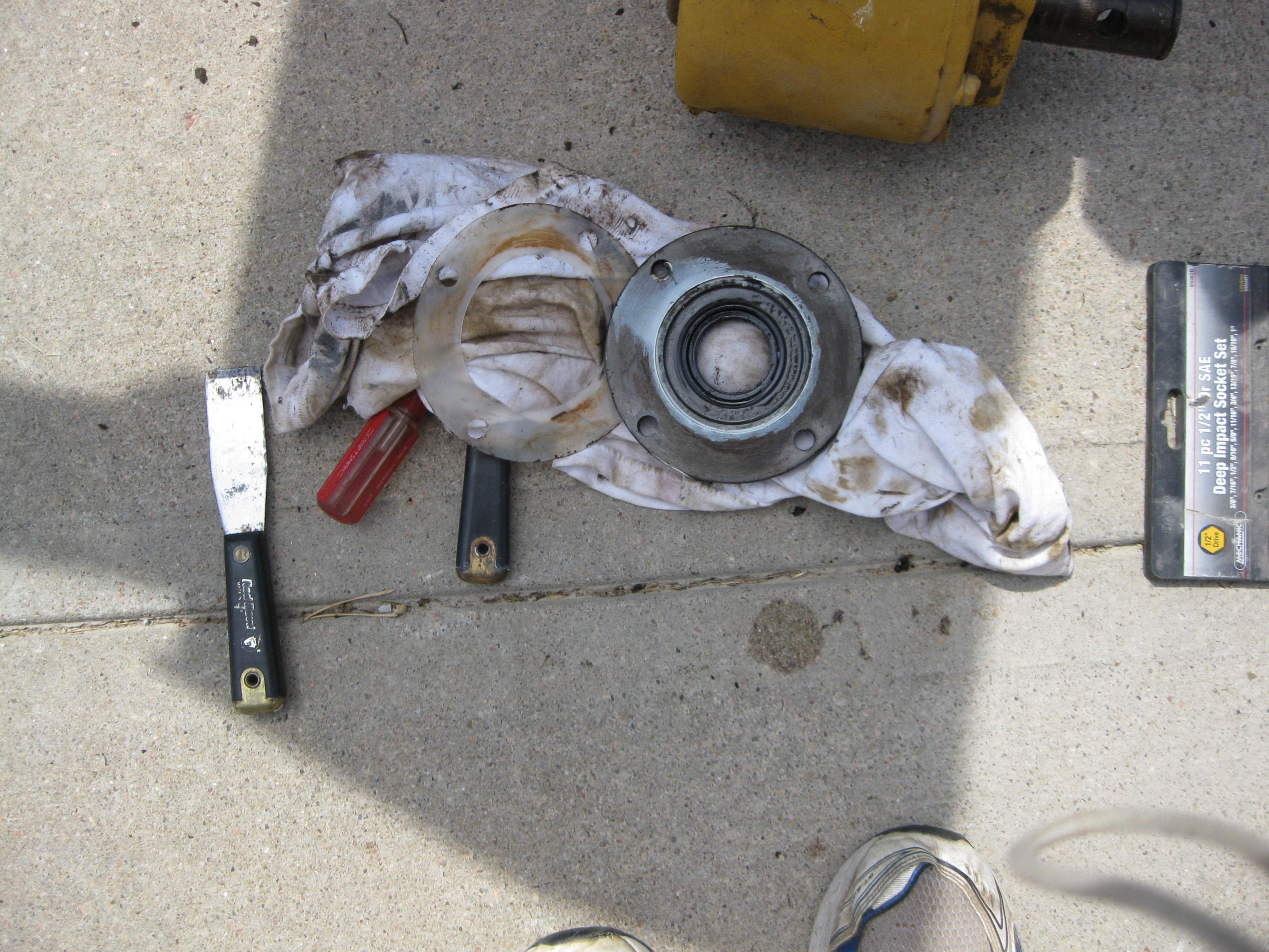

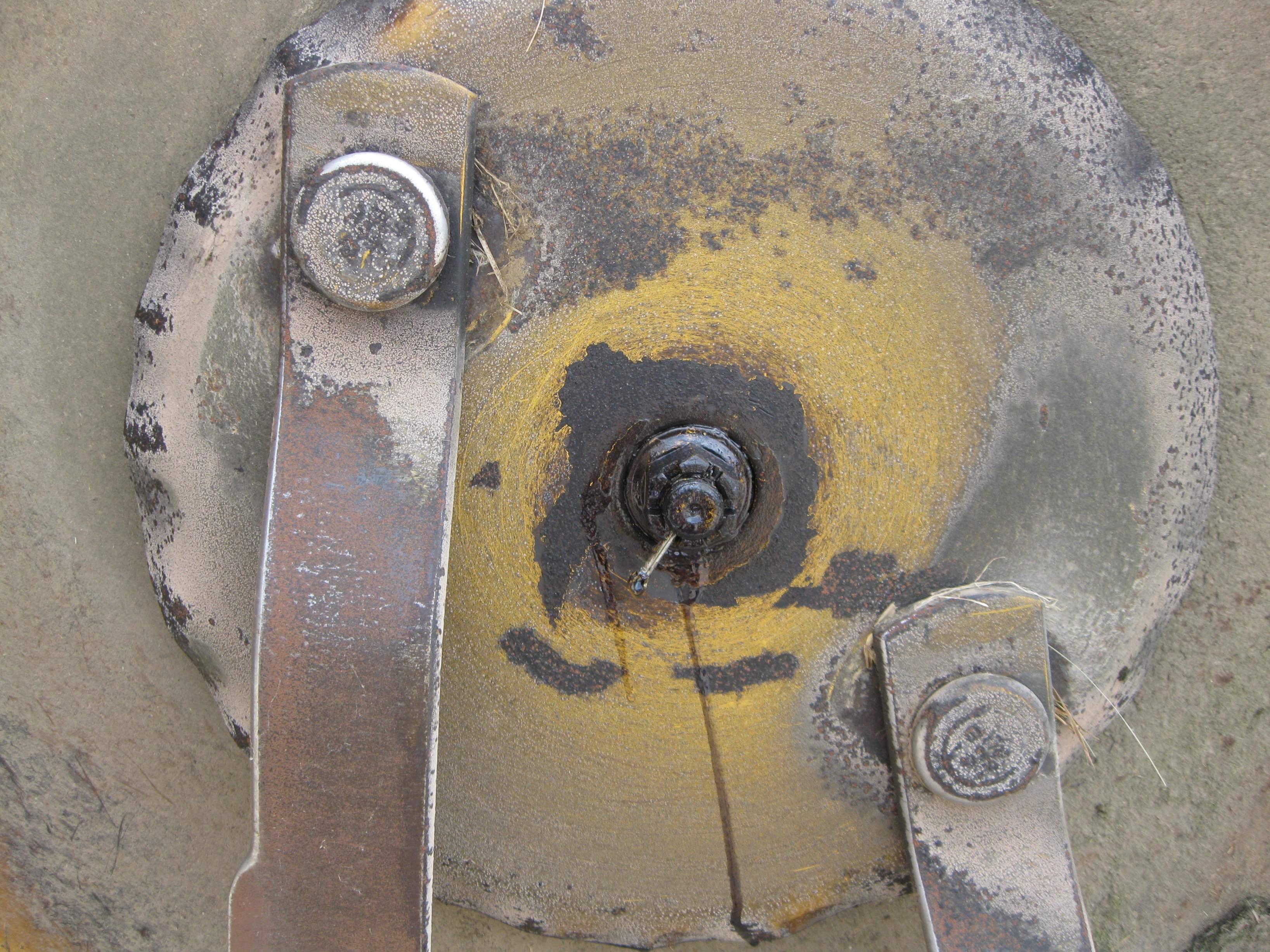

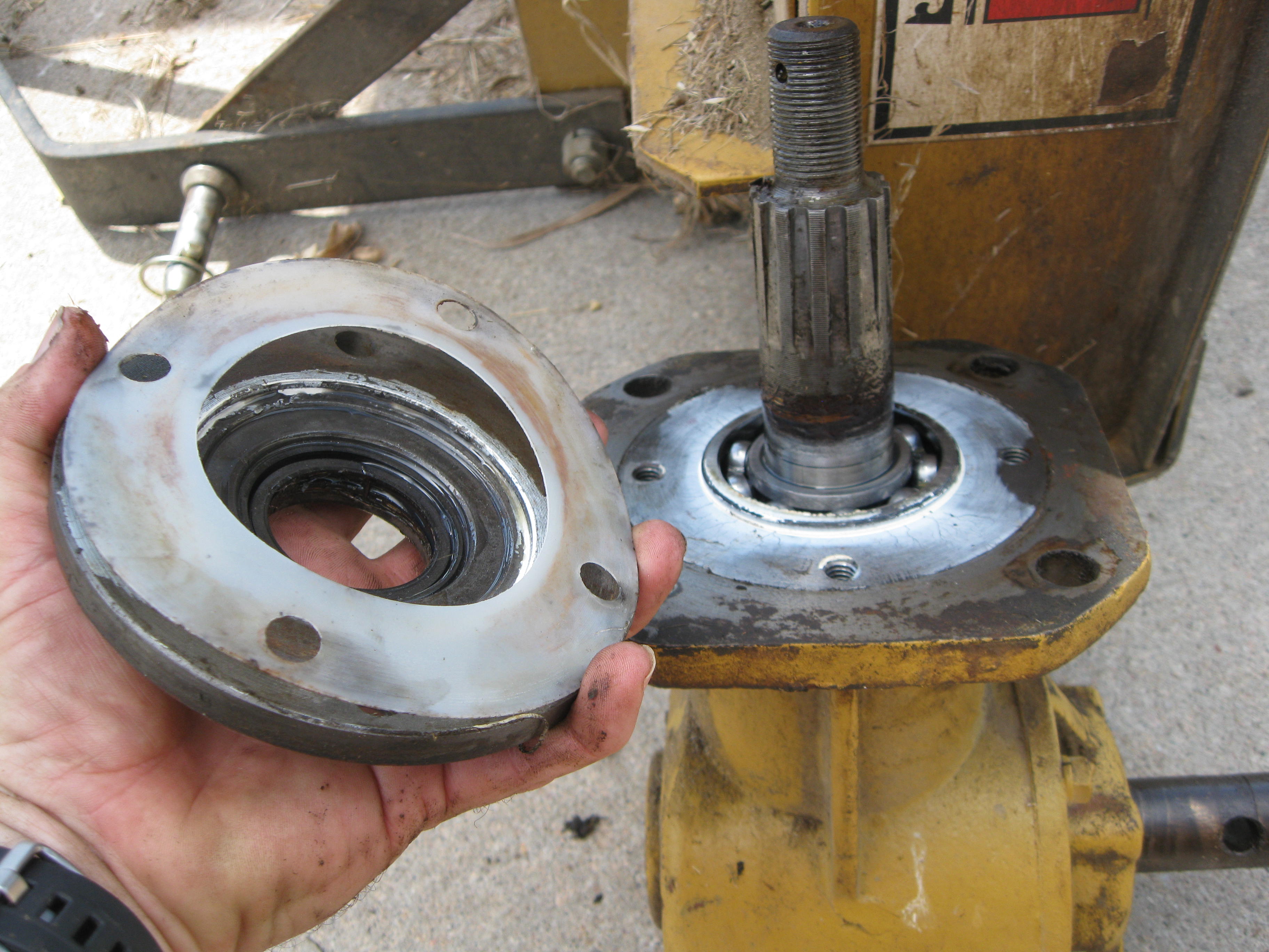

Just replaced a gear box seal yesterday. Thanks to everyone in this thread for your advice.
Here is a synopsis of my ordeal. Maybe it'll help someone in the future.

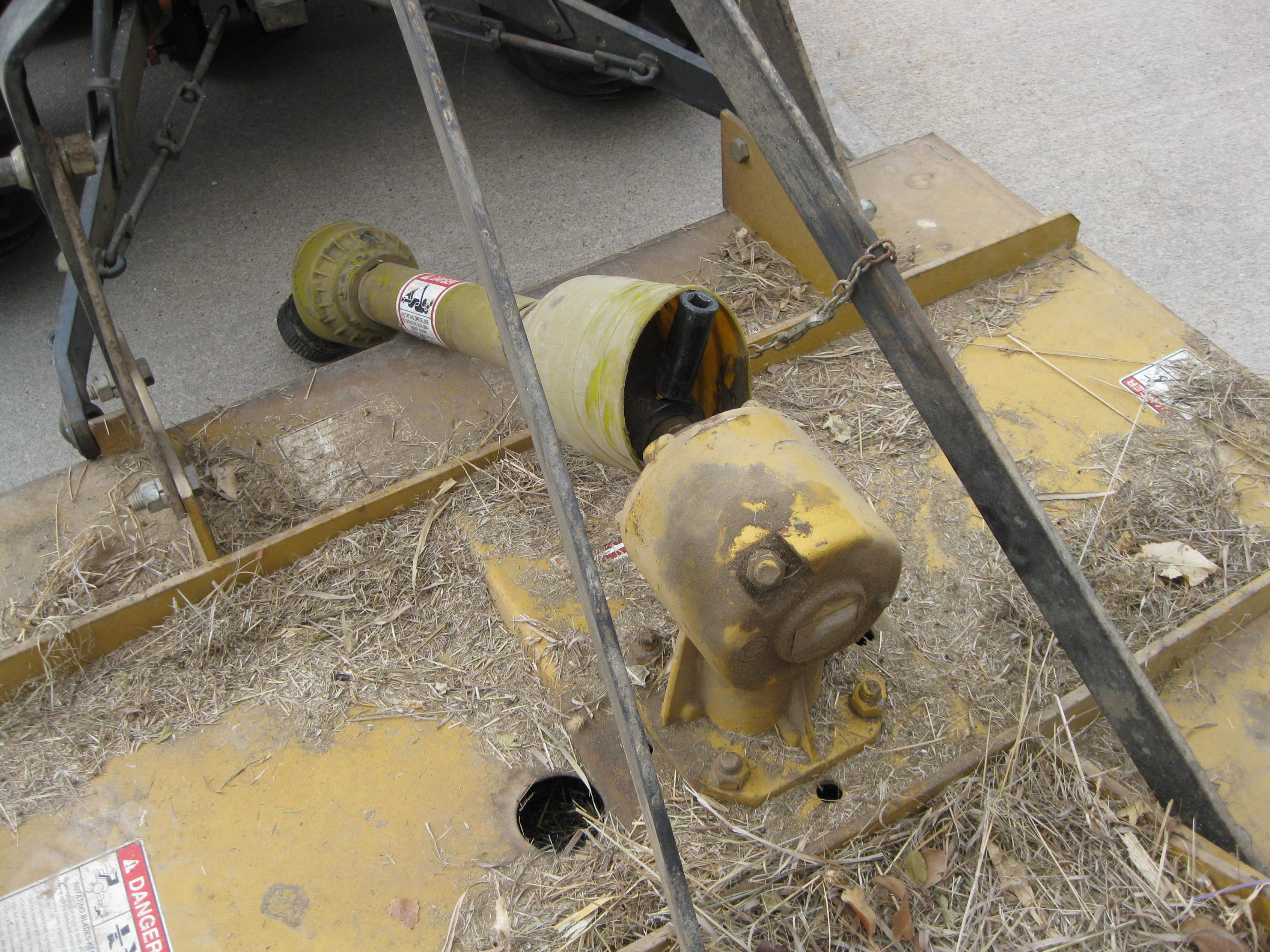

1) Removed the PTO shaft. I had to cut the shield in order to remove the shear bolt and a "C" ring retaining clip,
2) Used my loader with chains to stand the mower upright so I could access the stump jumper and eventually remove the gear box.
3) Removed the retaining nut with a 1.5 inch wrench. Luckily it wasn't on tight. It came of with a simple jerk of the wrench.

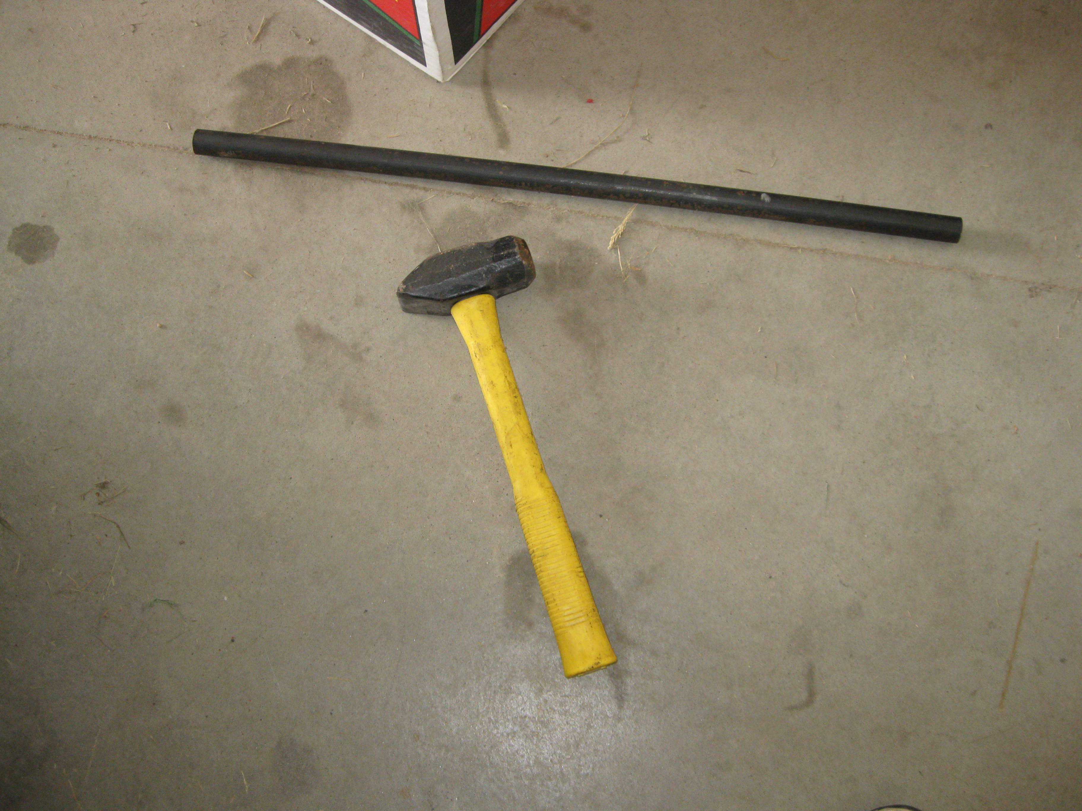

4) Removed the stump remover. First thing I did was soak the shaft with penatrating oil. I tried the chain and bottle jack method listed in the post above but it reached a point where it was not working so I decided to use some 7/8th steel rod and a 3 pound hammer. The steel rod was placed through access hole in the deck. To my surprise, on the first whack the stump jumper broke free. The chain and bottle jack were still applying pressure when I whacked it.

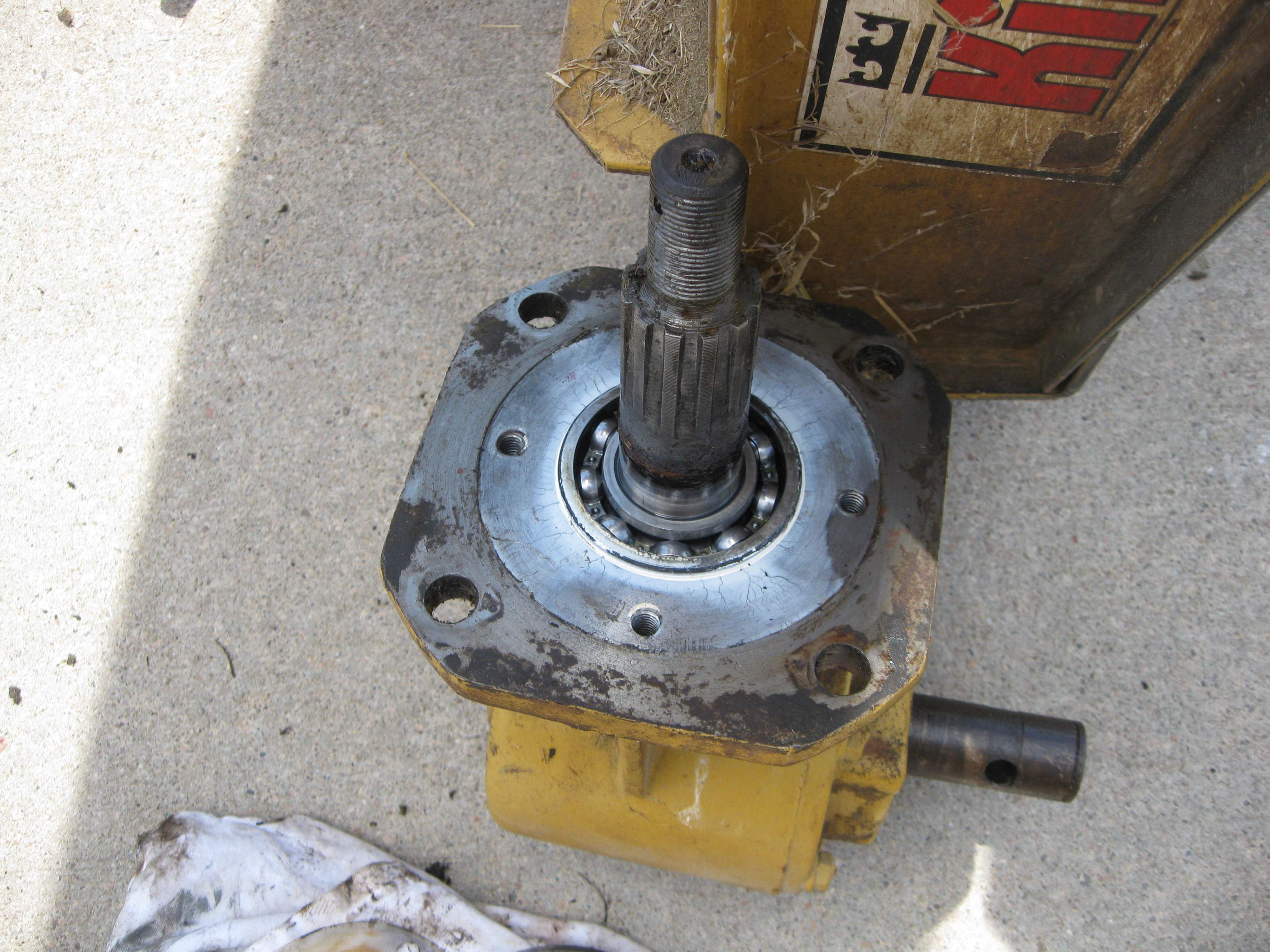

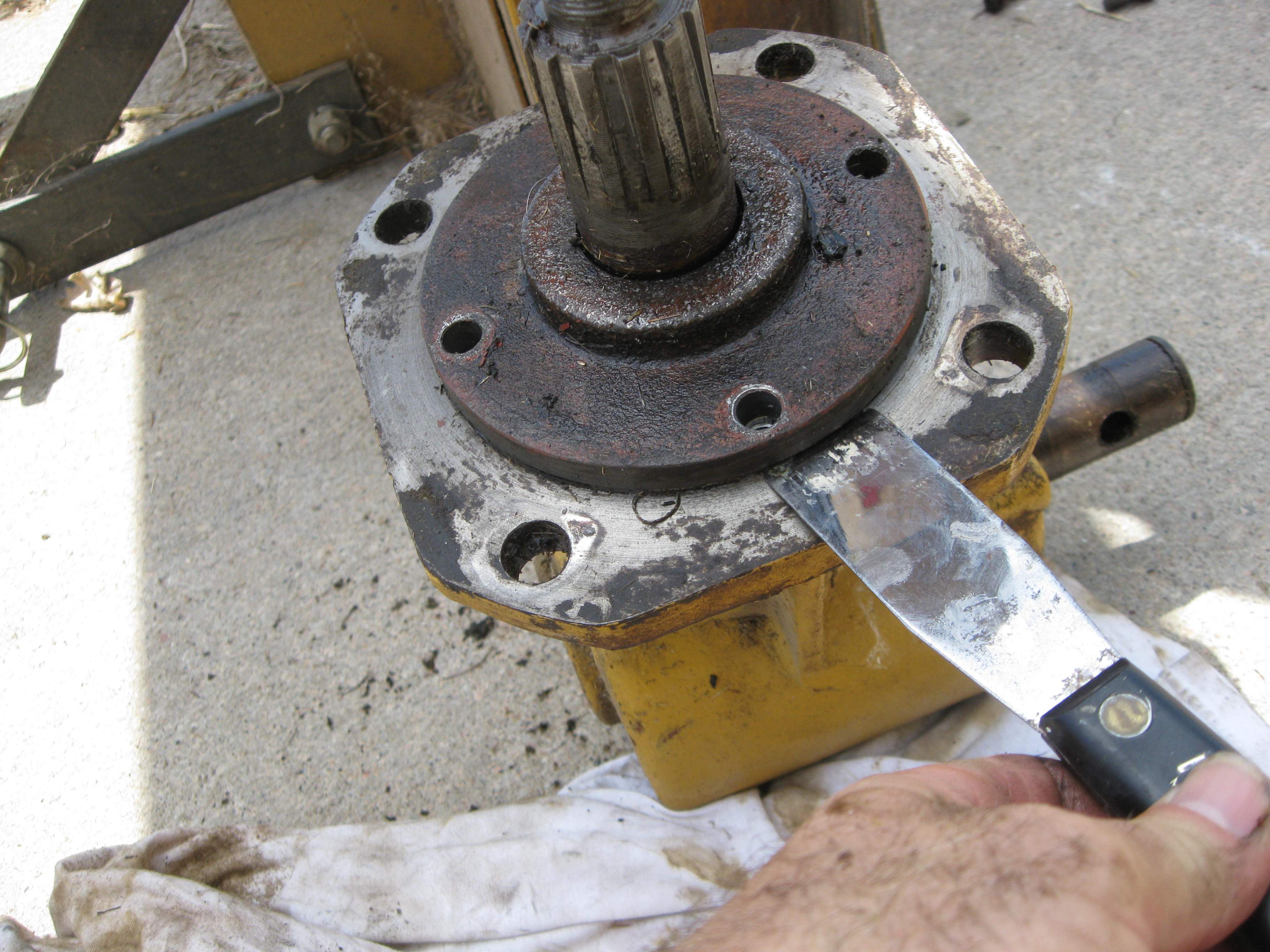

5) I then removed the four bolts holding the bottom cap on. This was fruitless because the bottom cap was stuck on.
6) Because step 5) failed, I removed the gear box.

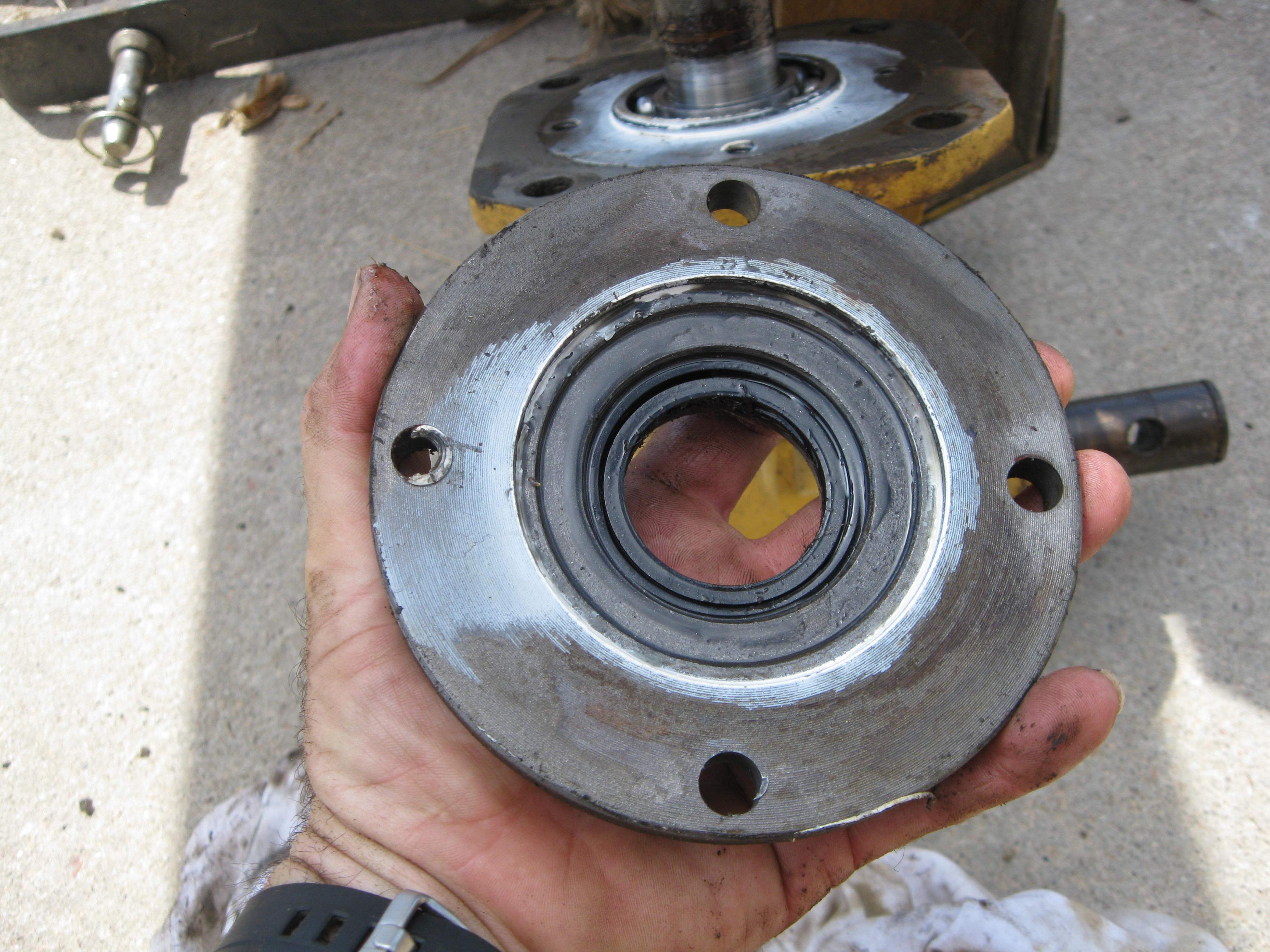

7) I used thin putty knife to remove the bottom cap from the gearbox.
8) Pried the seal out with a screwdriver.
9) After cleaning the surfaces, installed the new seal with a socket.
10) I did not know the required torques so I used universal torque values based on size and grade of the bolts.
For the four bolts holding the gear box on I used 100 ft-lbs. For the 4 bolts holding the bottom cap in place I used 30 ft-lbs.

You sure did better than I did. The bolts holding the gear box loosened up on my KK rotary mower, 10 years old, and I nor my mechanic couldn't get that dang stump jumper off with anything. Finally torched a hole in the stump jumper and tack welded the bolts after tightening.
