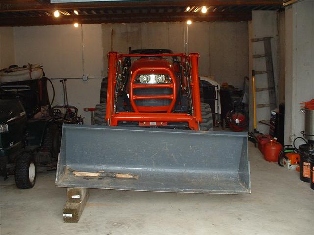

Bob, i was looking at your pic comparison, your bricks should be put flush with the outside of the loader and turned lenth wise , like those in the k120 pic, placed where they are is not the same comparison. I have the woods 1012 on my ck30 and ill try that as well on my tractor tomorrow...

albmn10 - you make a good point. Different width blocks, a placement closer to center of a few inches etc, can really give different results even on the same machine. This is interesting stuff though.
/ KL120 Loader Flexing #27
Yup that is a good point. The loader was on the edge of the block so it was not in contact with the full width of the, but it was probably 4 inches in from the edge. That could certainly account for only 1/2" deflection. Even so, I doubt it would have had the large amount of deflection that Steve had. I'm not home today so I can't redo the test for a couple days.

I had the blocks about halfway between where Steve's were and where Bob's were.
Tomorrow, I'll move them closer to the edge.
Not being a physics major, does it matter if the bucket is flat on the blocks or if the back of the bucket (rounded part) is supporting the weight? I had it flat.

Bob,
In the "twist test" photo you posted, the lever arm is different than the one Steve posted. His has the block at the very end of the bucket. Yours is about six inches from the edge. That would tend, relatively, to minimize the twisting forces. For this type of test it would seem critical to compare identical points (kinda like the old bucket lift capacity issue with different measurement points confusing the comparison).
I'll try this same test with my KL120 next chance I get (next week unfortunately). Subjectively I notice that if I snag a big root with the toothbar at the bucket edge and lift that the bucket certainly twists enough that I can see it. That is the opposite test to what you guys have been doing but should be about the same strain on the loader. I have checked my loader and I do not have any hairline cracks a la Highbeam. Mine has about 75hrs on it (largely loader work clearing brush).

Yes, we have already established that I need to do a retest, please read my prior post. I clearly stated that I needed to do that.
But also look at DonnyJ's post and his photo, he also did his test by having his chunk of wood about 4 to 5 inches in from the edge. (DonnyJ's photo shows his placed in a smiliar position as mine is placed). And also take a look at Dodgeram's post, he said he did his half way between mine and Steve's. He needs to do a retest too. And if he needs to retest, then so does Dargo, because Dargo does not have his all the way at the end either, his is in 3 to 4 inches from the edge.
shvl73 was the only one who apparently did the test correctly.
So there are a lot of us who need to do a retest. And from what I now see, we have no conclusions except that shvl73 probably did better in class at school because he can follow directions better than the rest of us /forums/images/graemlins/blush.gif /forums/images/graemlins/grin.gif

I have a 54" bucket on mine, not sure what you guys have but if its narrower that may make some difference as to where the block is placed. It's not a really defining scientific experiment anyhow but just a thought to keep in mine as well.

</font><font color="blue" class="small">( ...And if he needs to retest, then so does Dargo, because Dargo does not have his all the way at the end either, his is in 3 to 4 inches from the edge. )</font>
Liar, liar, pants on fire. /forums/images/graemlins/tongue.gif Mine is only about 1/2" from the side other than where the cutting edge protrudes wider than the bucket.

Steve,
Mine is also a 54" bucket. But there are actually a lot of variables. The width of the loader arms would also make a difference. For example if the loader arms are set wider apart then they are closer to the bucket corner and the twisting effect is likely to be less.
So perhaps there is no need for another retest by other brands, but perhaps it would be more useful for you if a few other folks with 120 loaders would 'accurately' duplicate your test to see if what you found is common with all the 120 loaders of if it is an issue with your loader.
