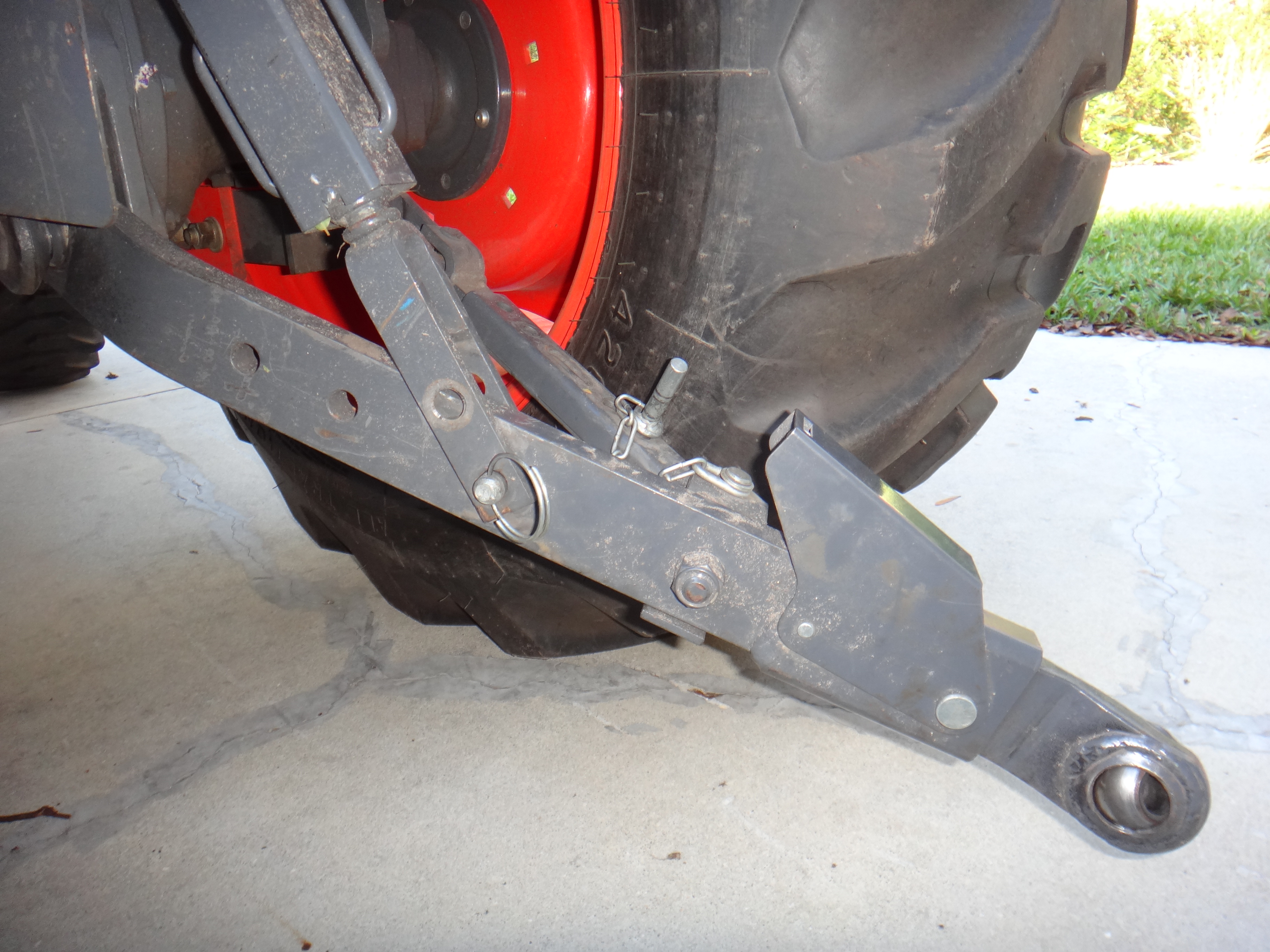

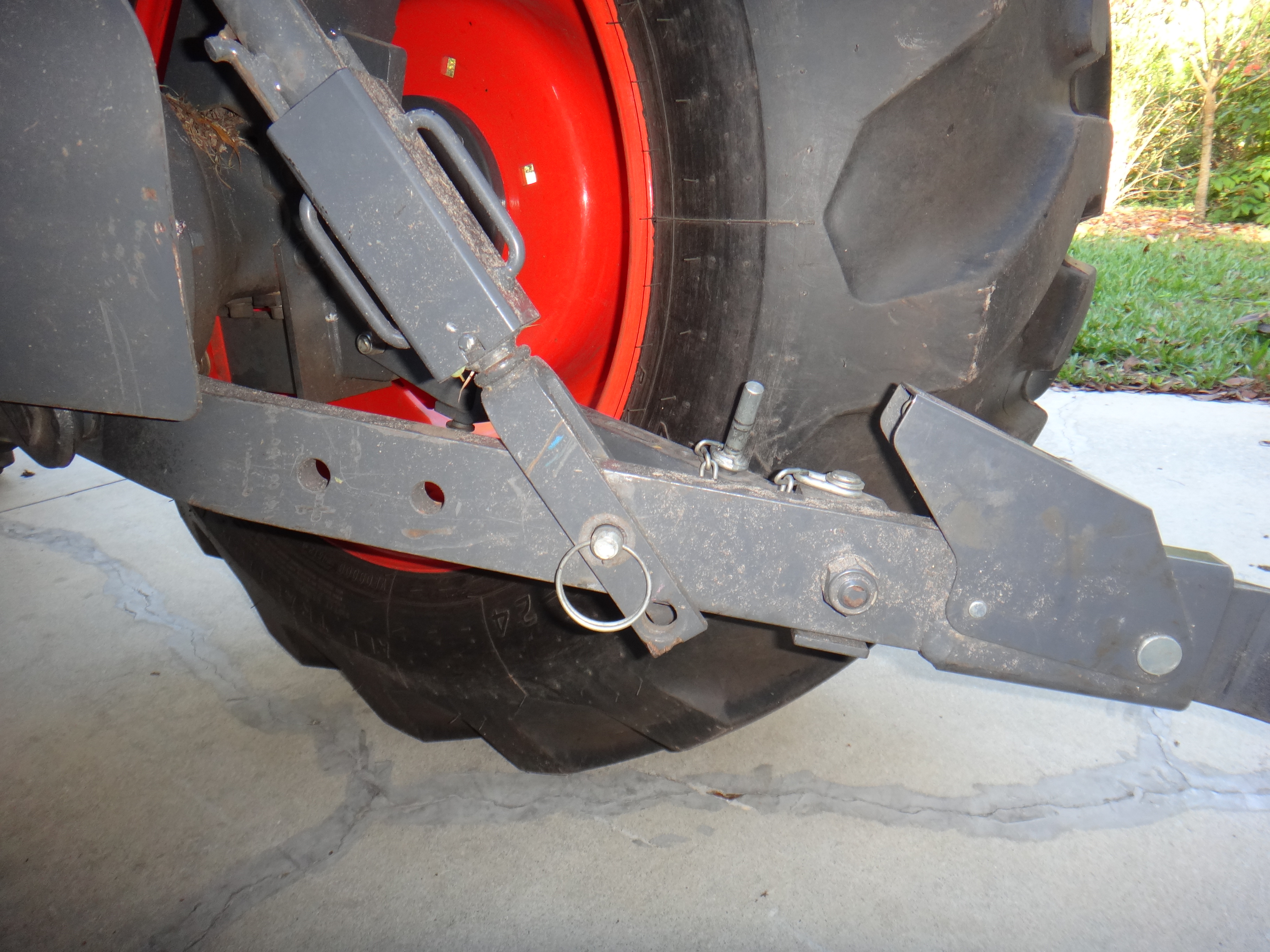

You set "dig" on a Subsoiler in GOOD condition by adjusting the Top Link.
Sometimes the Lifting Rod stirrups have to be moved to lower pair of holes to set implements lower.
