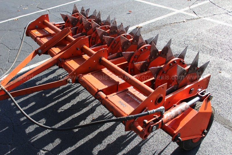

   / Knife shanks for Landpride box blade
#27
I have a small one of those, but no I need to slice thin furrows. I discovered my old Chraftsman garden tractor box blade in the junk pile. It has thin ripper teath, Need to dig it out and see if it will fit my new mower tractor. Might work. Ill get to this once the snow melts a bit.
