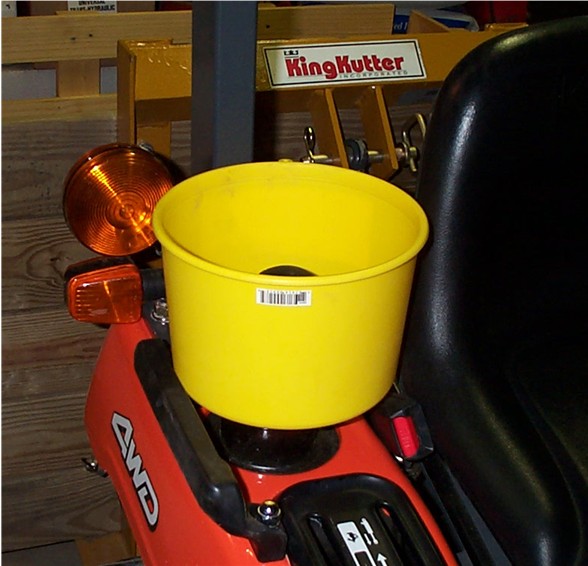

I use a funnel like rogue uses. It is called a "Mr Funnel" (comes on 3 sizes). It traps all of the water in a sump and prevents it from entering the tank. I was skeptical at first but I tested it and it blocked the water. Seems to be a good product. Mr Funnel
John
   / Knock, Knock... #15
Which size Mr. Funnel did you get?
Does it balance OK in the tank opening?

My funnel is the large (8.75 inch), standard model (bought it over a year ago). It fits the BX perfectly (see picture).
I did have an accident with it two weekends ago. I was dumping a 5 gal. can of diesel and an air pocket developed in the tank causing diesel fuel to belch over me and the tractor. My wife washed my jeans 4 times and they still smell like diesel. Caused me to wash the tractor and it looks like a new machine again!
