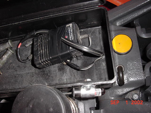

As far as pc on the 7500 : I looked in to it, saw the $ figure and moved on to other ideas. This is one idea I came up with. Using a laser pointer and some type of measuring gage on the implement.
