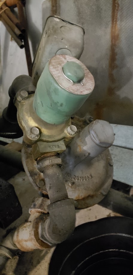

It does have a good size fuel feed line and regulator. It appears that it was hard plumbed in with 1" iron pipe. I have two 100# tanks.

If it's "hard" plumed with 1" iron, are you sure it was set for propane and not natural gas?

I really don't know, it could be natural gas. I hope it says somewhere on a regulator or carb.

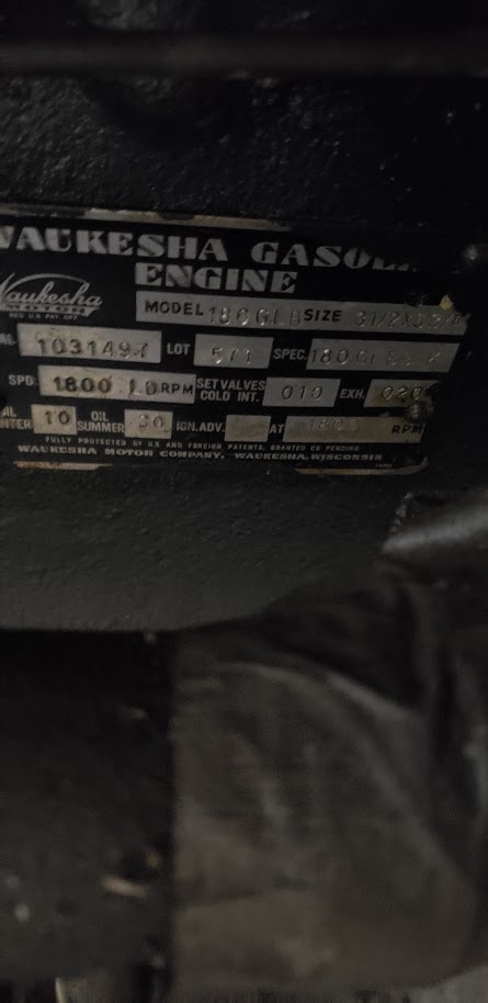

I don't know if the regulator size or design tells anyone with gas experience if its propane or N.G.
It's about 8" in diameter which may be just to match the plumbing size.
It doesn't say on the engine tag unless its coded into the model number or other tag information.
Kohler has a lot of information online that I need to pursue.
That may be 1/2" or3/4" black iron pipe not 1" ,by looking at the fitting on the fuel solenoid and comparing it to one on my fork truck.

Good morning , Just for your info for 60 hertz a 2 pole generator will need to rotate at 3600 RPMs , a 4 pole generator rotates at 1800 and a 6 pole is 1200 RPMs and so on

Well, no gasoline then 😵‍💫
The tag says 54.8 amps per term. If that's per terminal with two terminals at 240 volts that's 108 Amp max. So, this generator is basically a 100 Amp service.
Is that right?
I wouldn't go much past 80 percent of that.
I'll stick with propane. (y)

Sounds like a real find. The model and/or serial number may allow you to look up the answer to your fuel question. But propane is more likely than natural gas. In a given engine, gasoline makes more power than propane, propane makes more power than natural gas. But propane is very clean and stores very well.
It is correct that the number of poles on the rotor determines rpm. Rather than remember fiddly details like 60Hz is 120 reversals of current direction in a second, and there are 60 seconds in a minute, just remember 7200. 7200 divided by the number of poles gives you rpm; divided by rpm gives you the number of poles. In my 45 years as a Hydroelectric Operator, I did operate a couple of units with only 10 poles, small “house units” around 1.2 Megawatts. Going above 100 Megawatts, we had units with 48 poles that turned 150 rpm.
