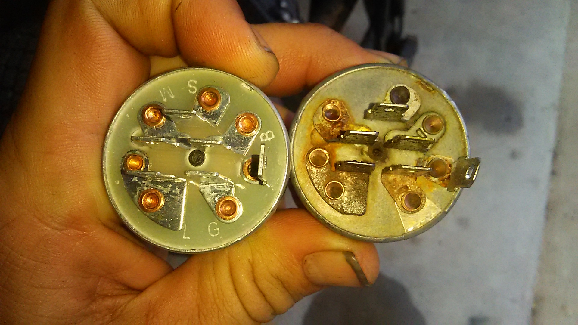

I went to a small engine shop for the ignition switch and got what we thought was the right switch, but I'll post some pics: there's a very minor difference in one of the tangs on the back of the switch. Not sure if that can be a culprit, or if my fuel solenoid itself has gone bad. Will get this figured out one way or another!

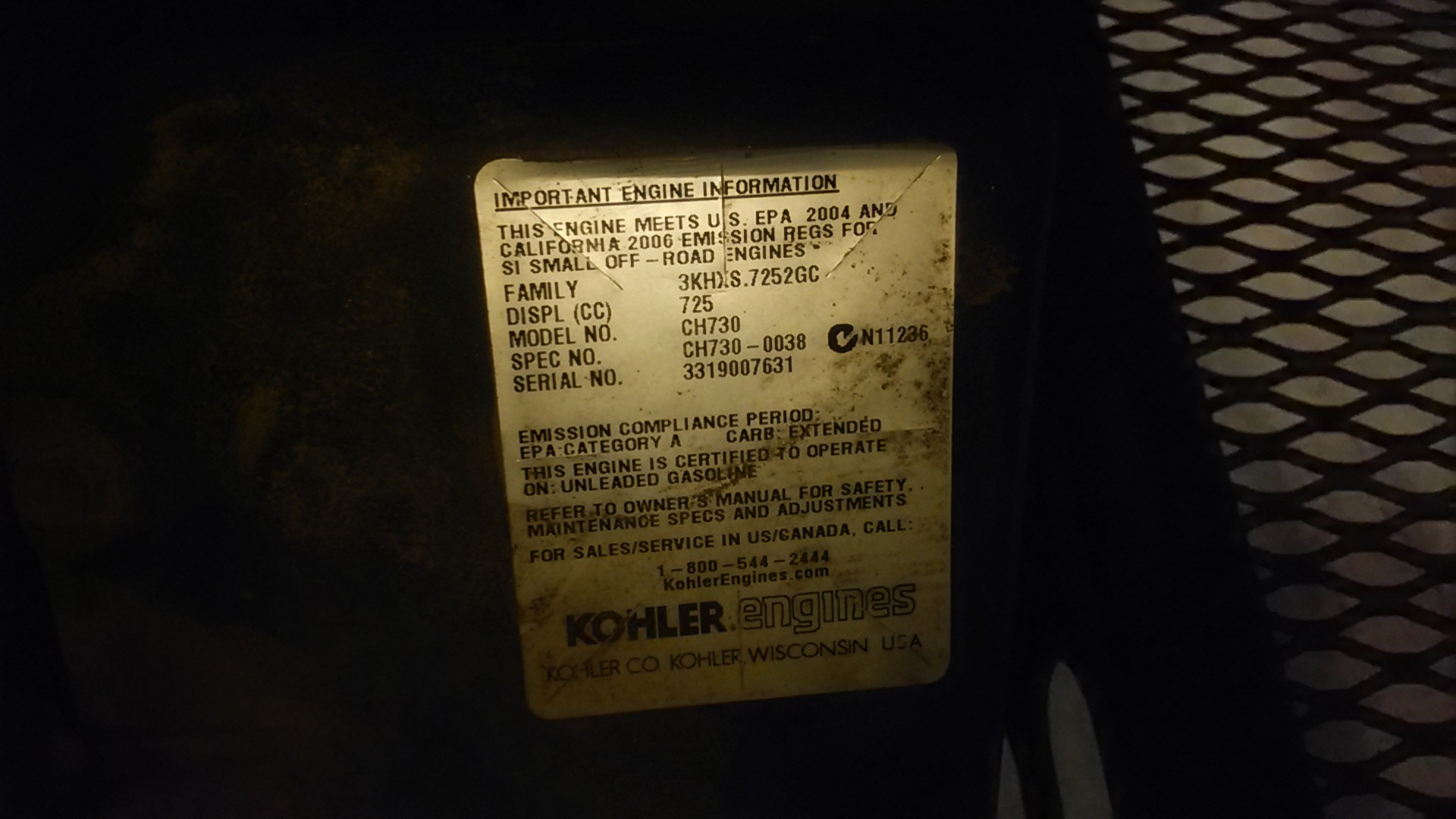

So I looked at the tag on my motor - it says CH730 - 0038. Now to search for the carb rebuild kit for that. DSC_0352.JPG

DSC_0350.JPGJudging by this picture, I also think my new ignition switch is a little off. The left switch is the new switch. Looking at the tab in the 5 o'clock position, it doesn't connect to the switch casing, as does the original on the right. I think this is a ground that enables the fuel shutoff solenoid to actually shut when I turn off the key. If I am right, I still need the correct switch, which I have not been able to find. No part numbers on the original switch, so it's been a scavenger hunt.
Check it with a multimeter. I bet that the "G" connection at 5:00 internally connects with the switch casing.

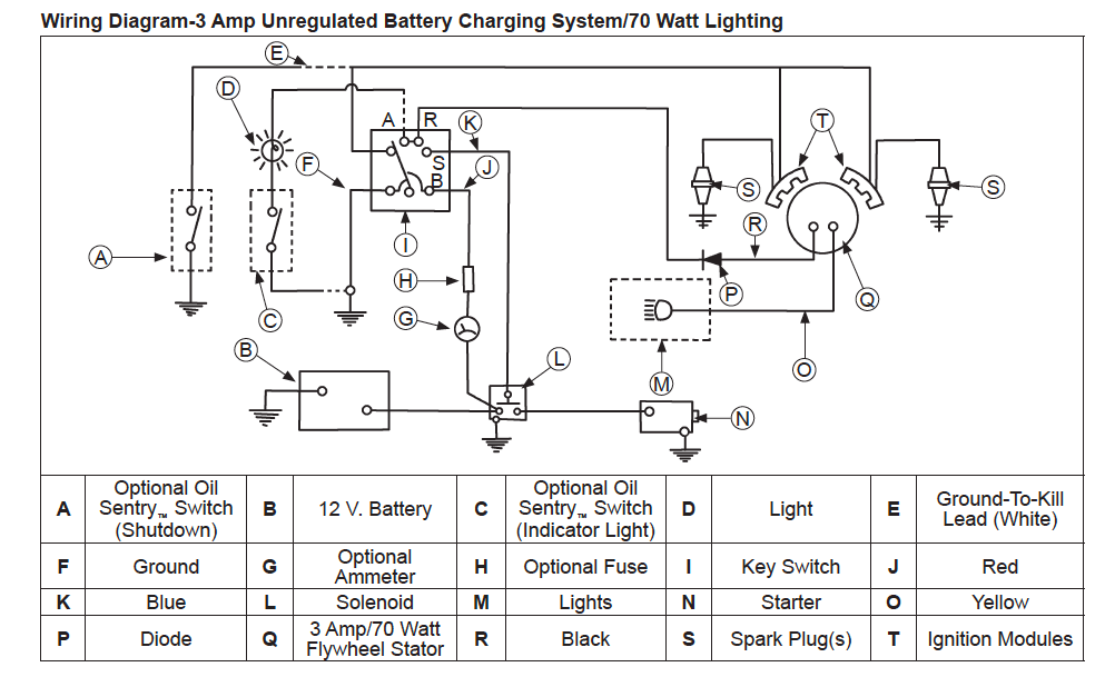

But it doesn't really matter, because the wire that connects to the "G" terminal IS the ground wire, so the keyswitch doesn't really have to ground directly to the frame of the tractor (but I bet it does).
The wire connecting to the "G" terminal is the wire identified as "F" in the diagram from page 41 of the Kohler service manual. The diagram below kind of sucks, as it doesn't show everything (for example, the fuel shutoff solenoid you are talking about is not shown, but it is connected by the same lead that grounds out the magnetos when the keyswitch is in off). A more complete (but more confusing diagram) is on page 35.
