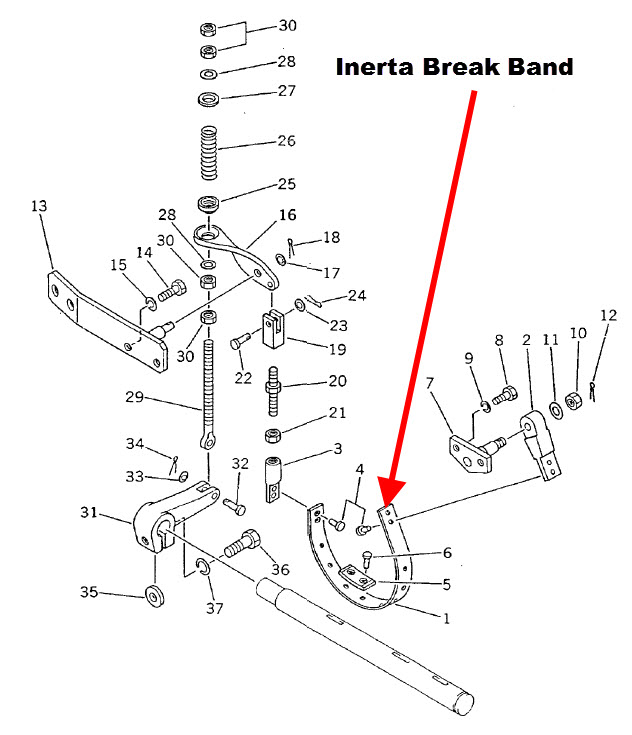

My thinking is that maybe the clutch linkage is not adjusted correctly AND the Inertia brake is not either. These two are connected on the same shaft and I am thinking that my first adjustment should be to the clutch pedal linkage and then the inertia brake. I am having the same thoughts on the steering clutches and brakes.

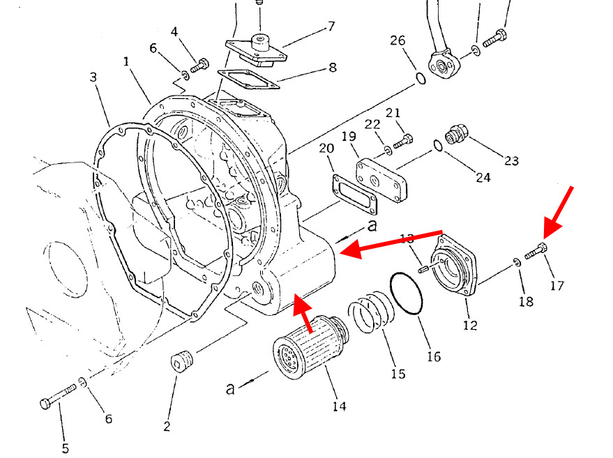

I had read on one of the forums about a screen that covers the pick-up tube for the clutch hydraulics but I don't know where the screen is located, how to access it, or if it even exists on my machine. The CD I have does not show it at all.???
I do plan to remove/rework the inertia brake band if necessary (meaning as last resort). My CD says the wear limit is 2.7mm. Just by looking at it, without measuring, it looked like it still had plenty of wear left, so I am hopeful that I can remove it, free the adjustment threads, and put it back, without pad replacement.
Inside the clutch bell housing is what Komatsu calls a "main clutch pump" This is a bit misleading in that pump actually provides the hydraulic fluid pressure to disengage the steering clutches when the steering levers are pulled. That pump does not operate the main clutch. There is a suction strainer located at the back of the clutch bell housing accessed by removing the lower skid plate, then removing 4 bolts and extracting the strainer. Drain the clutch fluid first!
The inertia break and adjustment is an integral part of the main clutch pedal, I can pretty much guarantee there is more than enough adjustment available to stop the main drive shaft. I suspect you have got to break free the threaded rod and all 4 nuts that are frozen up to get that band tighter so as to stop the main drive shaft when the clutch is depressed all the way.

Steering Clutch Pump strainer:
Inertia break:
