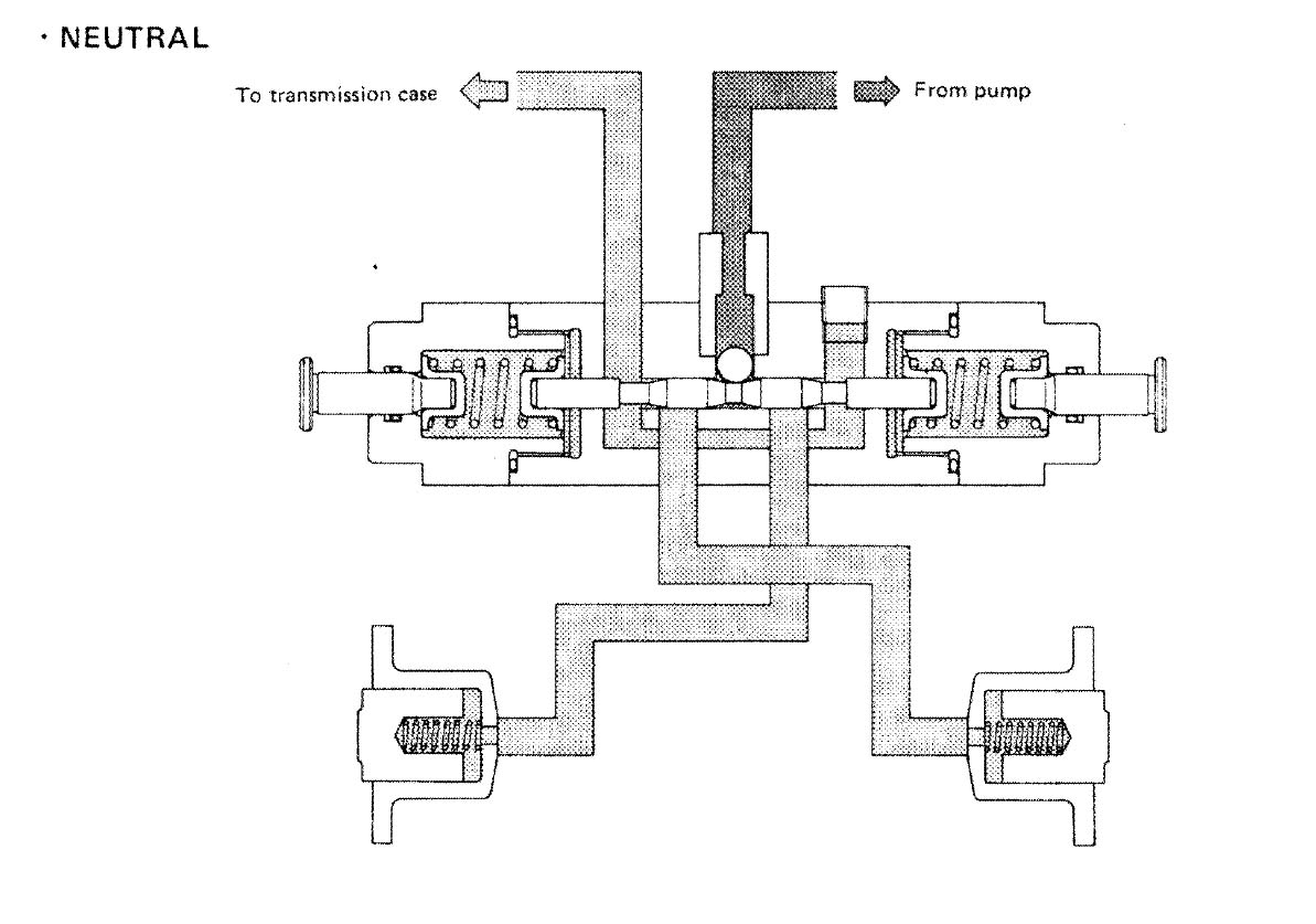

But, how does the oil return from the steering valve to the clutch pump?
It is an open loop system, meaning there is no return except back the way it came. The "Main Clutch" pump inside the clutch bell housing has a built in pressure relief valve. When the steering levers are pulled back a valve opens allowing pressure against a large Cup piston that pushes a yolk releasing the steering clutch. When the Steering lever is returned to normal, the springs on the steering clutch push the fluid back through the piston.
I am a bit confused. I was looking at my CD and I saw the attached diagram that shows a connection from the steering valve to the "transmission case". Is this a mistake in labeling/terms or is this some sort of bypass/dump from the steering control valve to the transmission case??
It is beginning to look like there could be an issue with the steering control valve leaking/bypassing fluid??

Today I drained the excess oil from the rear transmission. I am not sure how much it is supposed to hold but I drained out about 1 1/2 gallons. The oil that came out was darkened but had no signs of water in it. There were some metal particles but none were any size, more like fine glitter.:eek: Is this a major cause for concern or is this to be expected for a dozer?
I also removed the drain plugs under both clutches while I was under the dozer. There was no oil to come out but there was a cup or so of water in each side.:shocked: Also, both drain plugs had a hole through them which was plugged with dirt and crud. I assume this was done by the previous owner to let out the water. So, I cleared both holes. There was a foreign object in the LH clutch housing. It felt like a flat piece, maybe a brake pad?? Not sure what it is. I plan to use a smart phone endoscope to try to get a look at it and the brake.
I refilled the transmission to the lower mark on the dipstick. As best I could tell, it had about 2 qts. excess which roughly equals the amount I had added to the main clutch reservoir. This may have just been a coincidence. I really don't know because the transmission was overfull from the beginning. However, I will keep a close watch on the fluid levels and see if the transmission fills up more as the main clutch goes down. If so, I think it safe to say there is cross leakage somewhere, probably through the steering control valve.
I also looked at the steering valve under the seat and there is definitely some leakage to the outside there. How much trouble/cost is involve in repair of the steering control valve?
