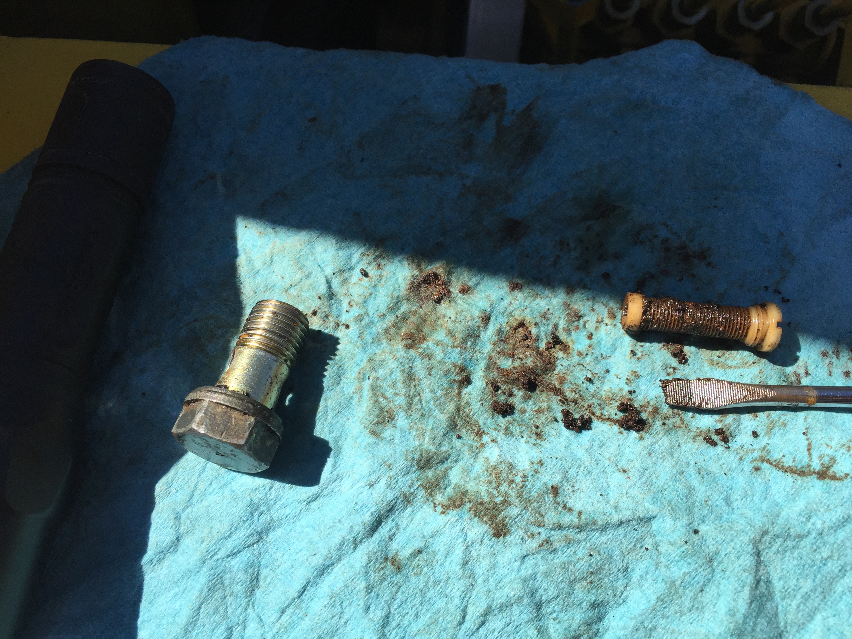

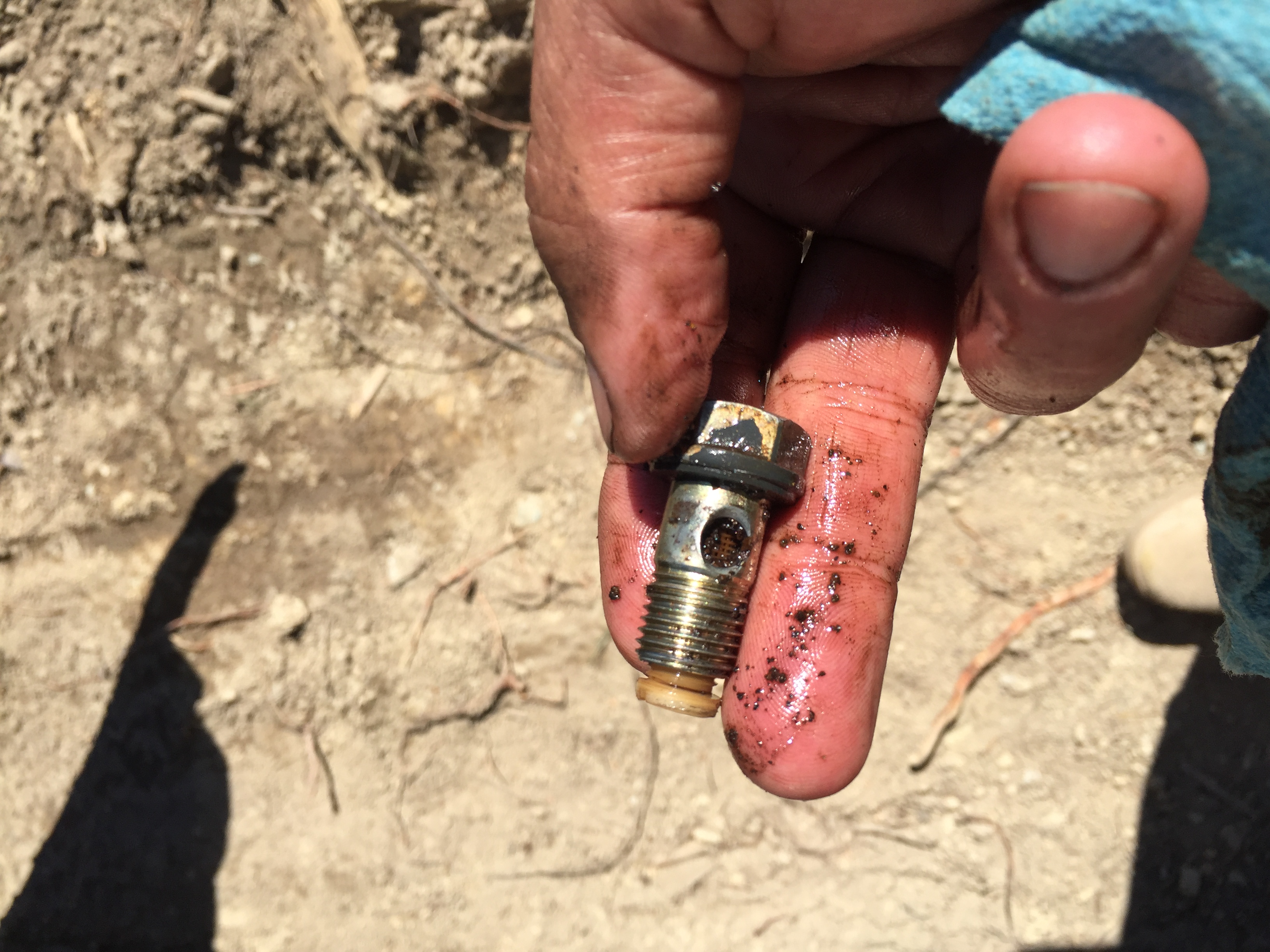

I did a google search and put "Komatsu PC130 priming pump" and came across this
The fuel transfer pump has a strainer in the banjo bolt that connects that tank hose to the pump. The bolt is on the bottom of the pump and if your machine has air conditioning it is very difficult to get at and get out. Once you get the bolt out look at the end of it and you should see the white plastic with a screw driver slot in it. Unscrew the strainer from the bolt and blow it and the hollow in the bolt out with air pressure. There are two seals for the fitting and most people loose the one that goes next to the pump. You can get copper fuel line washers from the local auto parts supplier to work if you loose the originals.

EddieWalker, you are a wonderful human being. It was the Banjo Bolt strainer. As soon as I got it loose and started to unscrew it, my hand was filled with gritty crud and I knew it was going to work. I took out the screen, which did not want to budge because of all the grit, cleaned the banjo bolt, screen and the elbow that attaches to it with carb cleaner. I then blew out the hole the bolt goes into, with compressed air. put it all back together, primed it, and started up Let it idle for almost 4 minutes then reved it up and started digging. Took out a big stump then started moving so small logs....when 10 minutes had passed, I went after a large oak tree top. I ran it for an hour then stopeed to fuel up again. IT ran well all day....I stopped working at 8:15 when I could not longer see. I did notice that the inline filter is already dark and has grit in the bottom of it. I will swap that out tomorrow and start looking for a better filter....one with a valve in the bottom of it.
